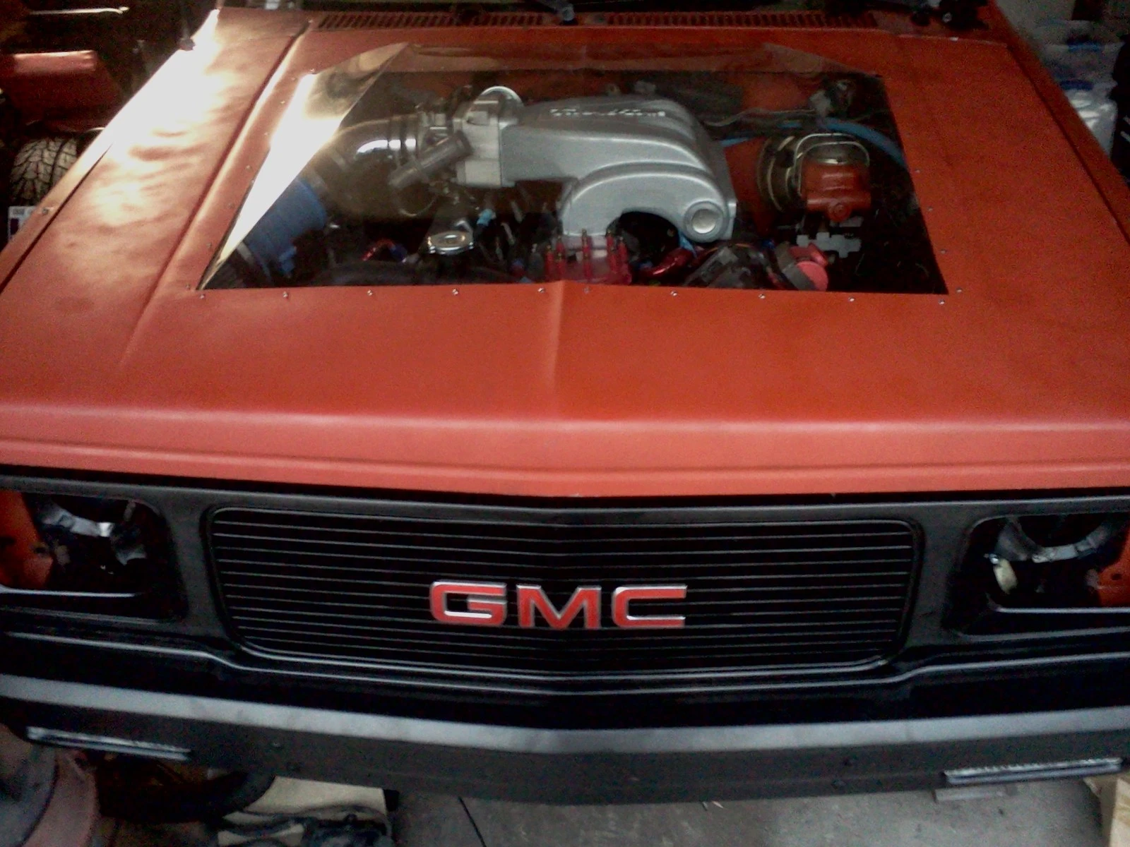

following is a good ref for your conversion. im hoping to start 85 s10 chevy blazer with a windsor 427sbFord v8 conversion in another couple of weeks. this is real not photoshopped. its backed by an nv4500 5speed with a 84 F150 top loader bellhousing conversion. motor is a coast dominator kit 10.6 cr afr225 heads trick flow r intake 42#inj .592 lift 252 dur and 112 lobe sep running A9l box and anderson piggyback ecu 80mmprom and 75 tb-looking for 600hp on pump gas no boost or nos.

Now that's certainly something you don't see everyday! :cheers: I've seen buttloads of people put chevy engines in Mustangs, but very rarely do I see a blue oval powerplant in a bowtie!
Nice setup btw-I just pulled the S-trimmed 5.0 out of my '84 today...kinda bittersweet moment. I bet that truck is pretty mean
