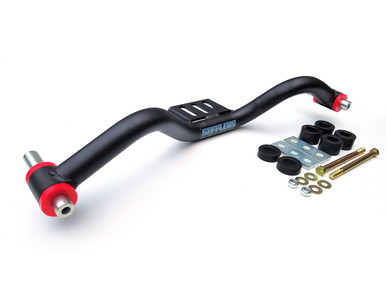

If it was me I would piece it all together but I like that part as much as doing the swap. Whatever anyone says be sure to get a Stifflers transmission crossmember.
