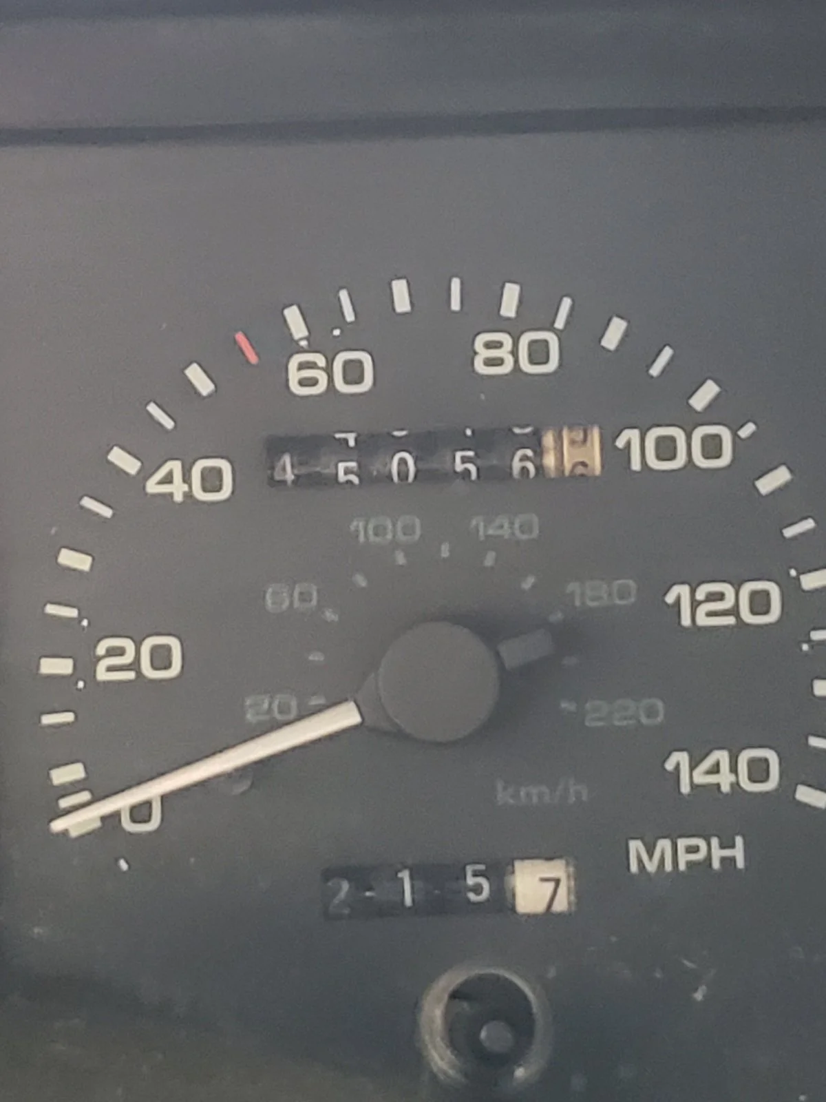

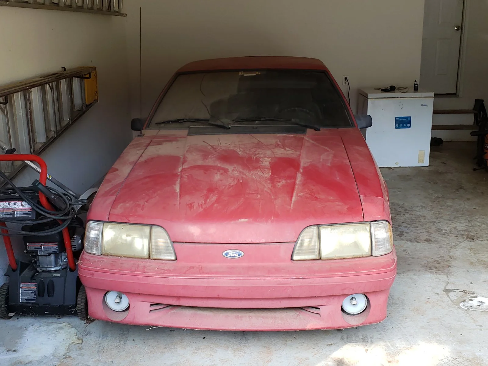

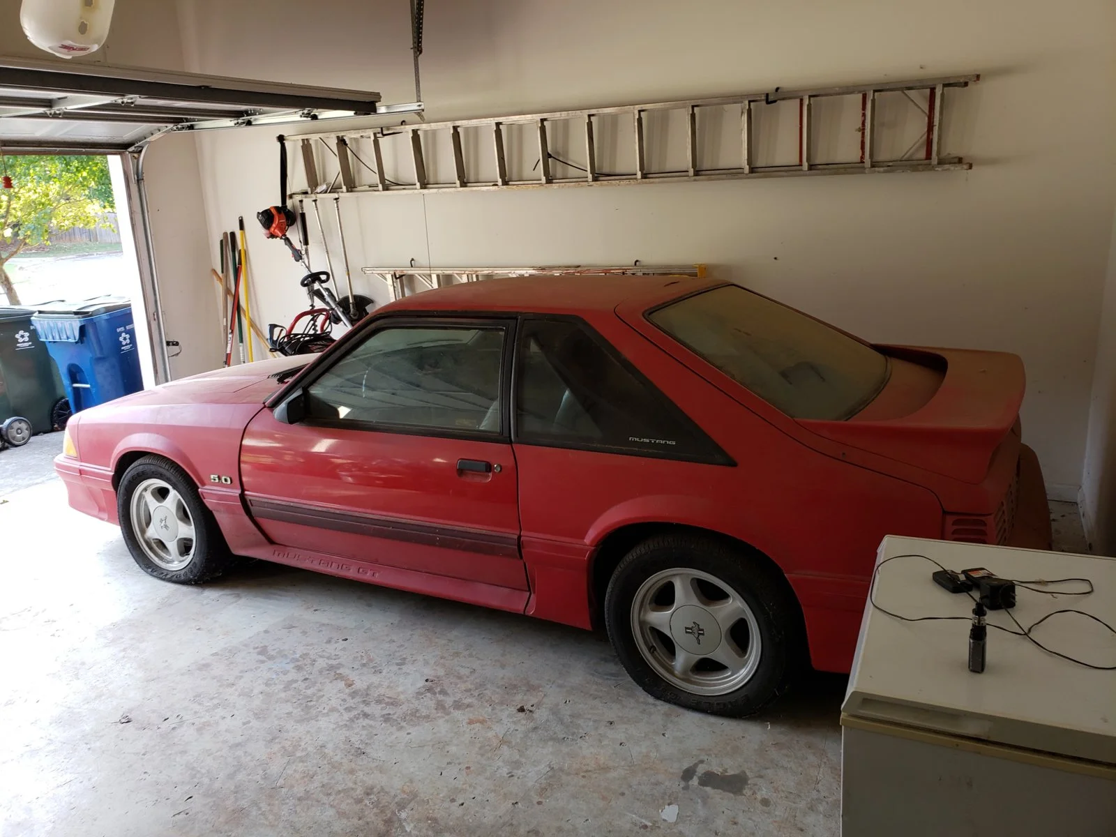

WOW - I am ecstatic! That's fantastic, thanks!!!! That's exactly what I was looking for! It has 145k miles on it. I'll work on those things over this month and get back to you - I'm sure I'll get stuck somewhere - thank you for offering to help as we are neighbors. This is really great - I very much miss driving this car (older and sentimental I guess, lol). PS - everything in the car is all original, except the accident damage repairs to the hatchback, resend. It is has been down south (NC, GA) since I bought it - never kept in Michigan, so rust shouldn't be an issue.
