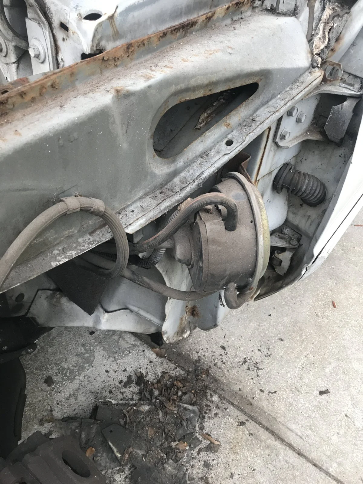

jrichker StangNet's favorite TOOL In Remembrance. Thank you for your contributions Mar 10, 2000 27,512 2,813 234 Dublin GA Jul 2, 2018 #2 Jul 2, 2018 #2 If that is the driver's side of the car, that is the cruse control vacuum servo. It has a cable that works the throttle.

General karthief wonder how much it would cost to ship you a pair Mod Dude Aug 25, 2016 28,029 10,653 213 polk county florida Jul 2, 2018 #3 Jul 2, 2018 #3 That is a prius sensing device, when a prius parks on the drivers side of a mustang it emits a loud giggling noise. No, really! i'm serious! Reactions: 7991LXnSHO

Boostedpimp 20+ Year Stangneter May 8, 2003 1,451 493 154 NJ Jul 3, 2018 #4 Jul 3, 2018 #4 cruise control servo like mentioned above
Ajr3268 New Member Feb 13, 2017 11 0 1 Tampa, FL Jul 3, 2018 #5 Jul 3, 2018 #5 jrichker said: If that is the driver's side of the car, that is the cruse control vacuum servo. It has a cable that works the throttle. Click to expand... Can I just remove it like delete it ? I don’t have cruise control anyways
Mustang5L5 That is…until I whipped out my Bissell Mod Dude Feb 18, 2001 43,311 18,025 224 Massachusetts Jul 3, 2018 #6 Jul 3, 2018 #6 Ajr3268 said: Can I just remove it like delete it ? I don’t have cruise control anyways Click to expand... Well if you have that servo, then the car does have cruise control. But yes, you can delete it just cap the vacuum line at the source
