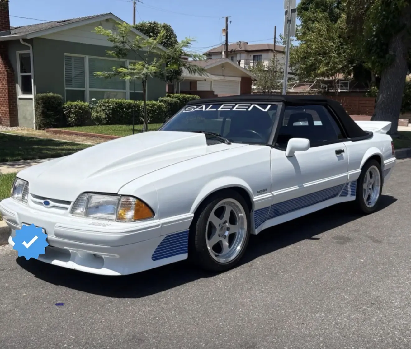

New here, on my 4th Fox since high school but it’s been a while…
Looking to add a supercharger to my newly purchased 1990 Saleen vert (sod) wondering what all besides the SC kit needs to be purchased? (Reccomendations on what brand / style works best) what else needs to be upgraded to handle the air / hp increase?
Throttle body upgrade? Injectors? Fuel Pump upgrade? Chip? gauges? Please help….
Thx

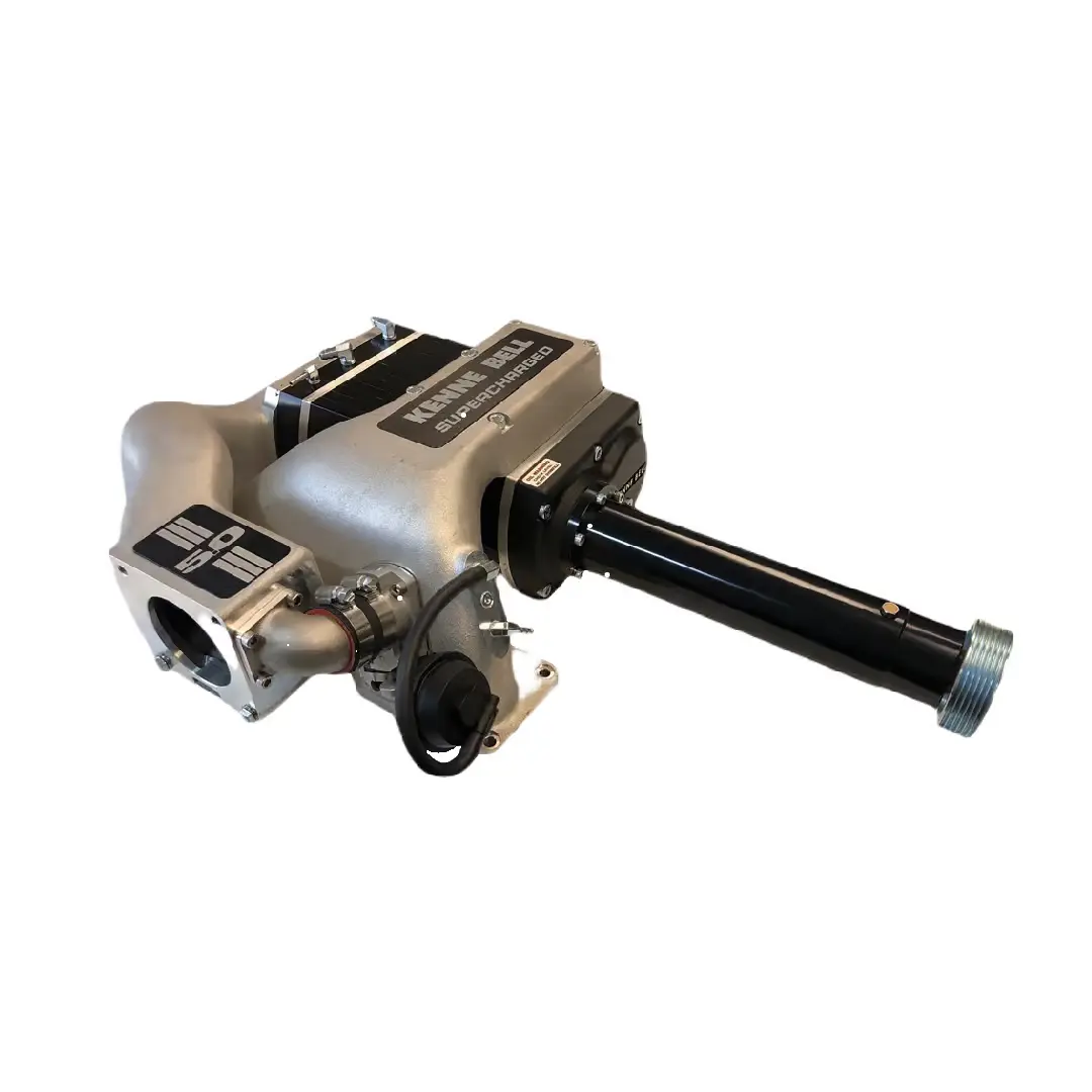

You need:
A GT-40 lower plenum
75-80 mm Accufab Throttle Body
60 lb injectors
Walbro 255L HP Fuel Pump
Anderson Ford Motorsports N/A Power Pipe
Aftermarket MAF
Tune (however you decide to approach this)
Full length subframe connectors if you don't already have this.
This supercharger is good [all over] and not just at the top. Boost = Right Freakin' Meow

And if that is a real Saleen (and I have no reason to doubt that it is) then it is the easiest to install and remove in that all of your other parts can stay the way they are.
New gears are not required. The T5 is fine so long as you stick to street tires and are mindful of the weaknesses of third gear. Just [roll] on the throttle and everything will be fine. Smash that gas pedal like you don't care and the rear will quickly make the move to come and meet the front.
It's about the best street blower for a mild Windsor there is IMO.
On my combo, I made 460/480 at the wheels. Now, that is [not] what you are going to get when you slap this onto a stock engine.
What you [are] going to get is about a 60-80% bump in HP, a 70-90% bump in torque (depending on boost) and torque curve as flat as a table top over the entire useable RPM range.
With your car, I would love it and leave it. Because you're going to want to mod suspension and weak links after that... Not sure I'd do all of that to a Saleen.
This setup will give you butterflies when you go to drive it. Part from excitement and the rest from the realization that it is now actively trying to kill you. :coff:
