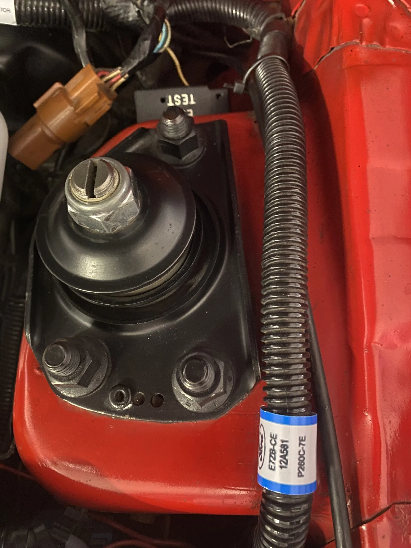

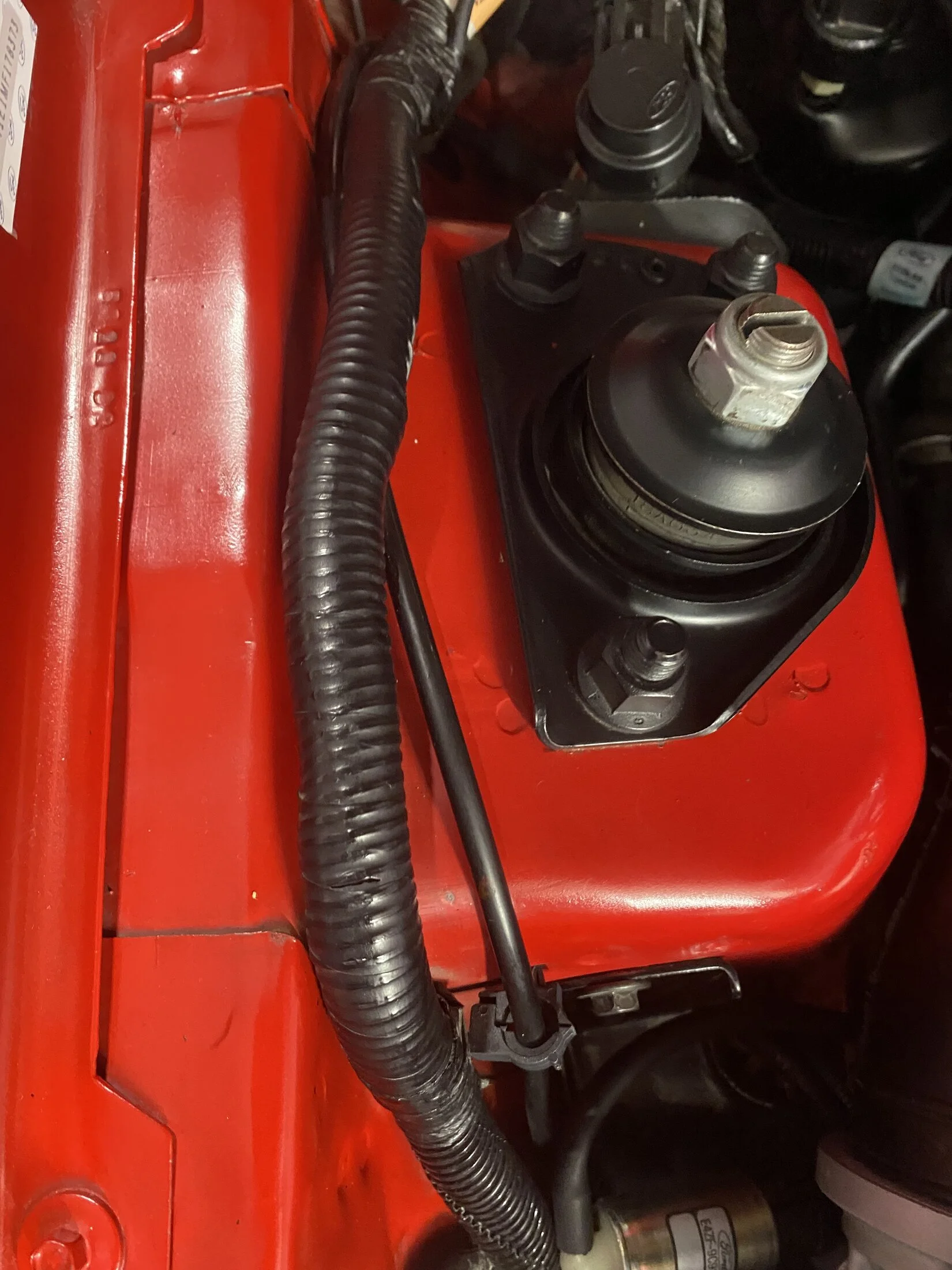

Engine 1991 Fox body runs like crap with hood closed
There is a fat wire harness that goes over each strut tower. Perhaps your hood is disturbing one of those harnesses and causing an electrical issue? Maybe shake, wiggle, and push down each harness while running and the hood open and see if anything becomes ovious?
Also lower the hood slow with engine running as you peek underneath and see if it’s hitting anything. Maybe touching the battery terminal(s)?
This might sound dumb but if you have an aftermarket alarm with one of those switches that reads the hood open/closed maybe check that switch if it’s faulty and causing an issue.
