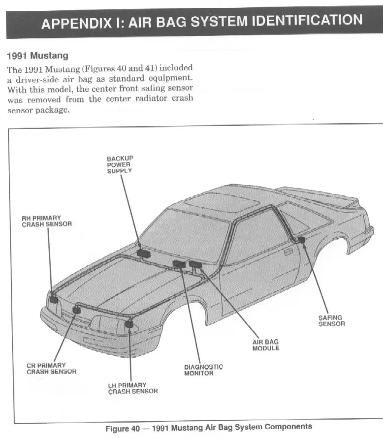

Just a heads up, there is also a safing sensor in the B pillar driver side.
Excerpt from http://www.veryuseful.com/mustang/tech/airBag/airBag92.html:
The primary sensors measure the crash severity while the safing sensor confirms the crash and is used to prevent inadvertent deployments possibly caused by a malfunction in the primary crash sensor circuits or crash sensors.

I can assure you that the safing sensor is not in the B pillar on my 1992. It's a convertible and has no B pillar!
The "backup power supply" on my 1992 is inside the diagnostic monitor, not a separate unit as shown. I believe the safing sensor is in the A pillar somewhere, not sure if that's just a convertible thing or if it is a 1992 thing.

Looking at @AeroCoupe 's diagram, it looks like the safing sensor is actually in the rear quarter panel near the driver's door jamb, not actually in the B-pillar itself. That certainly doesn't mean yours is not where you believe it is in your car though.... could very well be a hard top-vs-vert thing, or a different-year thing, like you mentioned.

Googled that up and from what I can tell even the drop tops have them in that location.
