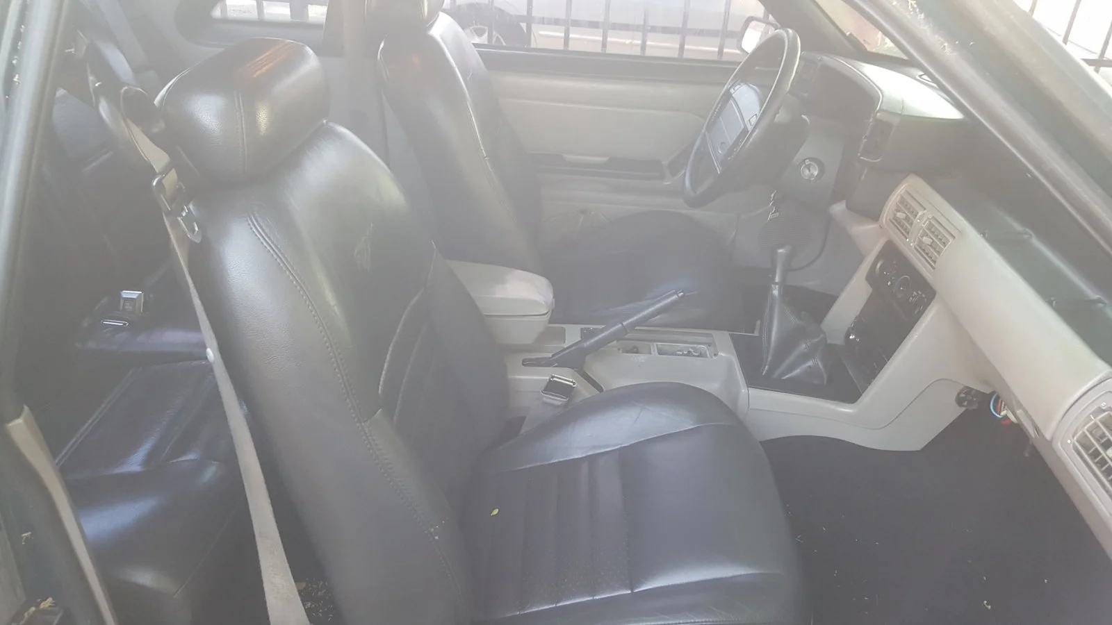

9 92foxhatch New Member Aug 5, 2018 3 0 1 california Aug 5, 2018 #1 Aug 5, 2018 #1 hi i just bought my first mustang, its a 92 foxbody hatch and i noticed when the car is on the air bag light comes on and blinks ones in a while on the dash ....any ideas on what it could be ? Attachments 20180803_183253.webp 54.3 KB · Views: 489 20180803_183253.webp 54.3 KB · Views: 333
mikestang63 SN Certified Technician Aug 27, 2012 11,606 8,859 214 In the garage Aug 5, 2018 #2 Aug 5, 2018 #2 could be a number of things airbag sensors bad on the front rad support airbag relay box bad under the dash blown fuse short in the wiring bad clockspring airbag bad first thing to do is run the codes and compare them to this list http://www.veryuseful.com/mustang/tech/airBag/airBag90-91.html Your airbag is most likely not going to deploy in the event of a crash if the light is blinking
9 92foxhatch New Member Aug 5, 2018 3 0 1 california Aug 5, 2018 #3 Aug 5, 2018 #3 mikestang63 said: could be a number of things airbag sensors bad on the front rad support airbag relay box bad under the dash blown fuse short in the wiring bad clockspring airbag bad first thing to do is run the codes and compare them to this list http://www.veryuseful.com/mustang/tech/airBag/airBag90-91.html Your airbag is most likely not going to deploy in the event of a crash if the light is blinking Click to expand... thanks bro appreciate! ill start off with the simple stuff
