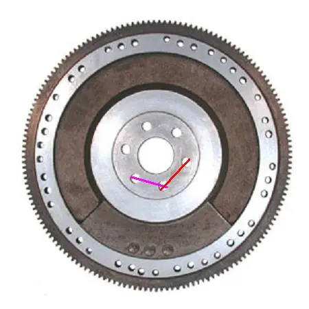

Now that I am thinking of it, the holes on the flywheel are evenly spaced. It's the holes on the crank that aren't. I believe there are more holes on the crankshaft than that of the flywheel..thus allowing you to only mount the flywheel one way. I assume you didn't have the problem before thus making your issue be the clutch or flywheel. Now determining which one may be a pain unless you have another clutch or flywheel to swap out. Unless the part numbers are incorrect for your new parts.
mustangrog1979 said:
I see what your saying. The crankshaft does have 7 holes instead of 6. But which way do point the counter weight?
You don't point the counter weight any way. When you line the holes of the flywheel up with that of the crankshaft (again only one way) that's it.
Is this a stock motor?
The flyweel is "keyed" to be installed in only one way. It is not clockable.
The distance center to center of these two holes is different.
