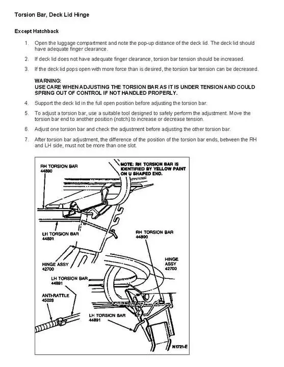

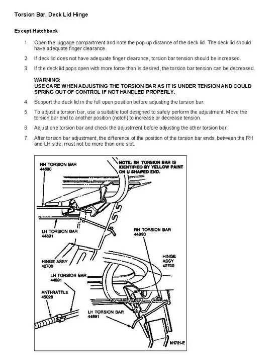

theres two bars that connect both sides of the arms, there are a couple of holes that they hook up to. They prob have prob popped out of there.
+1 Or they just need adjusting.
Move the ends of the torsion bars up a notch to increase the force needed to lift the deck lid. According to the Ford Mustang Service Manual, to get a balance between the force needed to hold the deck lid up and too much force throwing the lid open too hard, you can have the two torsion bars in different positions. However there should be no more than one notch difference between them.
Wear some thick, leather work gloves and eye protection when adjusting these torsion bars. There's lots of potential for gouged skin and bits of flying metal when doing this.
I put a fiberglass decklid on my coupe about 2 months ago,and i had to adjust the torsion bars all the way down to the wheel wells in the trunk with some padding below them.But there outta the way for any one to see them.And with a wing on there,unless its a saleen wing (the huge one) you should be able to adjust them up so it will pop open.
how exactly do you adjust the torsion bars???
One of them is connected on both sides and has both ends pointing toward the rear of the car.
the other one has come unconnected on one side of the trunk. one end is pointed to the rear of the car and the other toward the front of the car. I can not figure out how to get this one back in to place (Am I missing something really stupid here)
Hope it helps.
