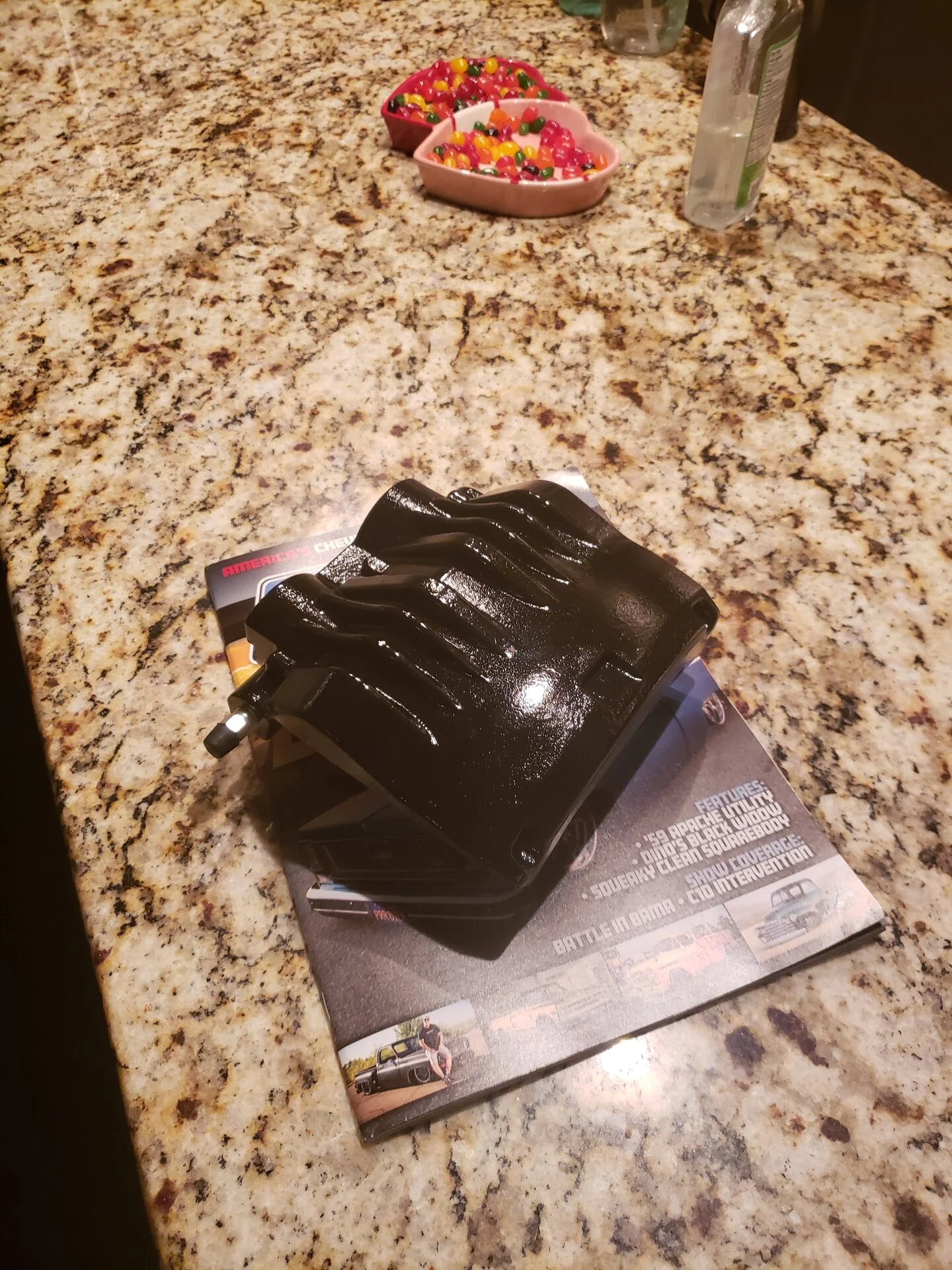

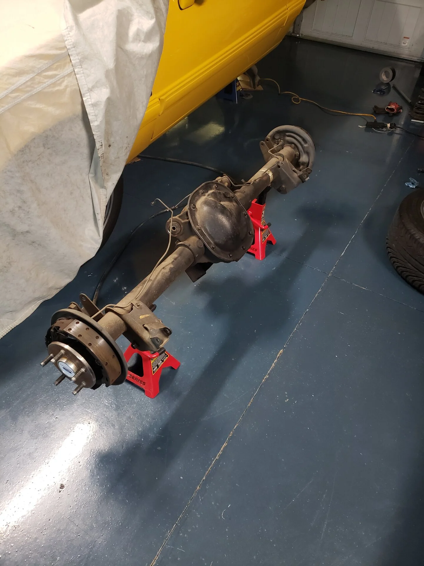

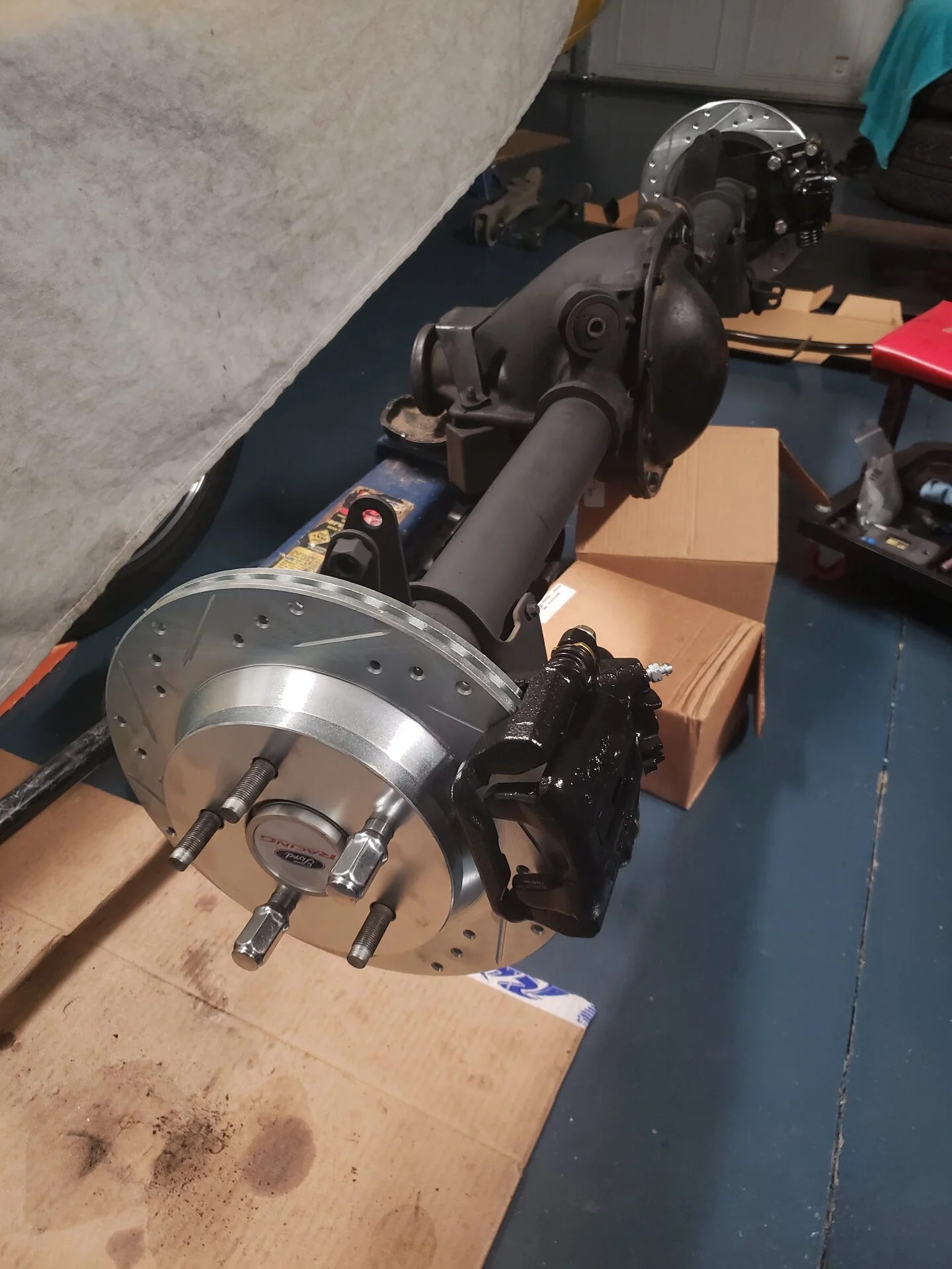

Ended up doing things just a little different.. didn't do the big brake kit from NRC.. picked up some 99-04 cobra calipers up front, NRC brackets for rear..
still have the 93MC and 93 Booster (well reman from RockAuto), wilwood PV. R1 had a decent price on slotted/drilled rotors/pads.
waiting on some pieces that are back ordered currently to finish up the brakes.

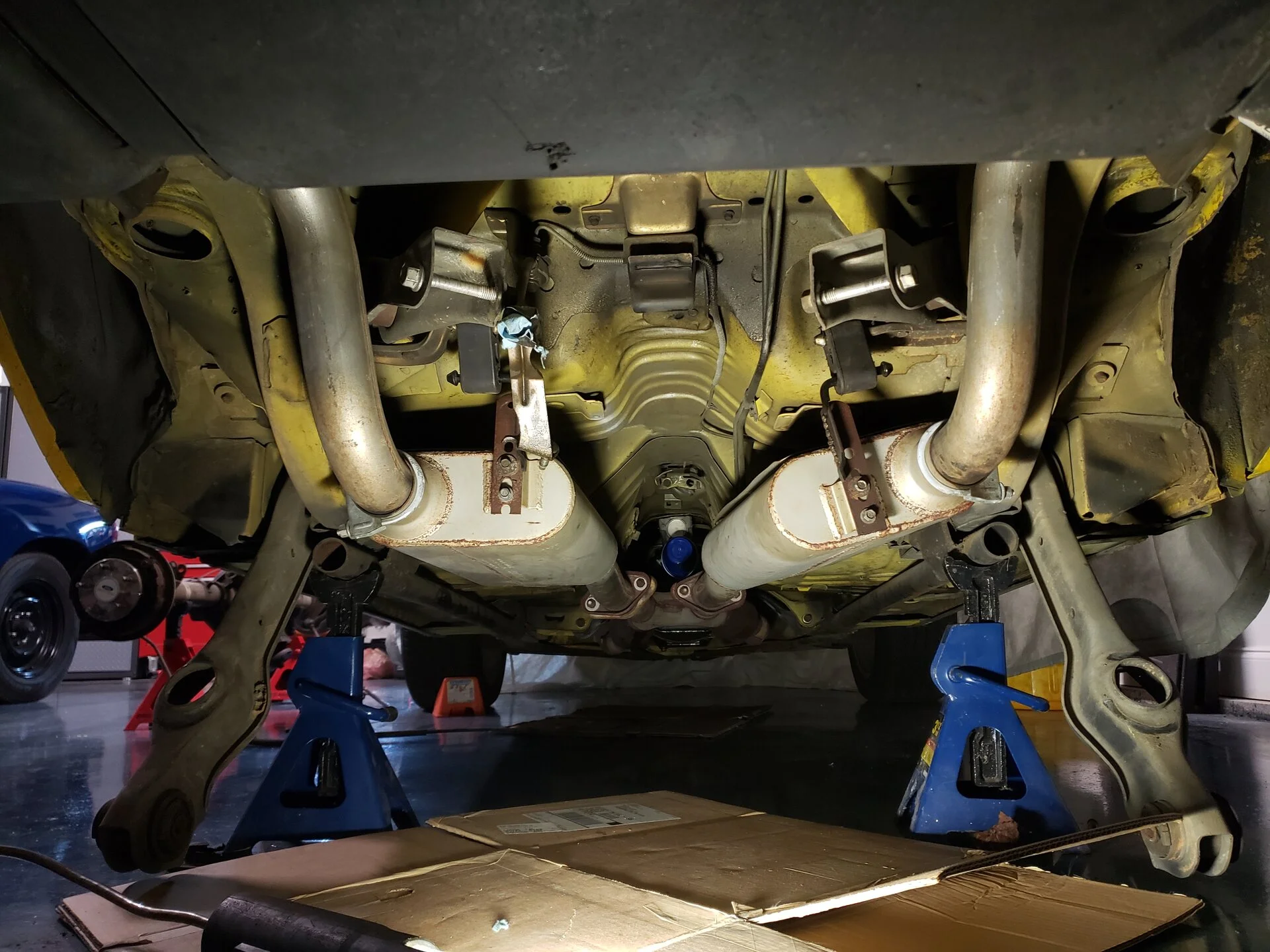

suspension work will be next while it's up in the air
bilstein's at all 4 corners
MM LCAs
MM Panhard bar
new upper LCA diff bushings (the ones in the arms are actually ok.. will probably just brace them for added stiffness)
2 pt k-member brace
strut tower brace
MM Front Grip package..
