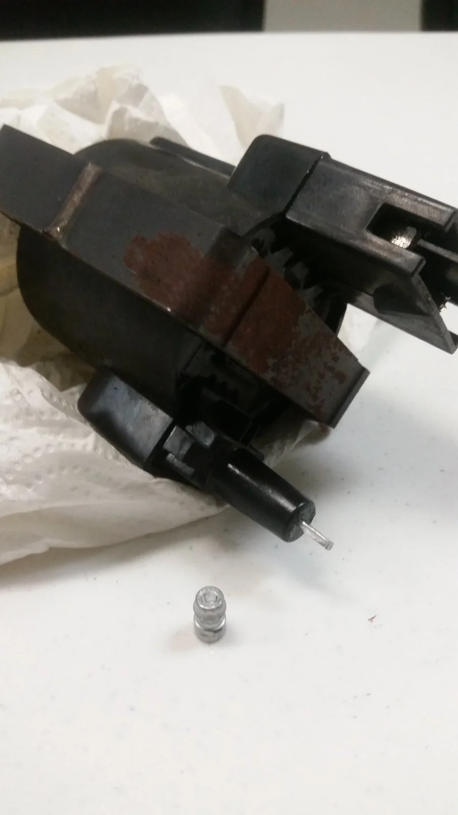

Been going thru similar with my car. Last year I found the post on the coil came off. Apparently it wasn't making good contact intermittently. Took me forever to find it. So I put a new coil on. Not even a year later same problem. Found this Wednesday.
I had already changed the distributor thinking it was the PIP. Been running ok since Wednesday but I'm waiting a while to consider it fixed. So check the coil if you are losing fire!

Dang Just ordered a new distributor before i saw this , but my coil appears to be in one piece , the tip of mine isnt broken off or anything
TBH that's a bit of an unusual failure. The distributor pickup is more likely and common. The coil is always suspect with ignition issues, but usually doesn't start working perfectly as soon as the car cools off, which the PIP tends to do.
Two failures sound like Chinese quality control unfortunately @Wayne Waldrep - was the first one the same brand? I've had great luck with the yellow Accel TFI "super" coil, a huge improvement over the MSD Blaster TFI I used to have and better than most chinesium I've had from the local parts store.
Yea my coil was one of the first things i checked, checked again just to be sure. I opted to just order a new distributor rather than fiddling with the old one taking it apart i dont have a hydraulic press or puller to get the gear off. Should be here sometime this week hopefully
