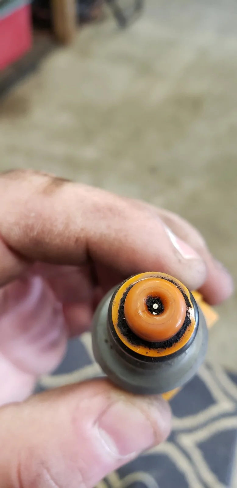

Plug wires are good, ohm checked them and they pass and they're not in bad shape. My vac gauge was indicating my timing was too far retarded on the dial but I have my doubts as I just set base time with the spout disconnected and the distributer hold down is tight not moving around. I have a picture of the cylinder 3 injector here
That injector looks like it wasn't flowing much, probably for quite some time. So it definitely needed replaced, even if it wasn't the immediate cause of the problem. If the left bank is being enriched, the O2's think it's not getting enough fuel (too much air). That could be caused by another dead cylinder (O2 sensors don't detect raw fuel, only the air which hasn't been used up in the combustion reaction), and it could still indicate you might have a leaking injector that wasn't #3. Did you check how they all flowed / held pressure when you had the rail disconnected?
