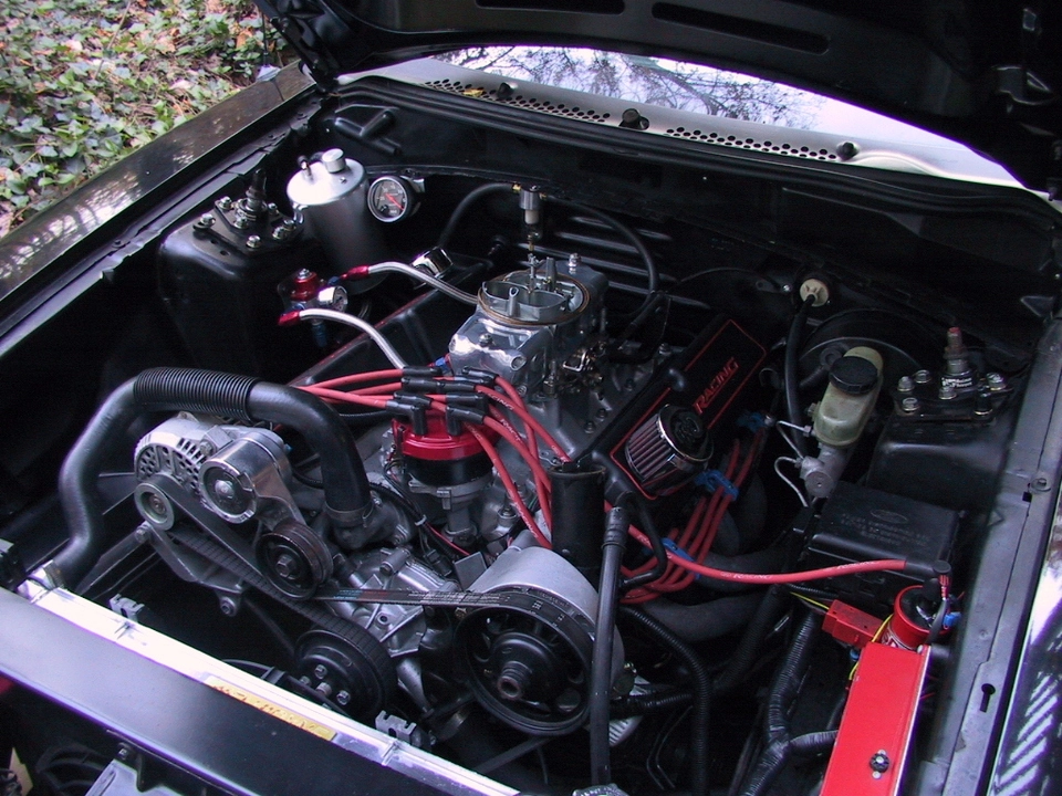

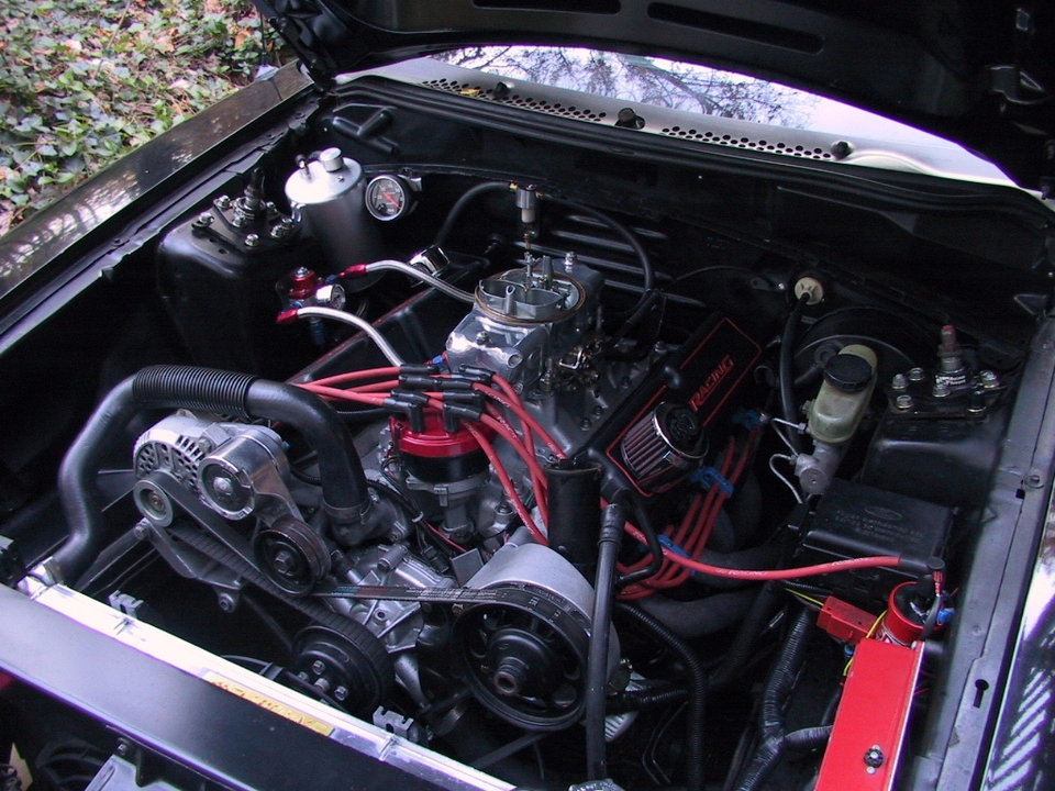

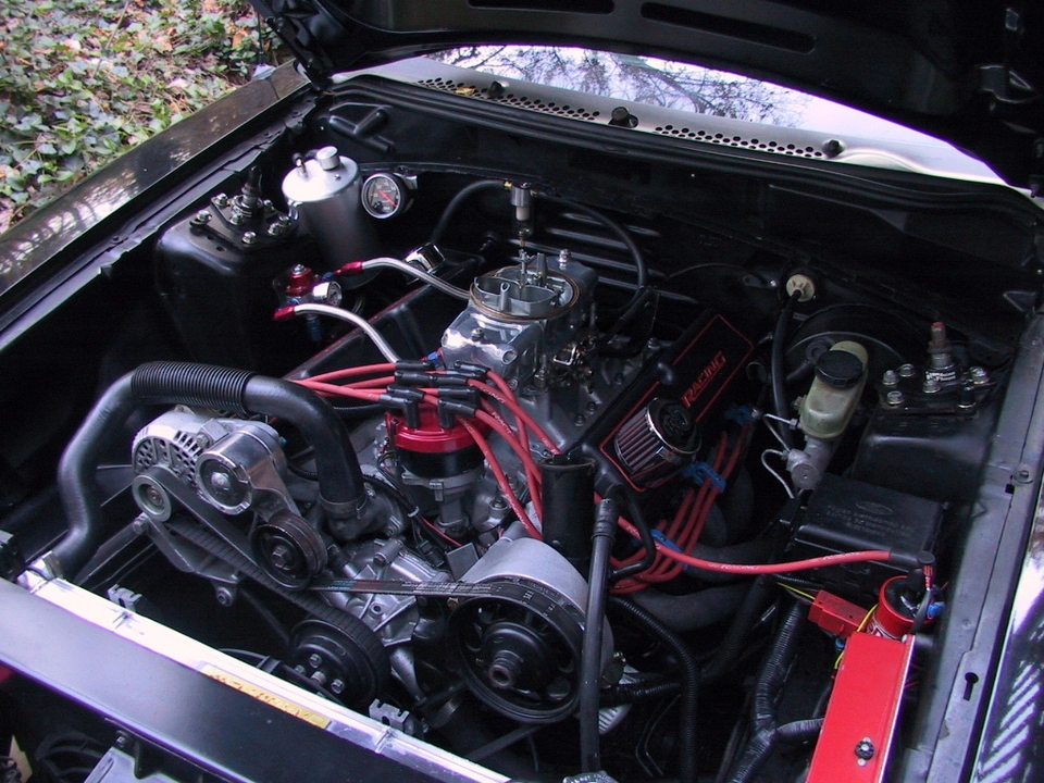

I did the conversion a couple years back on my old '94 / 347 CID car.

The computer gets completly removed correct? Also how hard is the wiring to do? Is it alot of work? As far as the fuel setup goes is that a pain? Im a carb newb, and I really need all the help I can get. thinking of doing the swap very shortly. Thanks.
Yes you can completly remove your computer, but your speedo is not going to work....The only think I can imagine being a pain on the fuel setup is cutting the braided lines....
Pretty sure it's a fuel cooler; looks to be a fuel line coming out the bottom of it going to the FPR. Hard fuel line coils around the inside of it and it can be filled with water/ice. Helps avoid vapor lock in carbed cars since they operate at a lower fuel psi.
It's a vaccum canister. I was having issues with power brakes with the big cam I was running.
As far as removing the computer: As Guero said, you can remove it.. I left mine in for a couple reasons.. I like my speedo working, and I wanted to be able to easily swap my Fuel Injection back in if I ever decided to. As it ended up, it was easier to sell the car with the fuel injection stuff still in it since that's what I ended up doing.
Your headlamps/turnsignals etc will all work, just leave that wiring alone. The fuel injection/engine bay harness is the harness you will be removing/disecting.
It's up to you about the gauges. I removed my entire harness and used Autometer gauges for the Oil Press and Water Temp... Some prefer to disect the harness and use the factory gauges.. I'm too lazy. :nice:
