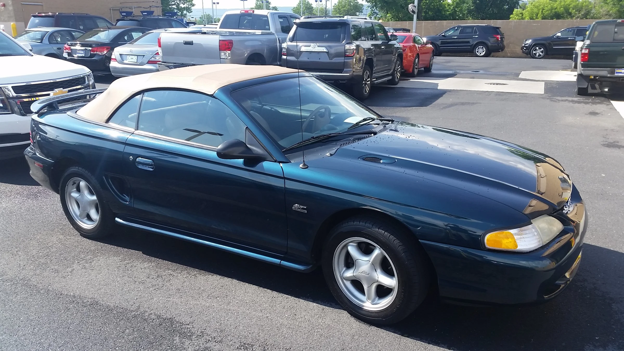

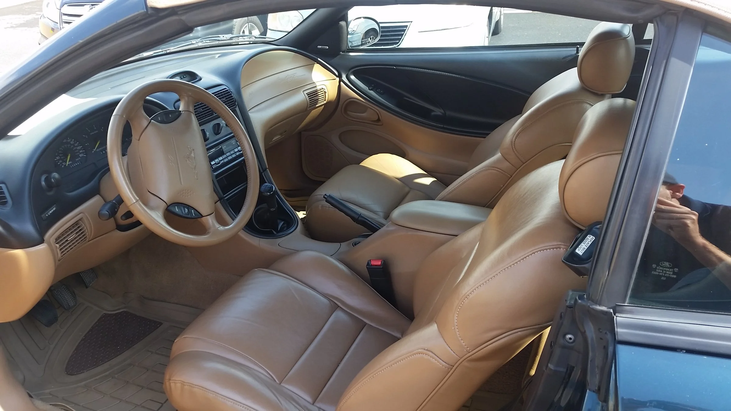

I just joined the Pony crew and bought myself a 95 GT Convertible with 72k (I have included pictures for those interested). It has a couple issues I am working n resolving one of which is an issue with the driver side windows only.
