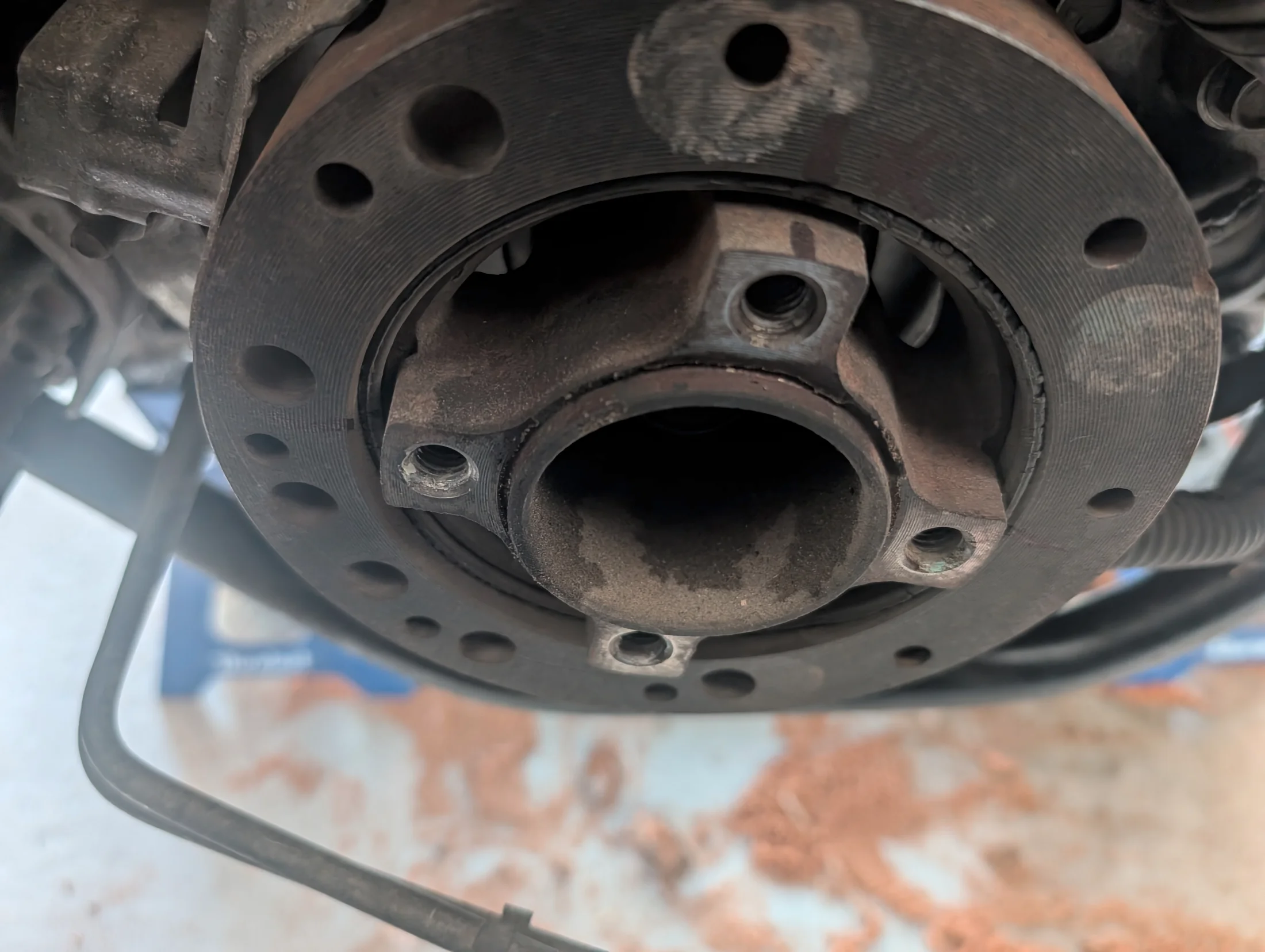

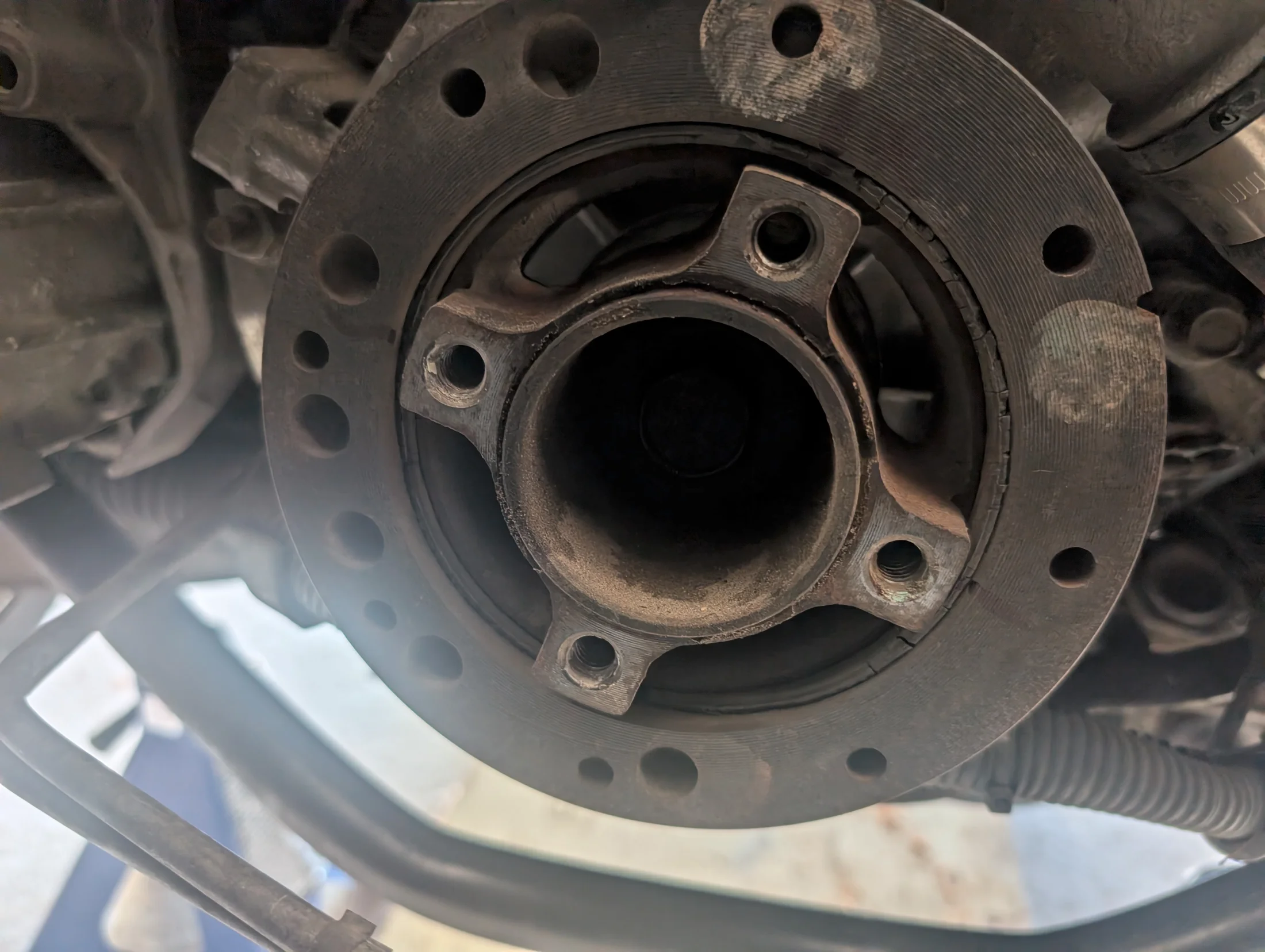

I took enough stuff out to get some pictures of the balancer. The rubber is looking pretty old. You can see some cracks, and you can see that the rubber is not flush with the front surface of the damper on the left and bottom. Didn't want to do it, hate pulling the radiator and stuff, but I probably should.
I would still love to hear any opinions!... but I think I will go ahead and order a balancer.
For what it's worth, just because it's easy to do, I also checked all 8 plug wires with my timing light. All are firing.
Edit: I don't think the radiator has to be pulled out for this. For whatever reason, I have always had the radiator out when pulling a balancer, but it looks like I'll have enough room to leave the radiator alone.

FWIW, the cracked rubber may not mean anything. But I have had a sudden vibration and found out that the balancer broke on me at the crank snout for whatever reason. Replacing the balancer fixed my issue (obviously). You'll know if that's the issue the minute you remove the retaining bolt....
  • Useful
Reactions: lenzgt
Looks shot to me but the way to know for sure is to get the motor up on top dead center (TDC) and see if the timing pointer is at 0 degrees or very close to that. If the balancer has slipped this will tell you. If you see any kind of wobble with it then just replace it. Good balancer discussion in this thread:

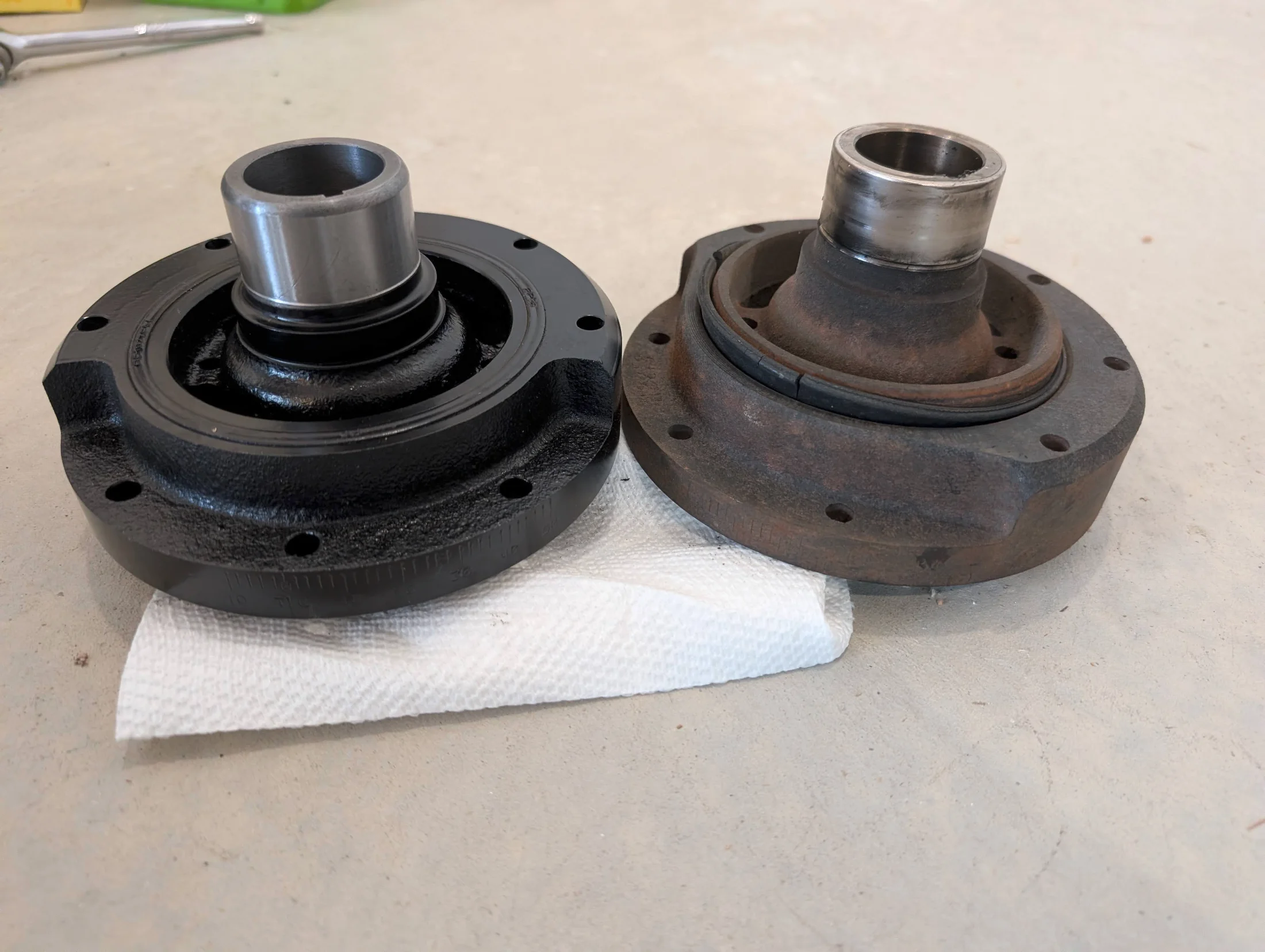

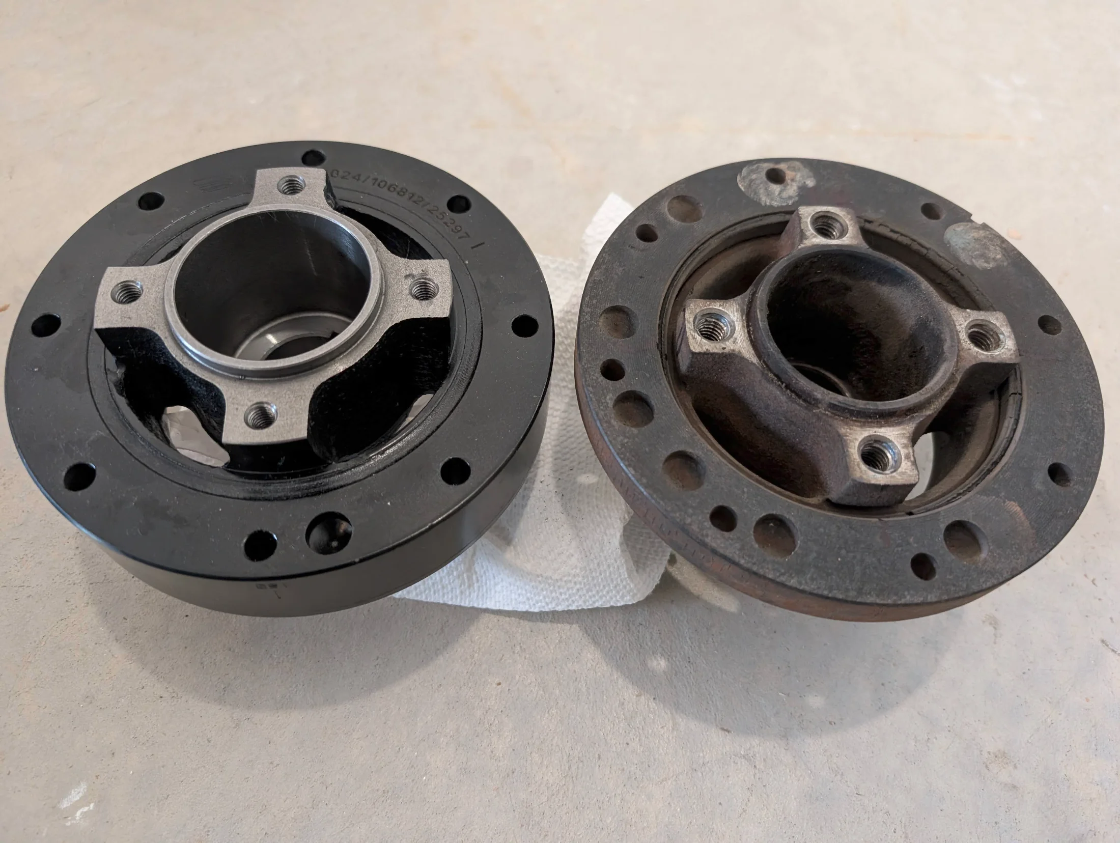

Well, the balancer was certainly shot, the outer donut was working towards coming off the hub, the rubber donut was coming apart, etc. You can see it compared to the Dorman replacement part here.
Unfortunately you can also see that the tapped holes on the Dorman balancer are too small. My pulley bolts are 3/8-16, these seem to be M8 or 5/16. I would have thought 5/16 but it seems to have a metric thread. I was tempted to just use it anyways, but I don't like how loose the M8 bolts are in the pulley clearance holes.
I filed for a refund and am now looking for a balancer with 3/8-16 holes, but nobody specifies this hole in their product details... making me think it shouldn't be a thing that varies among balancers. I may try ordering the Pioneer and see what happens.
Any ideas out there? Happen to know the size of your pulley bolts?

With the new balancer in, the vibration is gone. :cool:
The Pioneer balancer was not as pretty as the Dorman but it had the correct mounting holes and feels like it is doing its job correctly. Much easier job than the motor mounts, 5x easier, would have done the balancer first if I had known. Although in my case, the mounts were definitely needed anyways.
