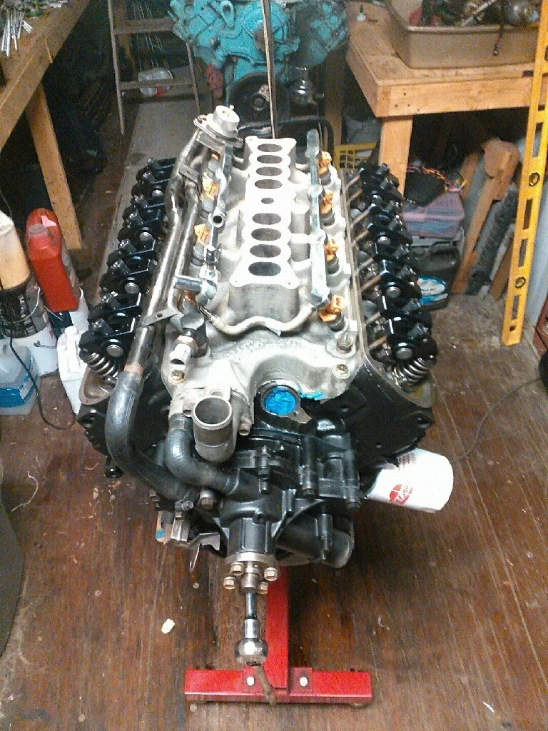

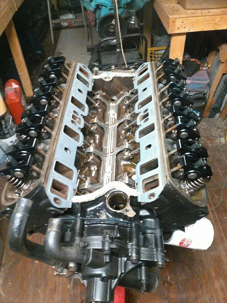

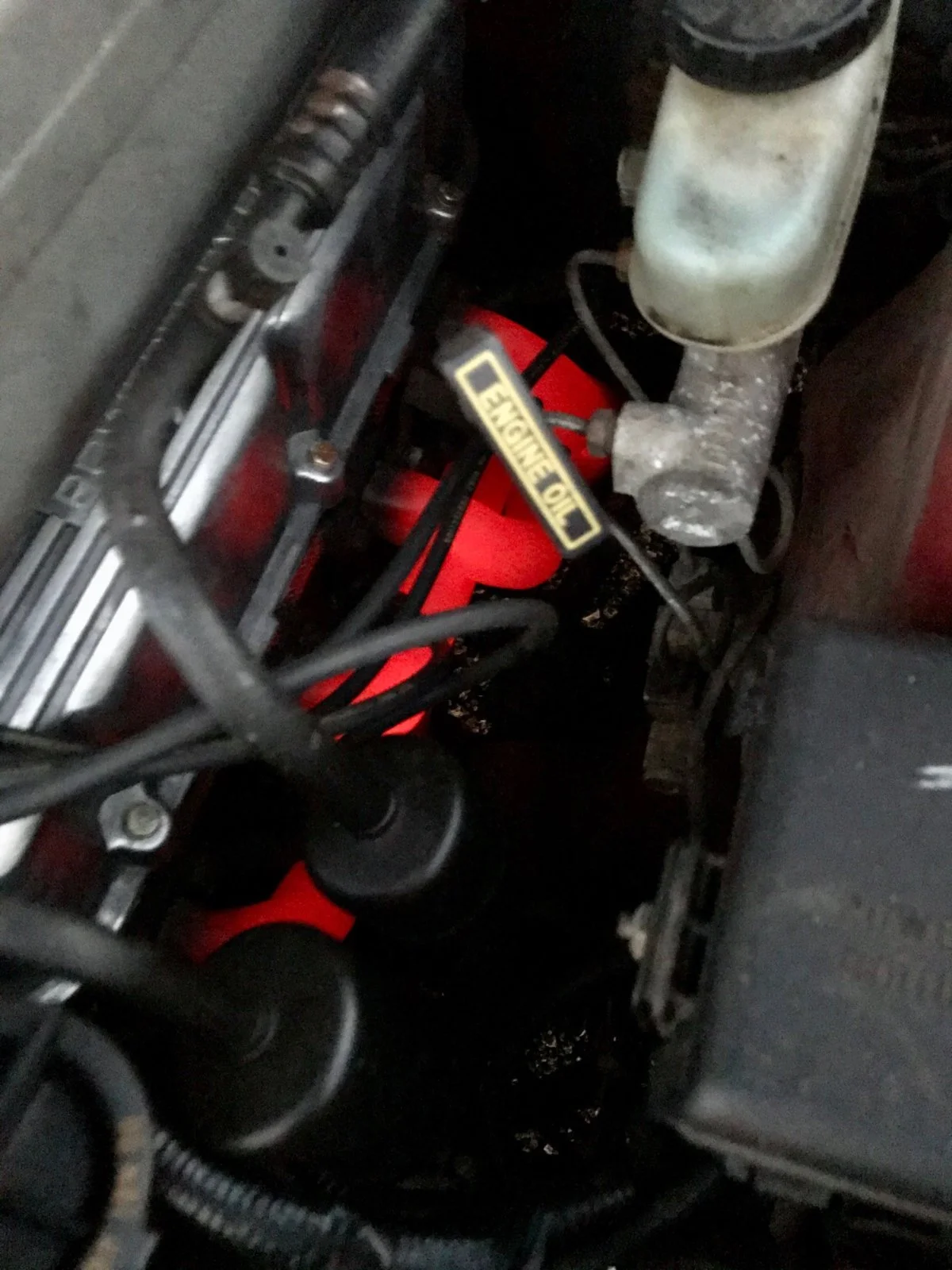

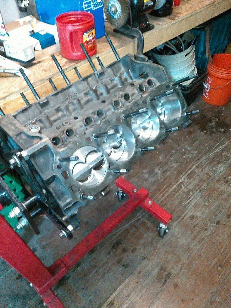

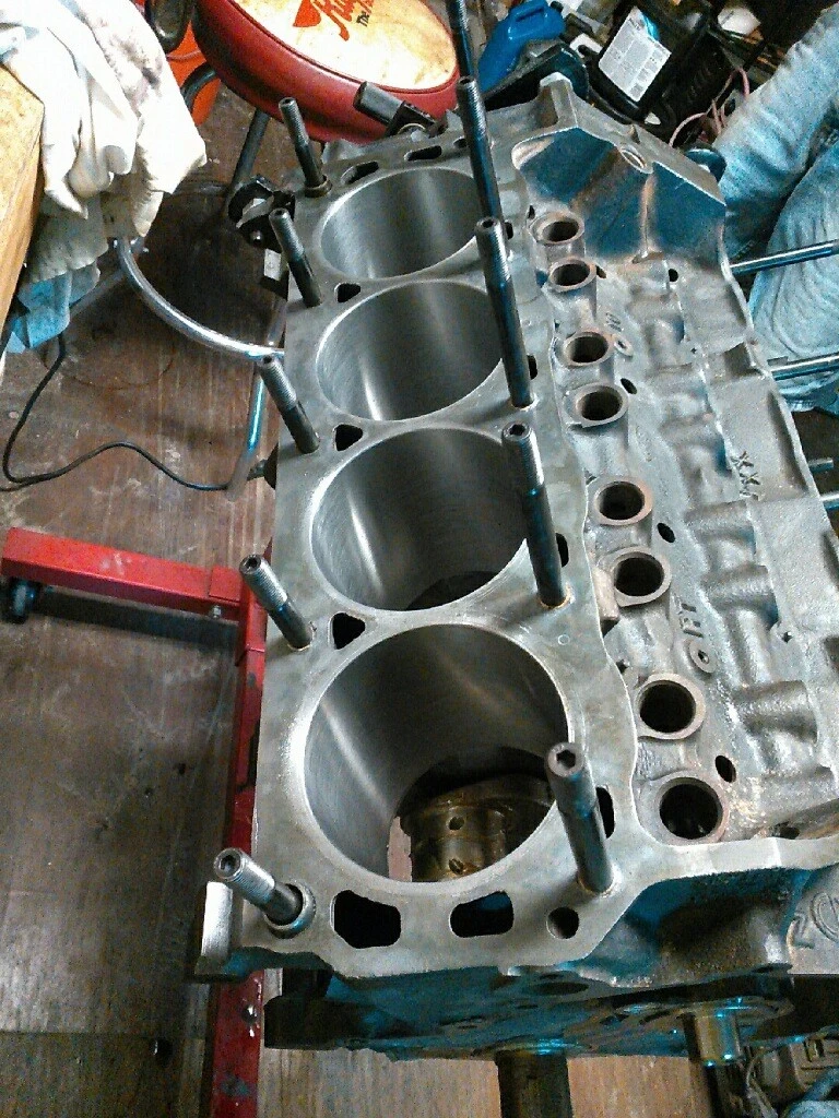

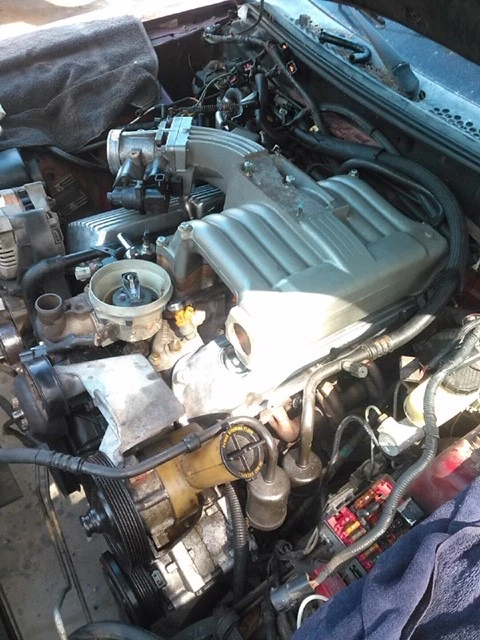

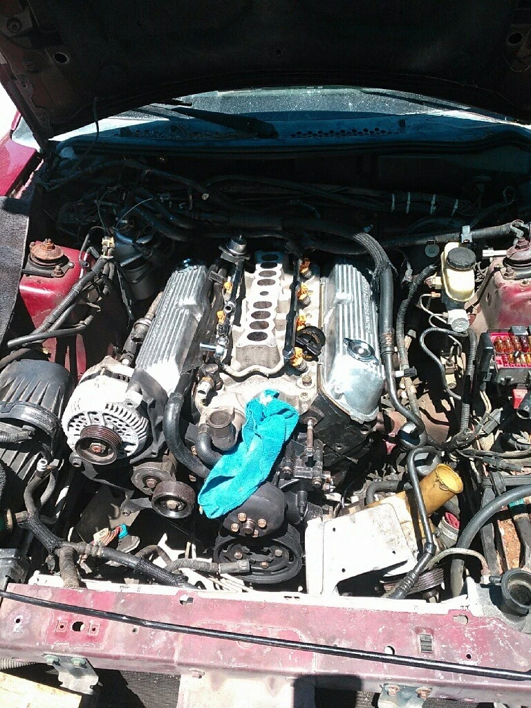

yes its 100% 347 stroker, yes its the stock intake 95 mustang gt came with, the radiator and fan work fine ive flushed the radiator twice an everything flows smooth. when i picked up the car once the engine was installed and drove it home everything was fine no heating issues nothing drove for a few weeks no issues and suddenly one day when i was driving it i noticed it got way hot then it been that way ever since for a couple of months now. this link will take you to the pistons i have https://www.summitracing.com/parts/slp-h273cp30/make/ford
here are some pics below i dont know if it will help at all

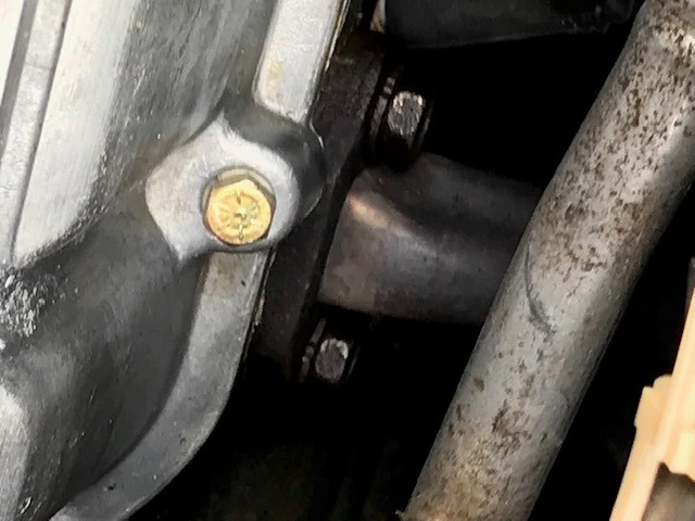

and a few more the one with just a part of the header is where it smokes, the other is the glowing one driver side but it does on the pass side as well.

No wonder it's running hot, that header is hotter than sun.
It has no cats so not possible for a clogged cat? It's like the heat is trapped right there.
Normally you see glowing headers under full throttle for a while but this may be the first I've seen glowing at idle.
Why is heat trapped right there is the question? Is there even exhaust coming out of the driver tailpipe? It's almost like the collector is closed and heating is stuck in the header.

both sides glow like this, yea no cats they where removed long time ago by my step-dad, exhaust does come out of both tail pipes.
