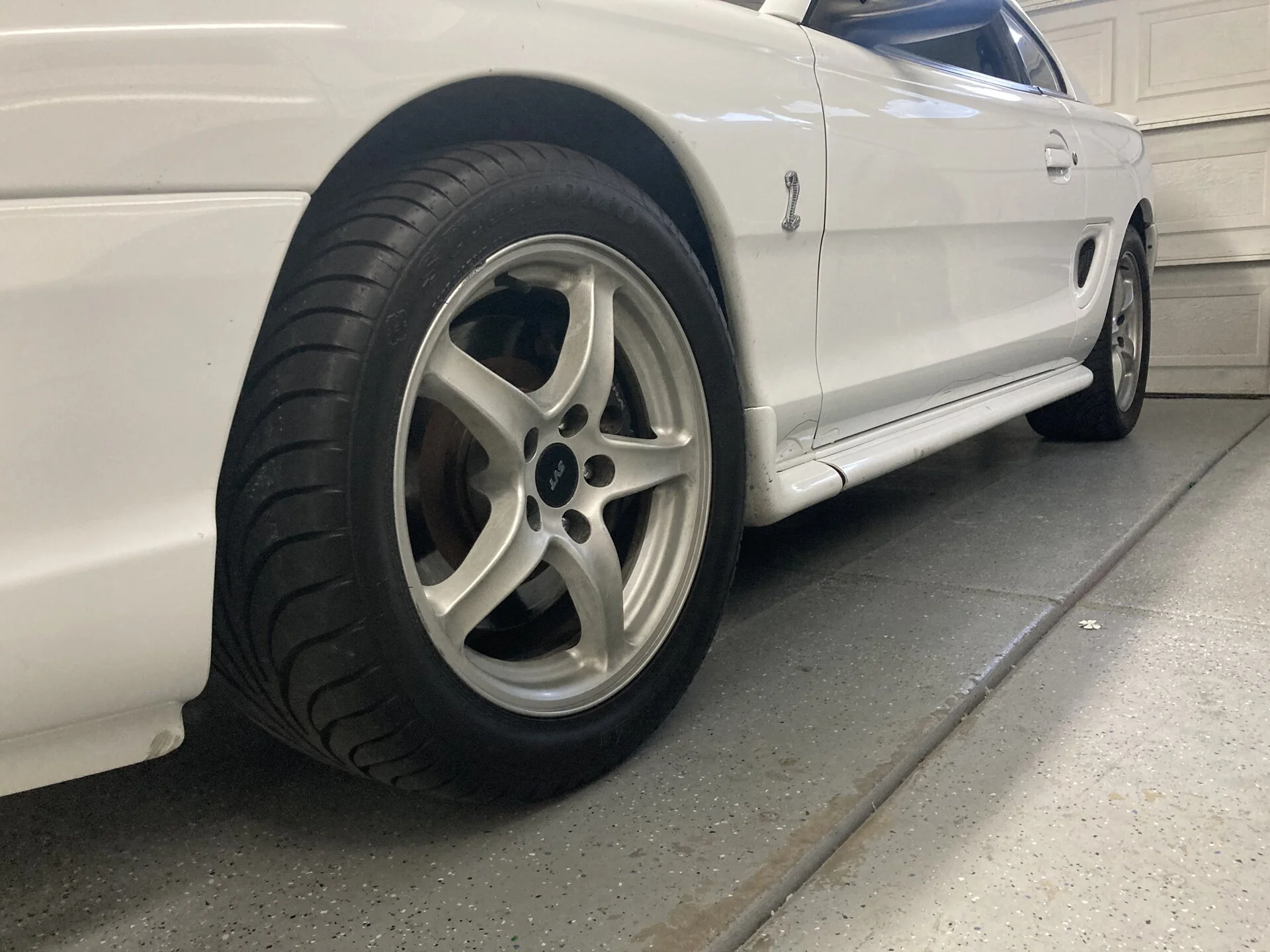

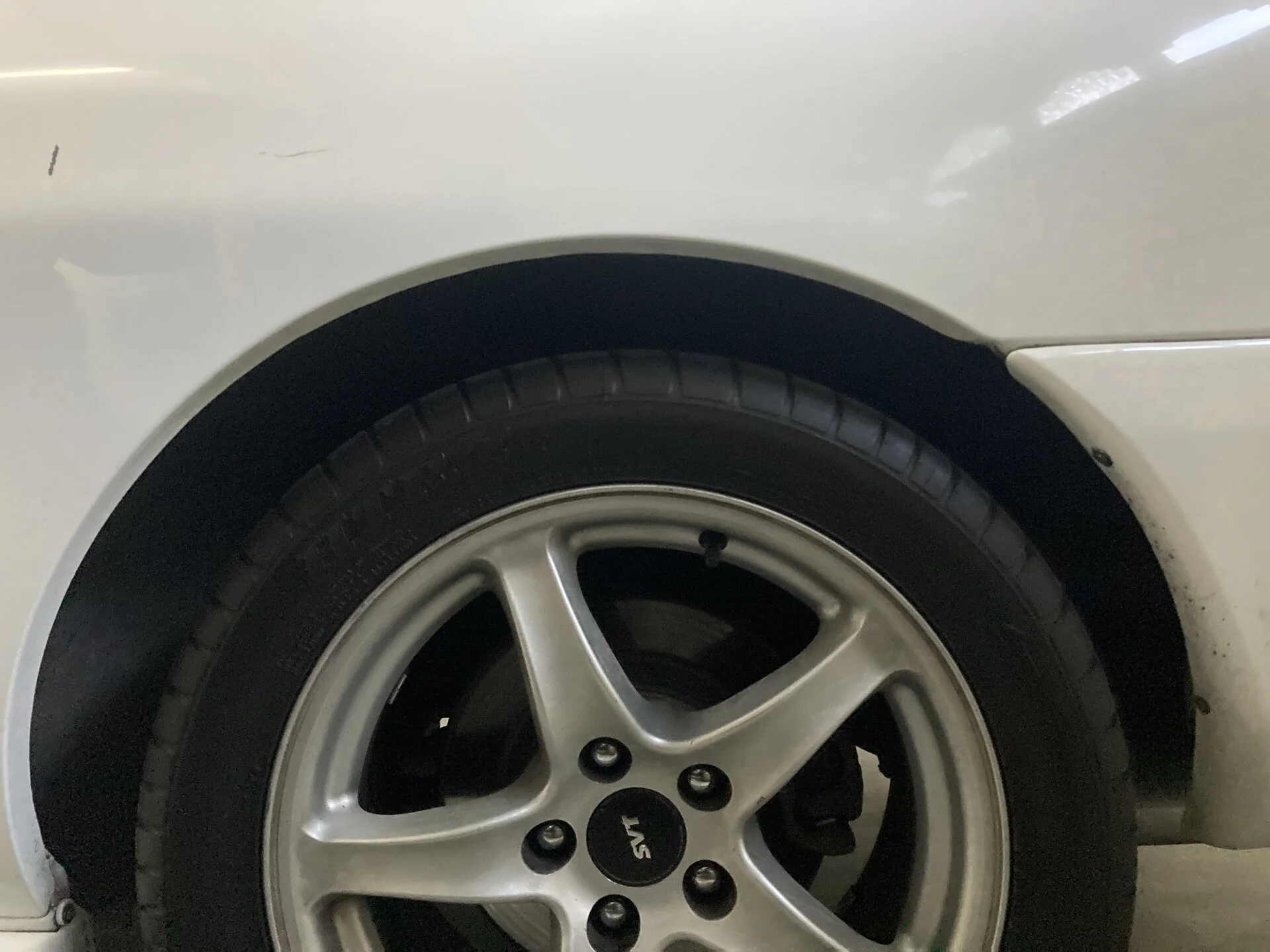

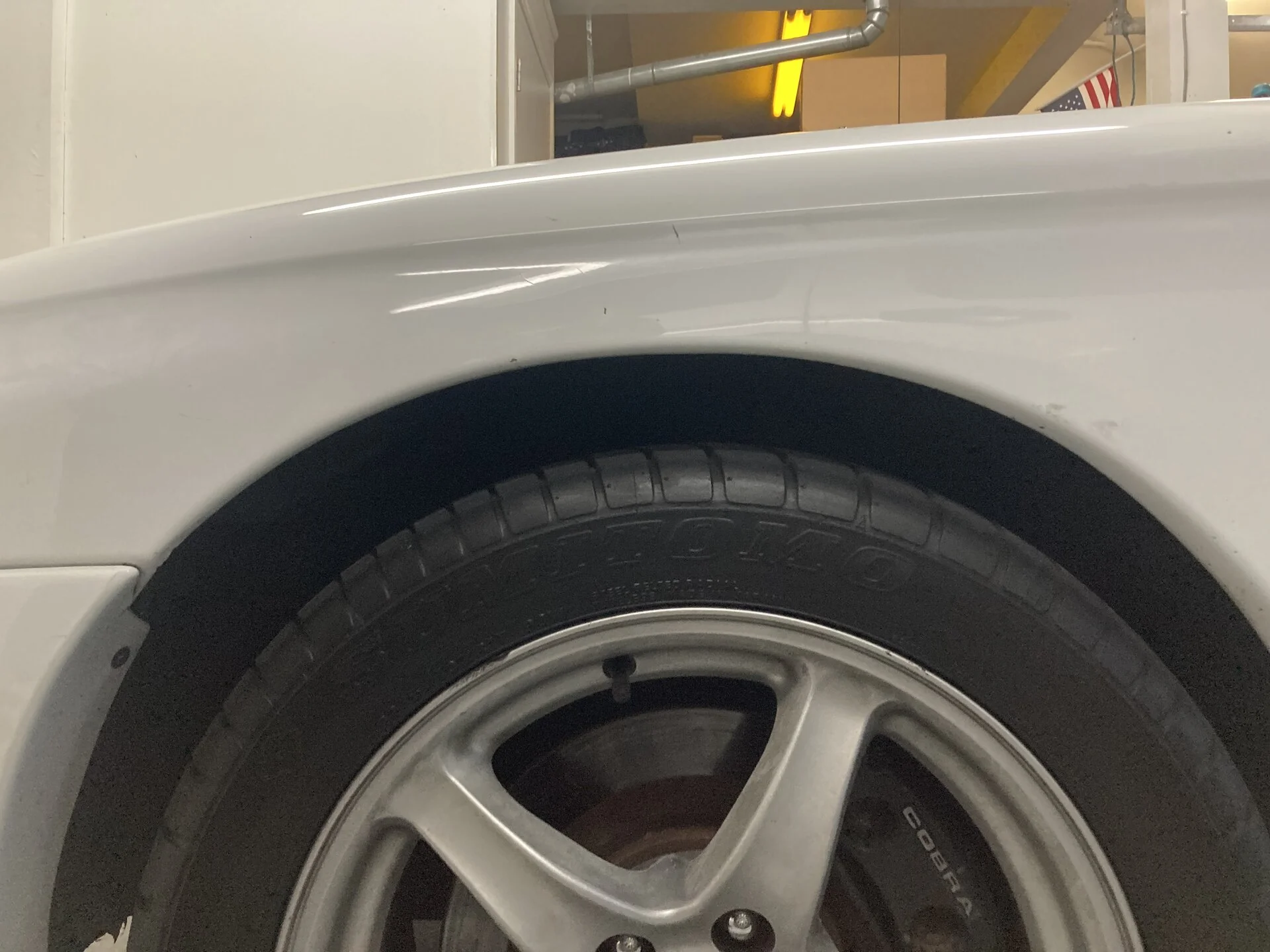

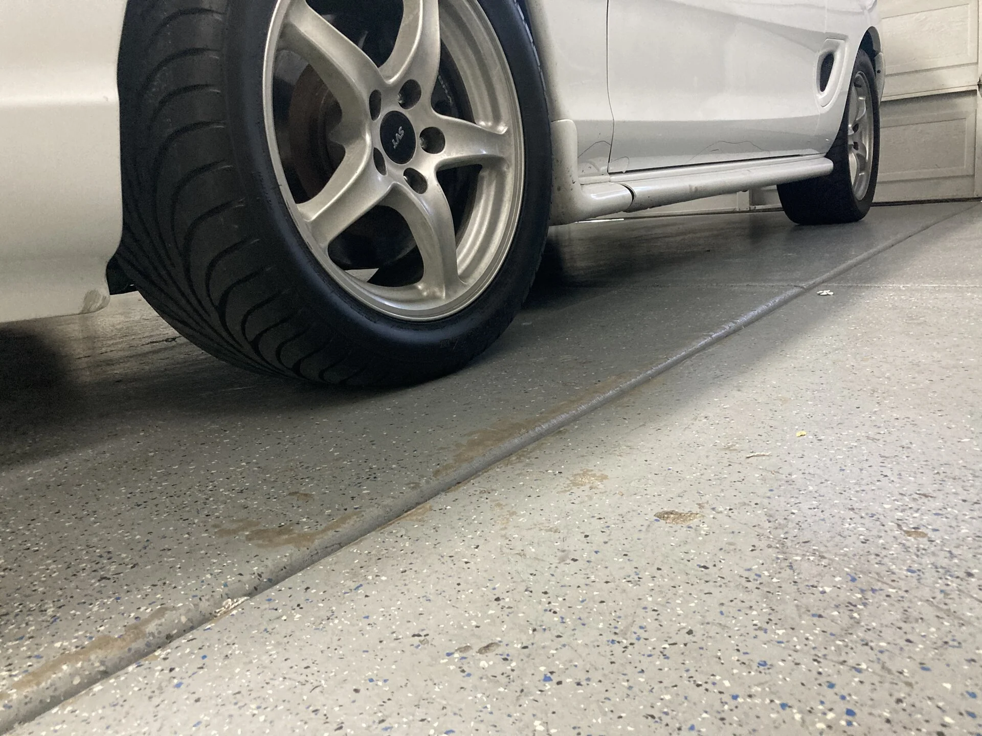

Here are a few pics to show the height its currently at.
My SN95 cars sit at around 27" (measured at the center of the fender arch). Before buying new springs, take that measurement on your car. Based on the photos, I suspect you are lower than 27".
The B-springs are a good option. I would recommend using poly spring isolators with them.
