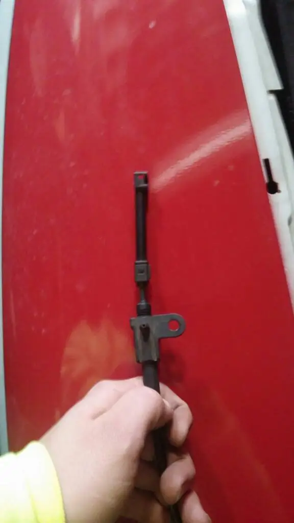

While the t45s can have internal.fork issues, it would be difficult to.shift too with engine off if there was internal issues..stiff clutch and difficulty shifting mean your cable is.misrouted, going bad, miss adjusted, or worst case (not likely) bad pressure plate on clutch
Grab the clutch pedal and pull upwards. Then push it to the floor. Hopefully you hear a click indicating a small bit of slack has been taken up. Try it out again.
Issue is clutch not disengaging all the way if the trans will go into gear at a dead stop. The cable is possibly stretched
What I would do is, check to see if the shift fork is moving and how far it's moving. Then take the cable off the shift fork and see if the cable can freely move, might be bound up some where or frayed inside the plastic or the plastic might be melted some where causing the hard pedal and possibly the shift fork not to move as much as it needs to. If the cable moves freely then move your shift fork, it takes a pry bar and some strength to move it. If it can not move a lot or not at all, something is wrong internally with the trans. Also if you have an aftermarket shifter make sure the shifter limit screws are set correctly, it can cause you not to go into gear. That hard clutch pedal will break your stock clutch quadrent or your cable.
What does your clutch pedal feel like? Often a clutch that is too loose will have tons of slop at top of the pedal and it won't be going to get Stiff until the actual disengagement point how far do you have to push down on the clutch.until it gets stiff and begins to disengage?

What might this be.notice it not attached to anything and runs down and into the firewall. I'm assuming this is my problem
