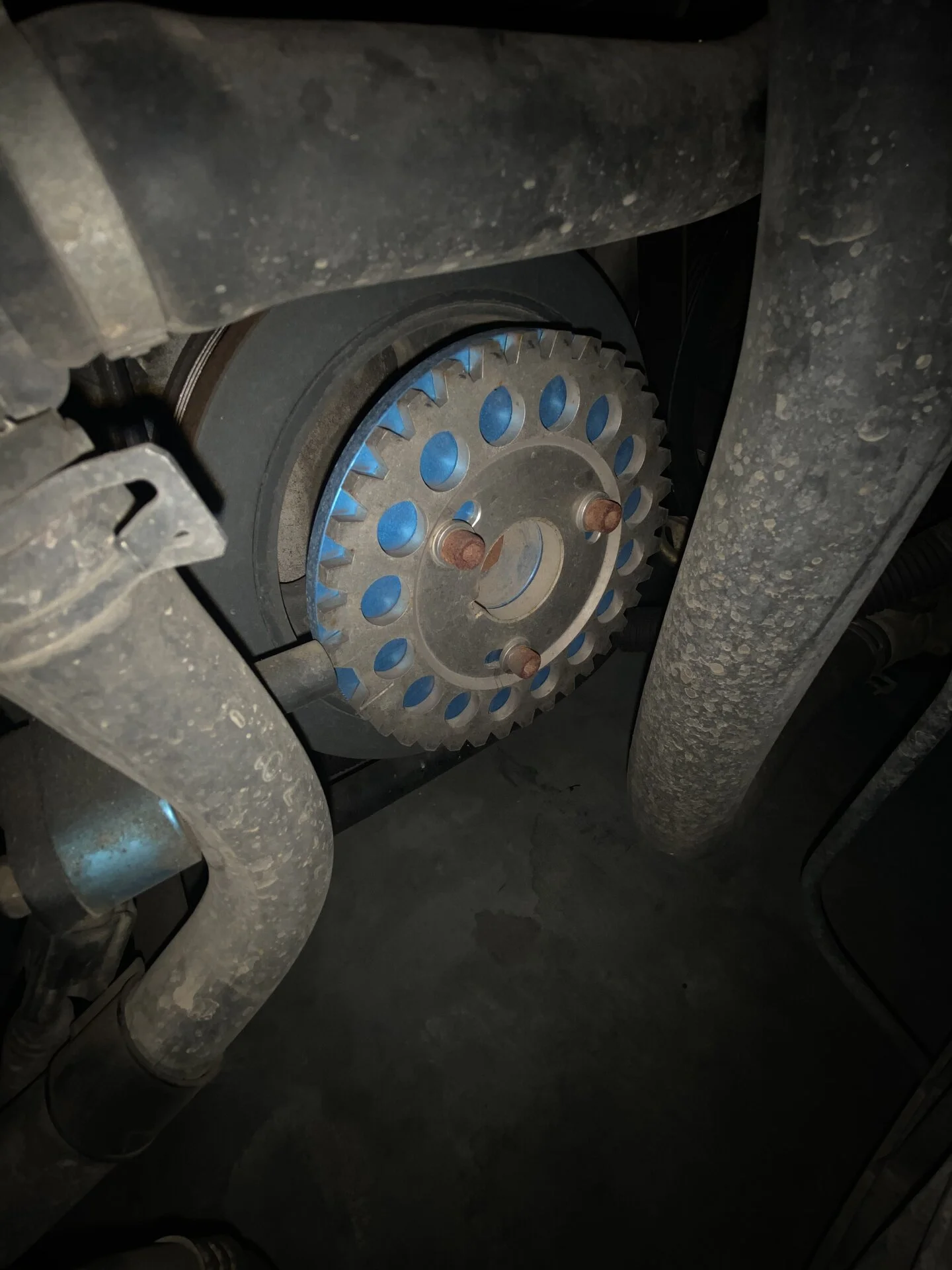

Crank trigger...I have never seen one of these on a car, only heard of them a handful of times.. what needs to happen to return this to stock and is there a benefit to leaving it on? Would the car have to be tuned for this to work?

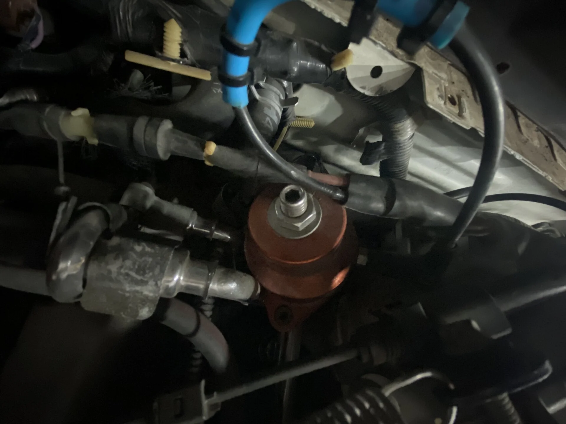

Fuel pressure regulator, aeromotive brand, and I would assume an upgraded fuel pump with blue injectors which I thought were stock. I am having a hard time starting it, sometimes it fires immediately, sometimes I need to flutter the gas pedal for about 10 seconds while cranking. I do notice a fuel smell while this is happening, but dont know jack about the FPR and if it could be an issue, or maybe an evap issue.

Is this engine stock? I'm wondering why they installed an aftermarket crank wheel and trigger? Is it running the stock ECU? Or did someone swap ina microsquirt? I would investigate why it's there before making a plan to remove it. Where do the wires for the crank sensor run?
