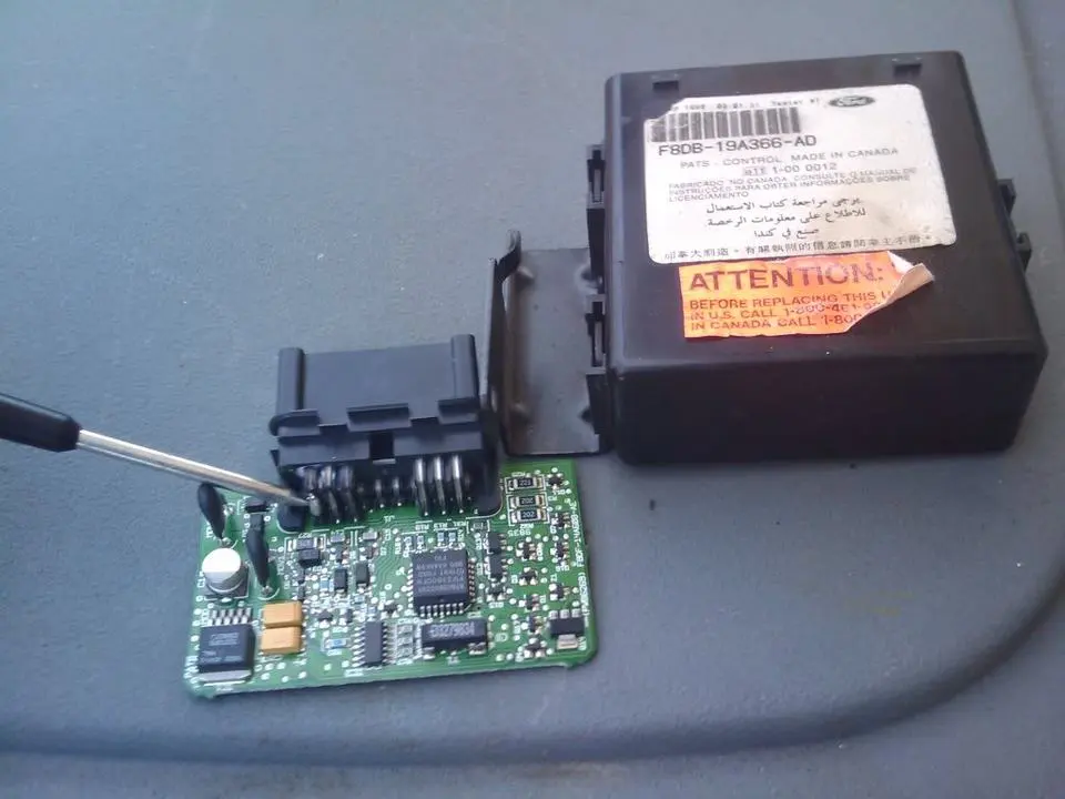

good one...i help a guy with a 99 gt..his would crank over ,he had fuel but no spark...
hes ended up being a short in the pats module
