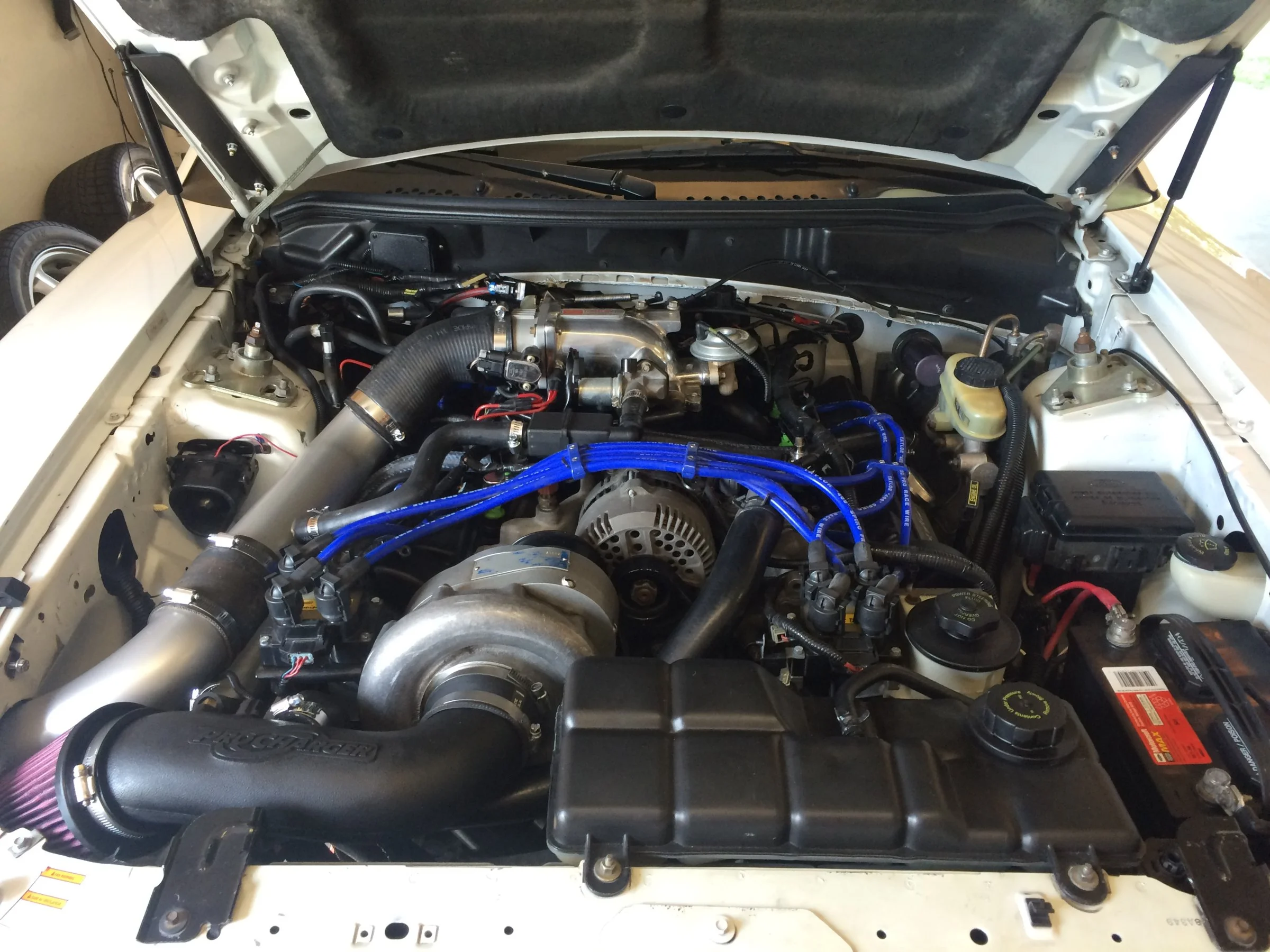

So I have a Procharger p1sc. 3 core inter cooler and race blow off valve with all the supporting mods to go on. All the little stuff will be here this week and I'll go pick up the blower tomorrow.

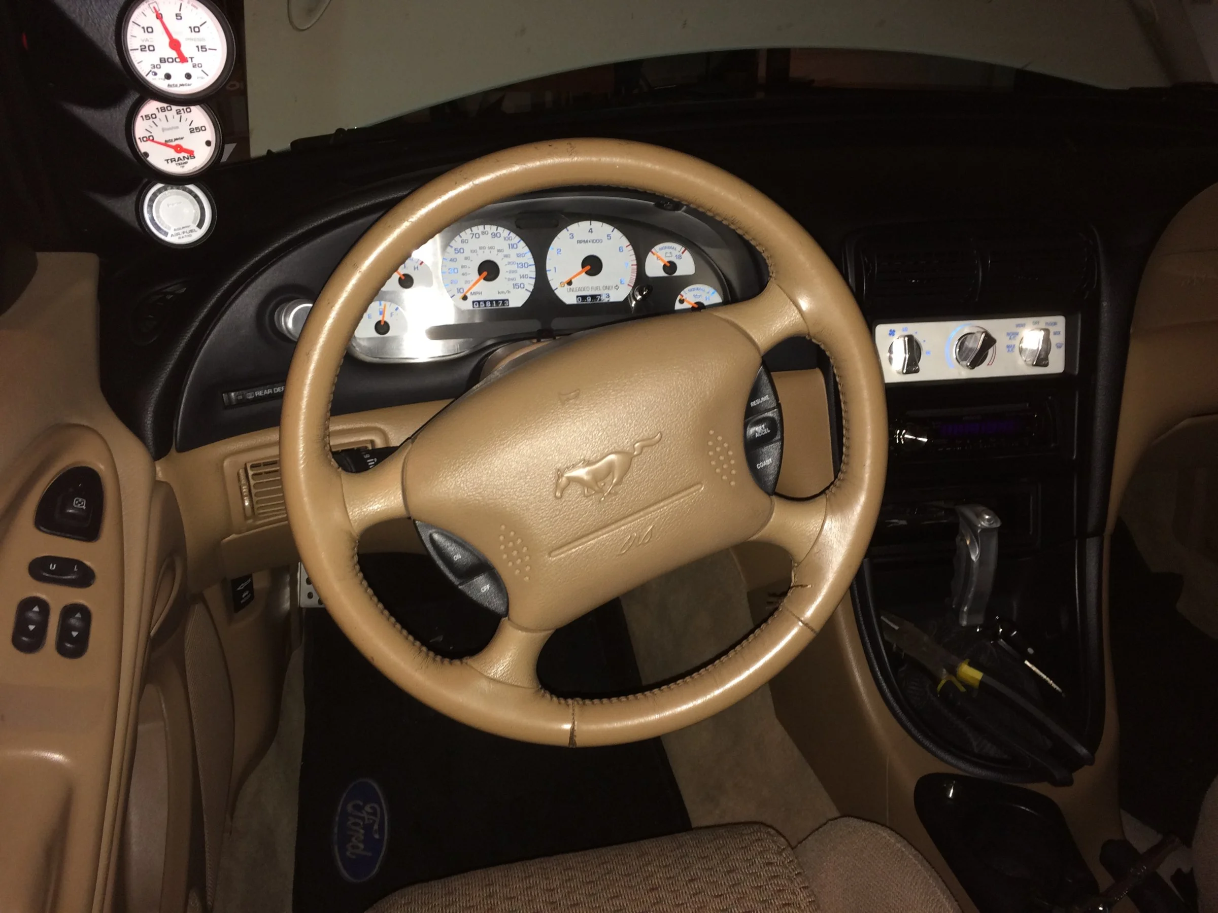

Gauge install is complete. I need new bulb covers to match the blueish dash lights. I still need to tap a line for a boost reference and run the trans temp wire down (plus install that pan).
I'm open for suggestion on the best boost reference spot.

I tapped the vacuum line off the top of the fuel pressure rail sensor for my boost gauge. Never had a problem. Routed the house thru the big rubber grommet that's low on the driver's side of the firewall. Mine was an 04 but I assume the early sn95s have the same grommet.

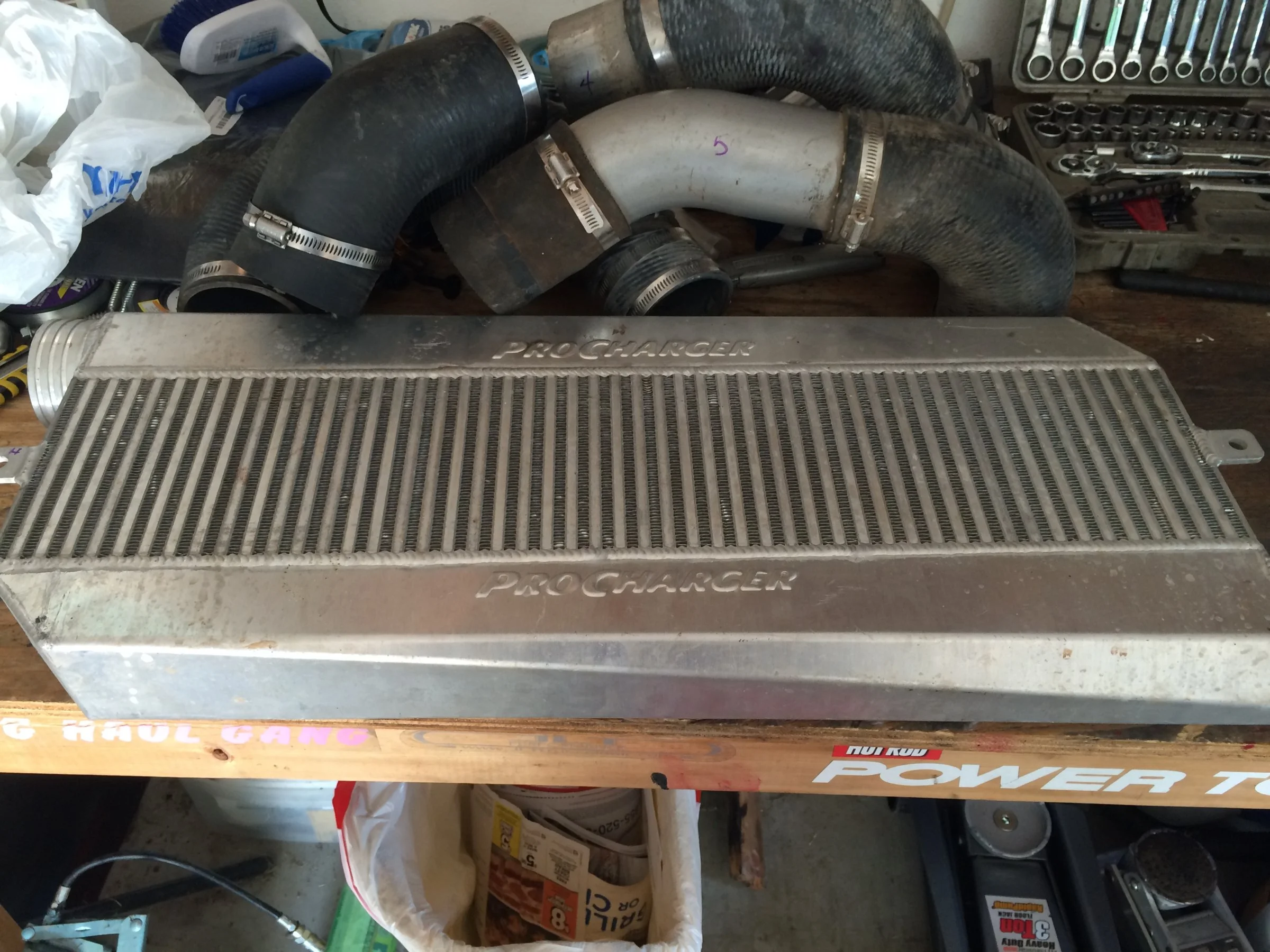

I just ordered a tubular front bumper support as well. The stock support blocks over 1/3 of the intercooler surface area (large 3 core cooler). This way I'll get better cooling effect and help with iat's.
