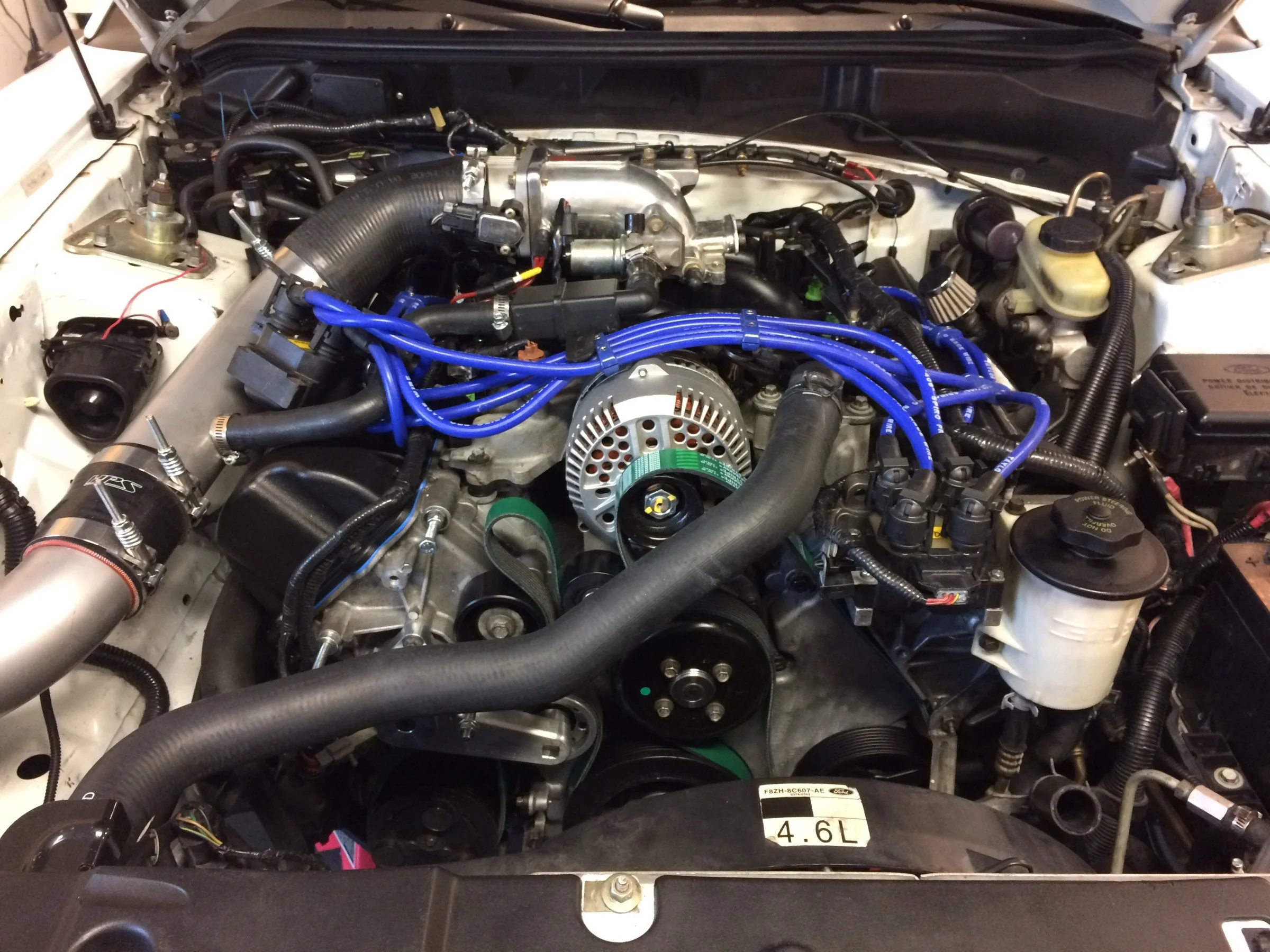

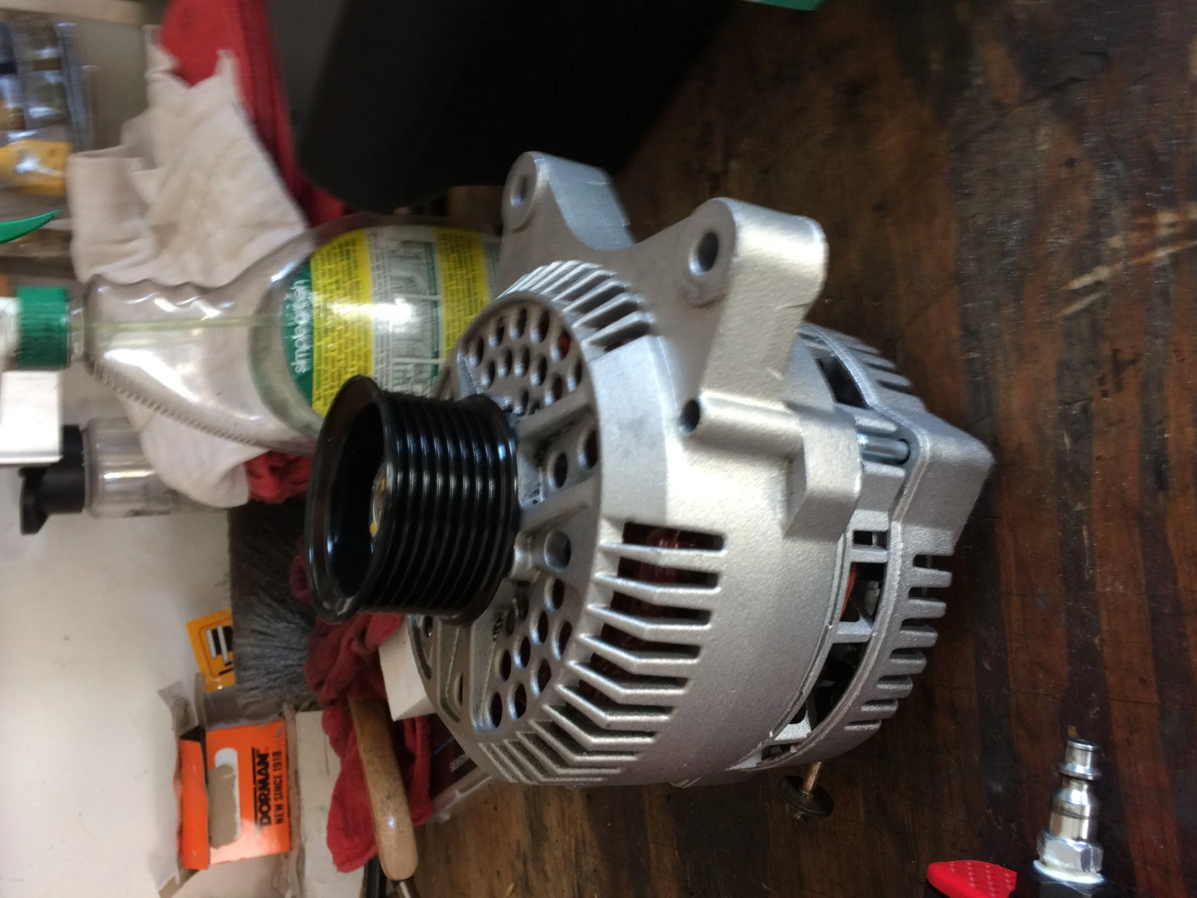

I also started the process of piecing together an 8 rib conversion. Using factory ford parts from 5.4 Conversion vans/trucks. I might run a tad bigger upper blower pulley since I know the 8 rib will come on harder and faster with a slightly larger crank (7 inch vs 6.67 stock). I should spin the blower about 1k slower at 6k rpm but make pretty close to the same boost as I shouldn't have any slip. And it should cure my 3rd gear issue of low boost from massive belt slip. So let the belt size games continue. Luckily I can return my extra belts I have for this set up and it looks like I have a good selection of the Green HD 8 rib belts to choose from too. Hoping to have it done by next weekend. Might be able to make another track run.

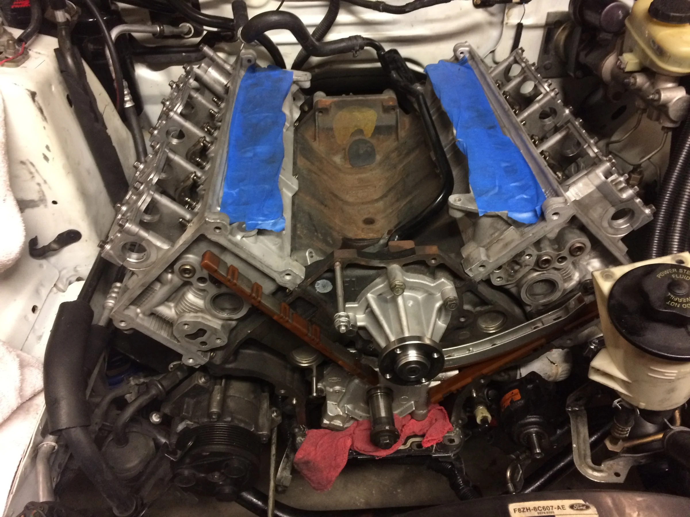

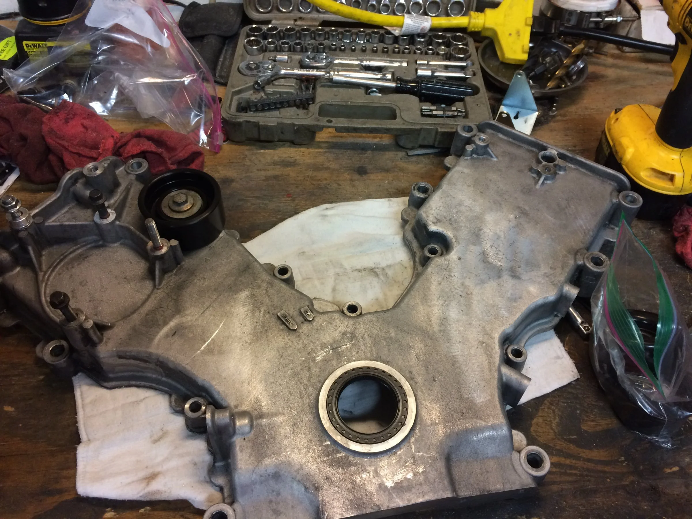

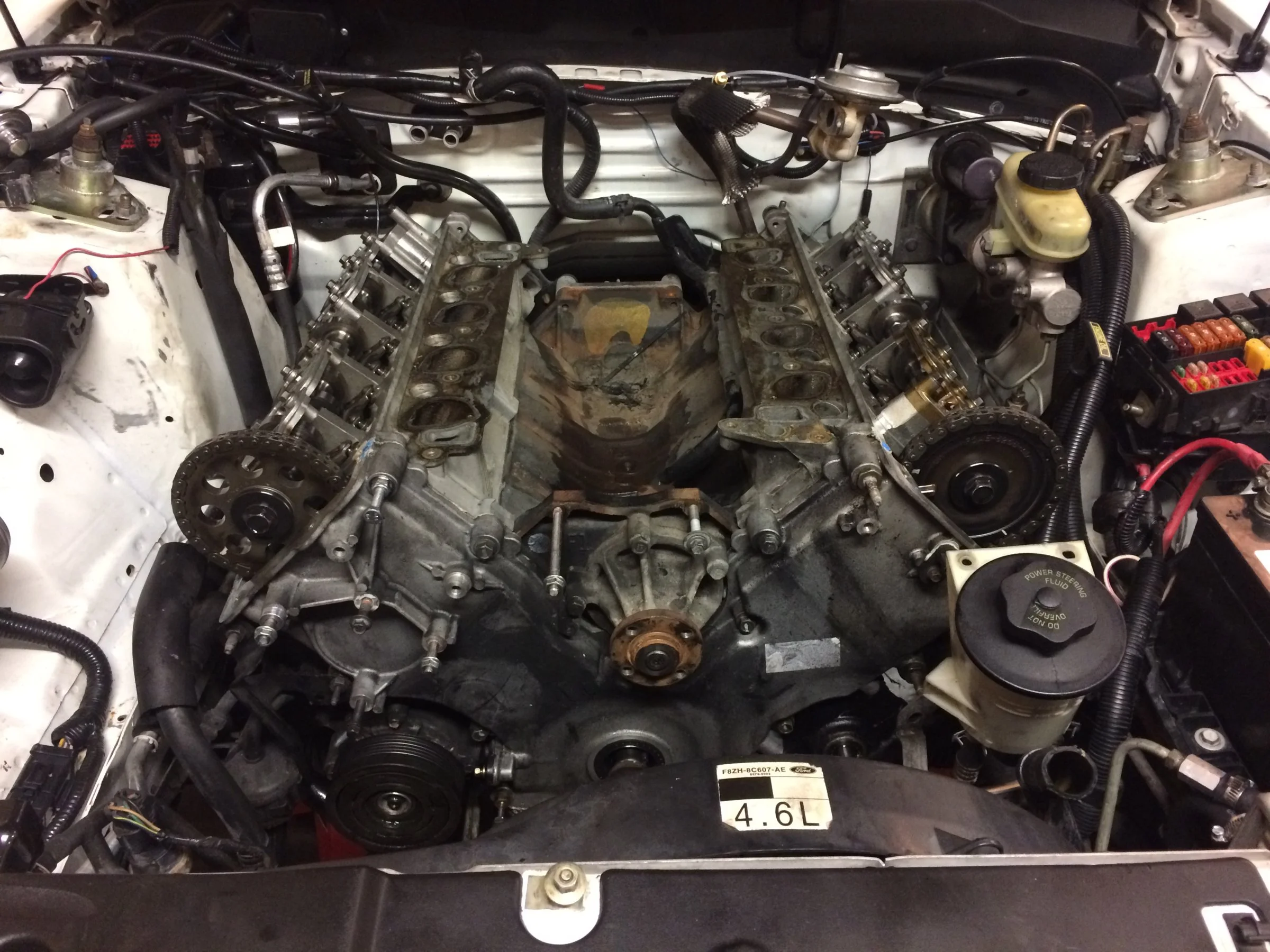

So the heads are coming off tonight. After attempting the pulley swap (Man that ac pulley is a biatch), I realized that the front cover is seeping in a few places and needs addressed so I don't ruin belts with oil. Also the pi intake on the npi heads wasn't sealing correctly. That is where my coolant smell was coming from.
So I'm knee deep in a head swap and another grand in parts/bolts etc. I went ahead and did the studs just so I have them. 12lbs of boost and 10.5:1 compression will make for some cylinder pressures. :)

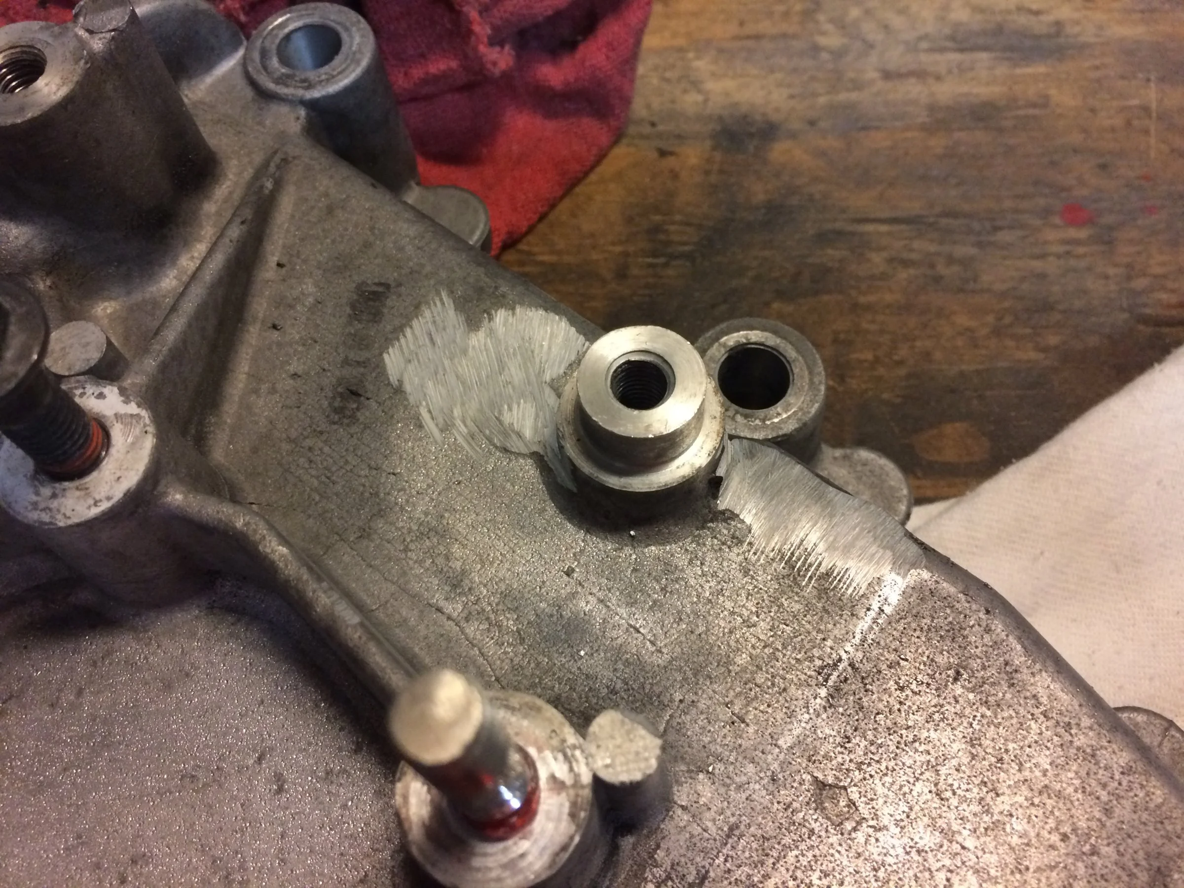

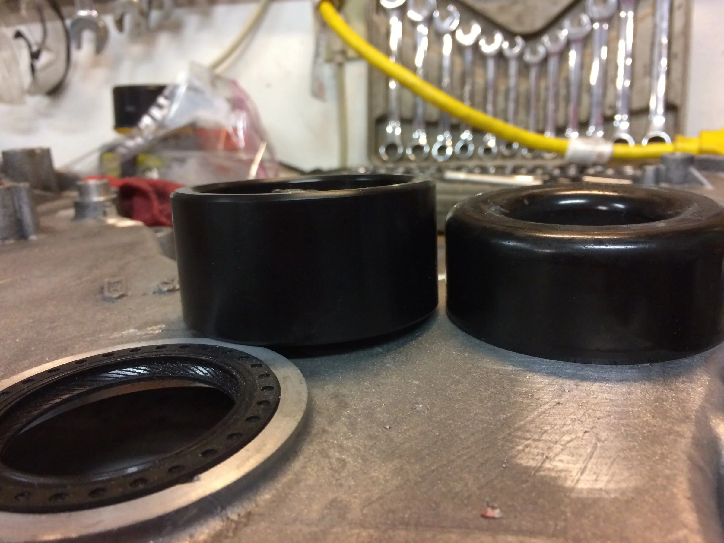

I'm still having issues getting a 76mm 8 rib idler pulley that will fit the stock cover. I have a stock ford 5.4 8 rib idler and it's 90mm and won't clear the tensioner mounts, a upr 8 rib 76'mm and it was is spaced way off. And I have a stock one of course.
I got the heads and exhuast back on today. My pass side header studs to the mid pipe were messed up and I got the joy of removing It and fixing. Ugh how I hate 2v header removals.
Cams are already on their way back from mhs so I'll get the engine buttoned back up when they arrive.

So I hope to get the engine buttoned up this weekend and all ready to mount the head unit to the bracket and on the car so I can align it for the millionth time with the new 8 rib setup.
