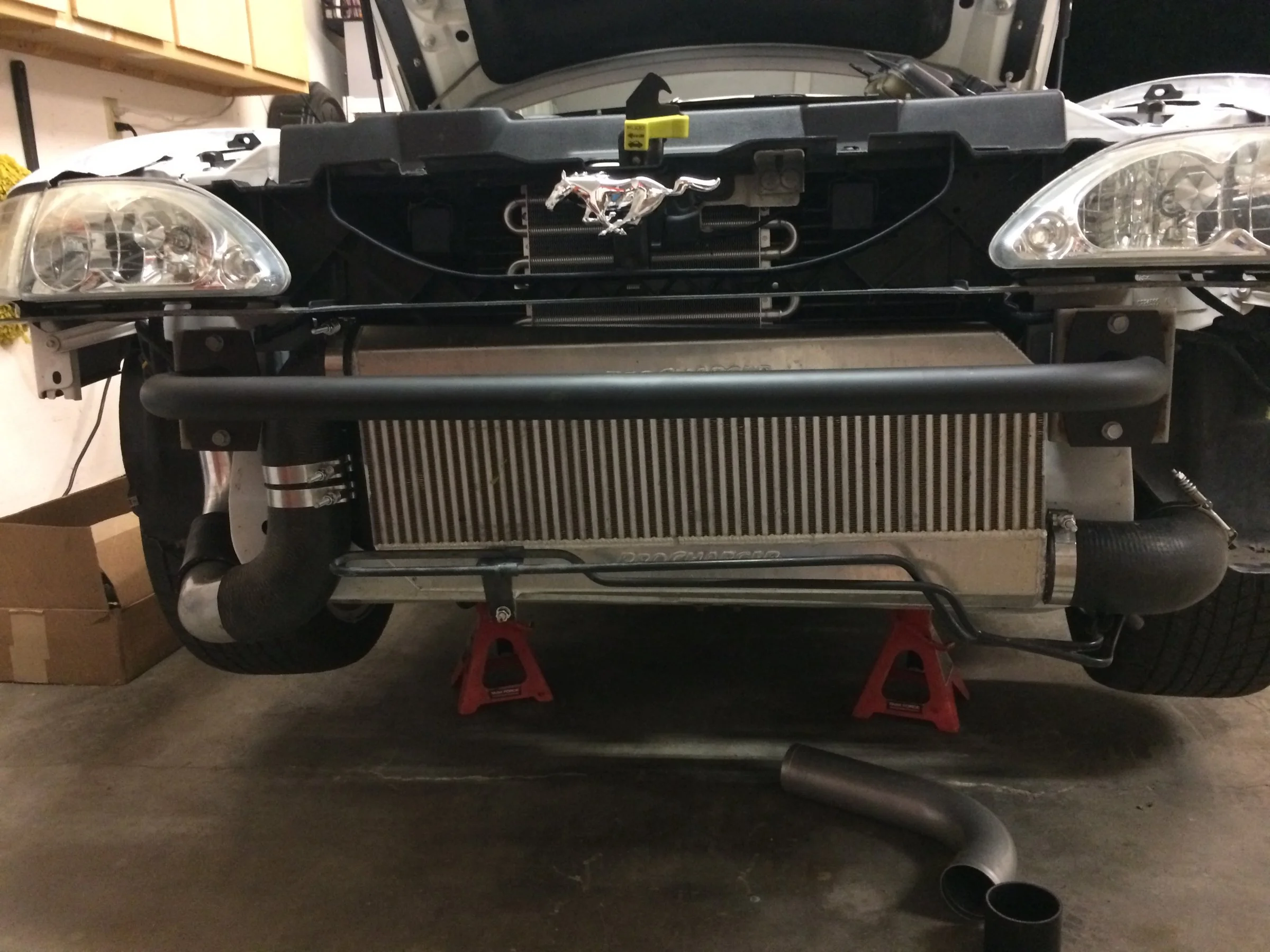

I also got the tubular front bumper mocked/temp installed. I wasn't thinking at all but obviously I loose my fog lights with this setup so I'll have to fabricate a bracket to mount them to the same place the bumper support mounts too. No way I'm giving up the fogs, I think it makes the sn cars look killer with parking/fog lights on only for evening night shots. I'm not too concerned about the weight as I did the tubular bar for air flow and not weight savings.

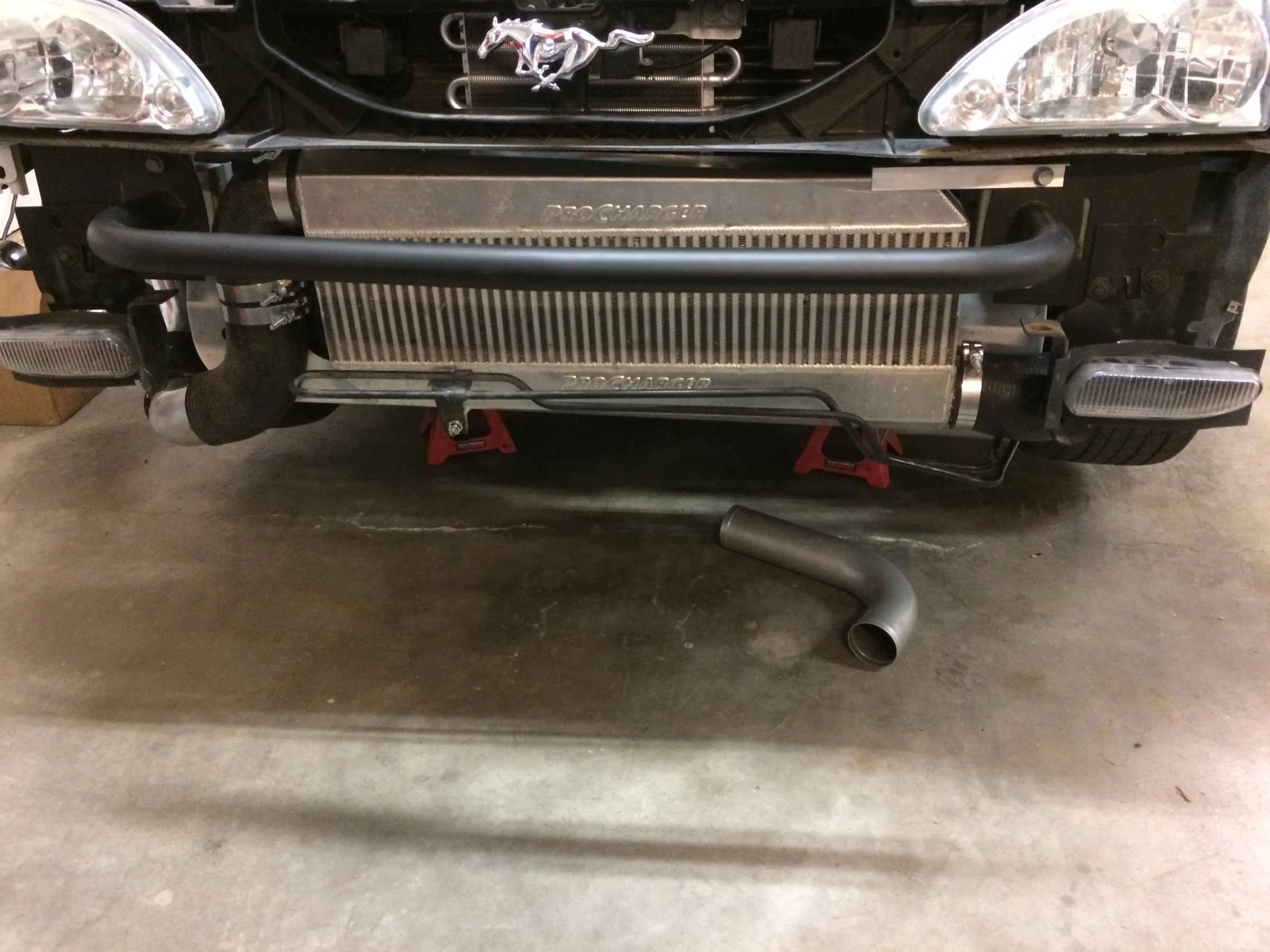

I made some fog light brackets last night. I wasn't a fan of loosing them even though it added some weight back to the front end.

The intercooler is killer looking. The sn bumpers really don't show much if any of it. You have to know it's there in order to see it. It tucks in there so nicely.

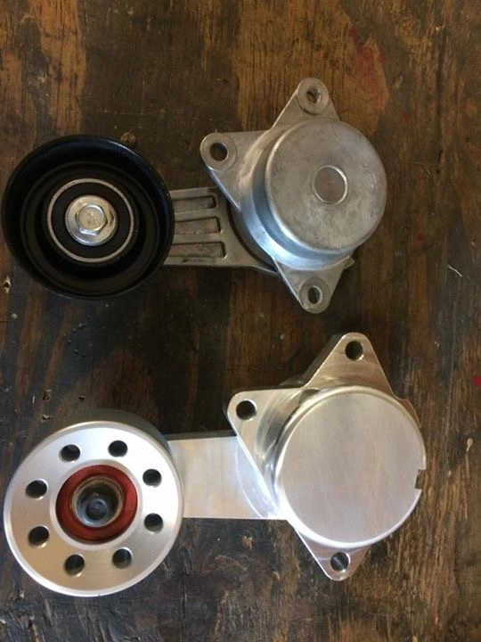

This gem finally showed up today.

And as expected the spacing is different so I'll have to do the whole belt alignment gig again

Well we got the spacing as accurate as we could. Holy crap is this tensioner soooo much tighter than the stock one. It had me shaking holding it open while my buddy fought the new belt.
I took it for a test drive. Flogged it. Made some boost. Let off a few times to see if it would kick it and so far it's good. But time will tell.
It's a dang shame that nice piece is hidden in the motor. Lol. For it's price you want to show it off.
