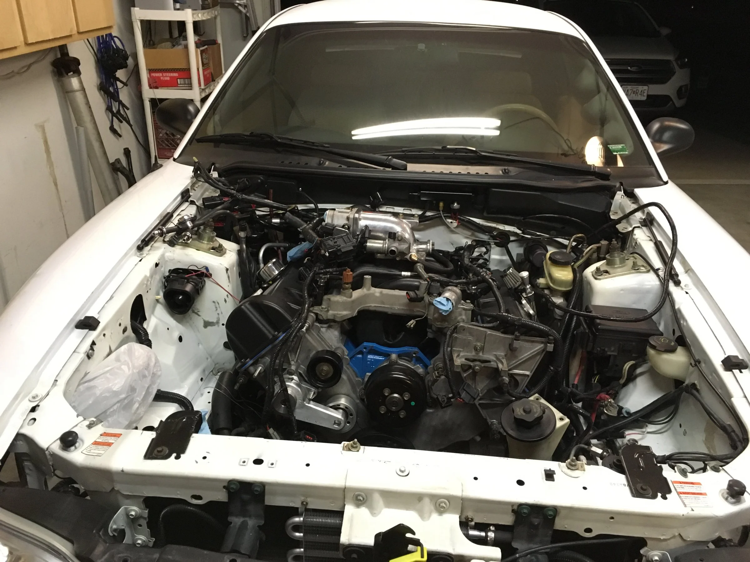

Progress. Lots to do still

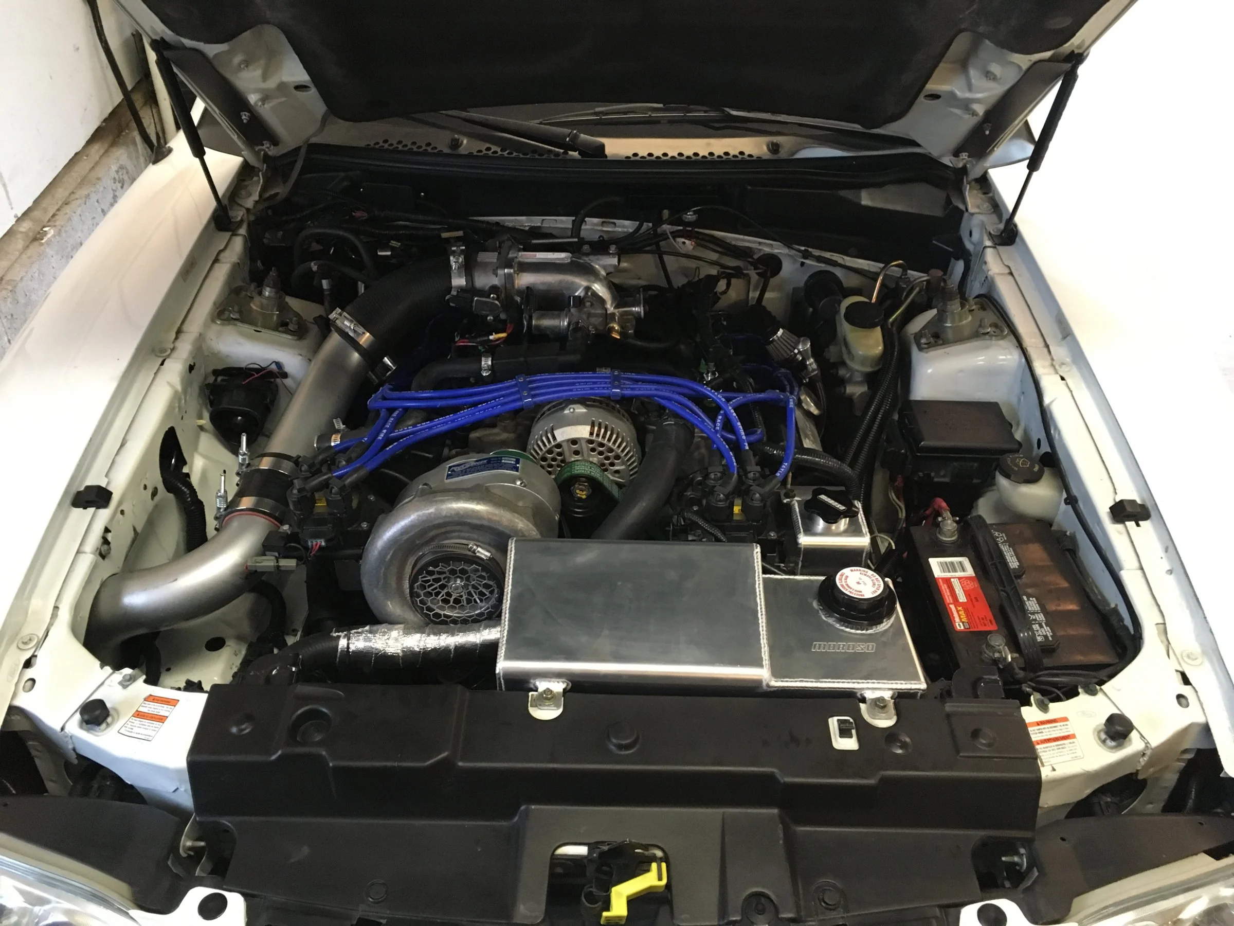

A few pretty upgrades as well. I love the metal tanks and how they look too bad they are ridiculously priced.
My speedo doesn't work so we think it at the teeth off of the gear as I'm 99% sure everything is hooked up correctly.
I also need to adjust my shifter or something as it doesn't have a positive feeling getting it into first gear.
Overall things are working good.
Yesterday was stupid stressful. Our first start it had zero oil pressure. So after reverse filling the system throug the oil pressure sensor hole we were able to reestablisb oil pressure.
Reactions: Mattstang04
I'll be calling Monks this morning to get a dyno appt.
I've got to get an alignment and we broke the vss in half when installing (oops). I was able to get a new one locally but I had to order the speedo gear from LMR, it won't be here until Wed.
I also need a new battery, I've been limping this one along for far too long and it's beyond the point of being reliable.
All those things are very minor considering 3 days ago this thing was a roller in a million pieces. I was able to take it around the block a few times. The converter lock up and OD function work perfectly (manually controlled by me). Funny thing is out of habbit the first time I moved the car I stuck it in D (third) already forgetting it's now a full manual valve body. doh.

Well I've done all I can do at this point. New catch can installed due to the cam cover filters were leaking some oil (A bit more blow by on this engine due to ring gap, or I f'd something up lol), trans leak (at the lines) is fixed, wide band installed, all gauges working. Car moves around good. I've got a spare set of plugs in the trunk, a set of stock coil packs (has screaming deamon on it now, I think monks wants to dyno test both as he thinks the stock ones will make more power), spare belt and t bolt clamps as well. All items off the check list seem to be in working order and I've put around 100 miles of just put put time around town on the car since we got it all back together. Trans works (thank God) and I'm ready for my dyno appt tomorrow.
