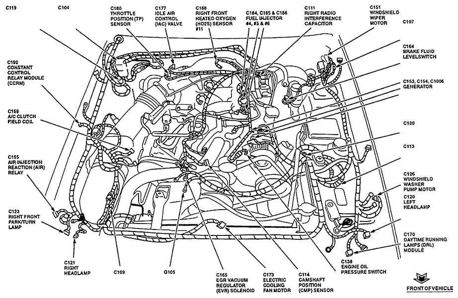

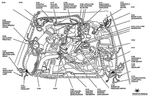

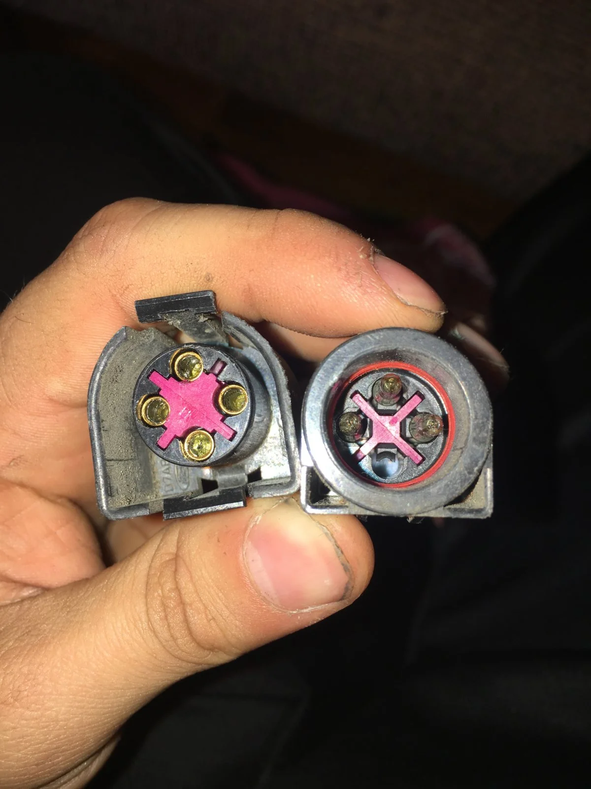

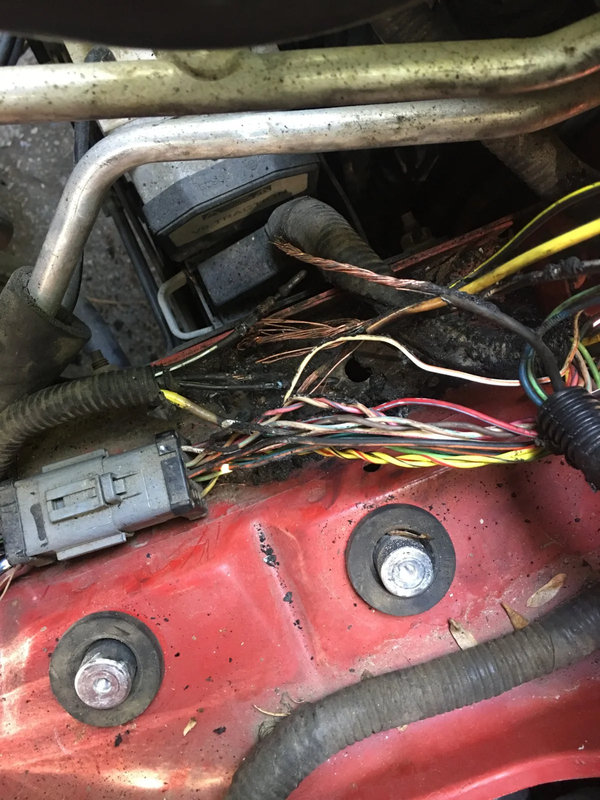

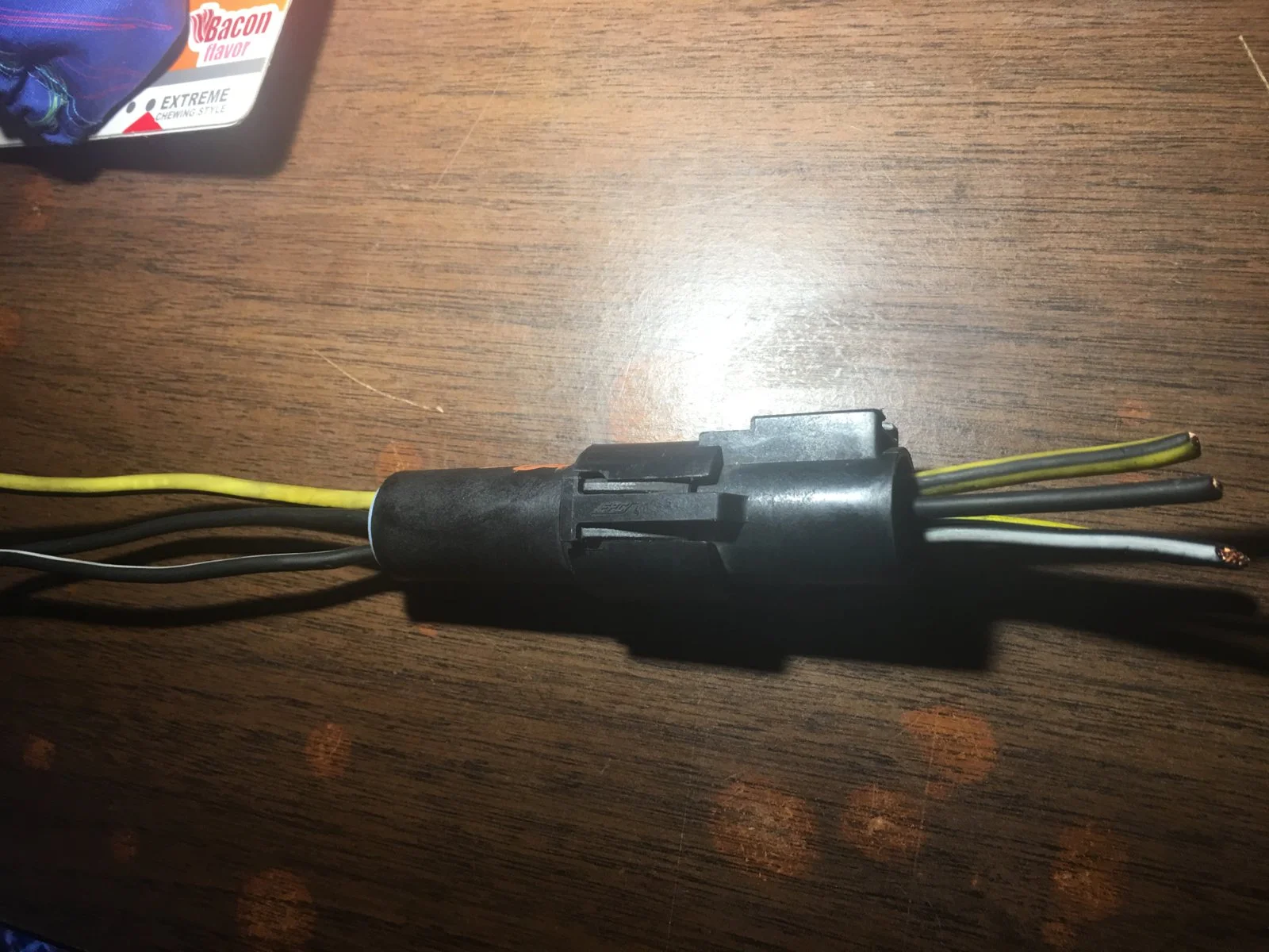

Can't find this connector anywhere. One wiring diagram labels it as C109 but i can't find any other reference to it. It melted in my car because my cold air intake pinched the wires. I pulled one from a junk yard V6 Vert but it has 3 wires leading into 4, while the car has 4 into 4. Utterly confused at this point. The larger yellow/black wire is hot all the time with ~12v. The black/yellow wire i traced into the AC compressor.

It might help to post pictures of the connector's face.
Are there any salvageable pins from the old connector? I'm wondering if the pins from the new connector were de-pinned and the old wires re-insulated with heat shrink tubing this could form the basis for a repair?
