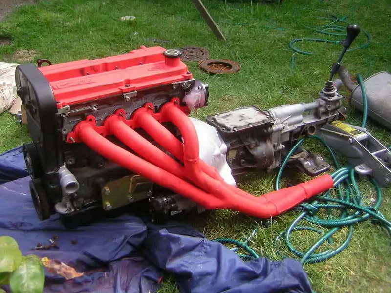

Worst of all is the head. Second to that is the fact that a fully dressed 2.3 is maybe 50-75lbs lighter than a 5.0. Why Ford messed around with the Lima for so long is beyond me....it was old and outdated 20 years ago.
A Volvo head alternative is a Duratec 16v engine swap. There are places that sell adapter plates and I think they varied in power between 140 and 150. Some are also aluminum blocks.

Yeah, there's nothing wrong with the shortblock, but everything above the pistons is, IMO, bleh. I won't deny that lots of people have made lots of power with iron 8v heads, but it's a lot more difficult than with something aluminum that flows 220+cfm out of the junkyard and isn't guaranteed to be cracked. Just my opinion, not gospel or anything.
I think I'm getting the FWD engines mixed up. I think the Zetecs are iron blocks and the Duratecs are all-aluminum.....either appears tobe a good option from what I've seen.

Look what I dug up in the bowels of my computer:
I'm not sure what transmission that is....I think it's out of some Euro Ford. This photo came from a UK site for Zetec RWD conversions.
