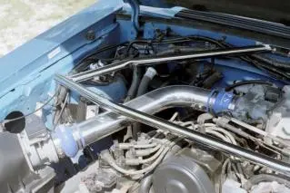

yes I see this post is a year old ,but here is a pic of my cai. on my 92 2.3l. its made out of 2.5 inch alum. bent into a 62 degree bend.

here are some pics installed i hve done three of these and they work great.
