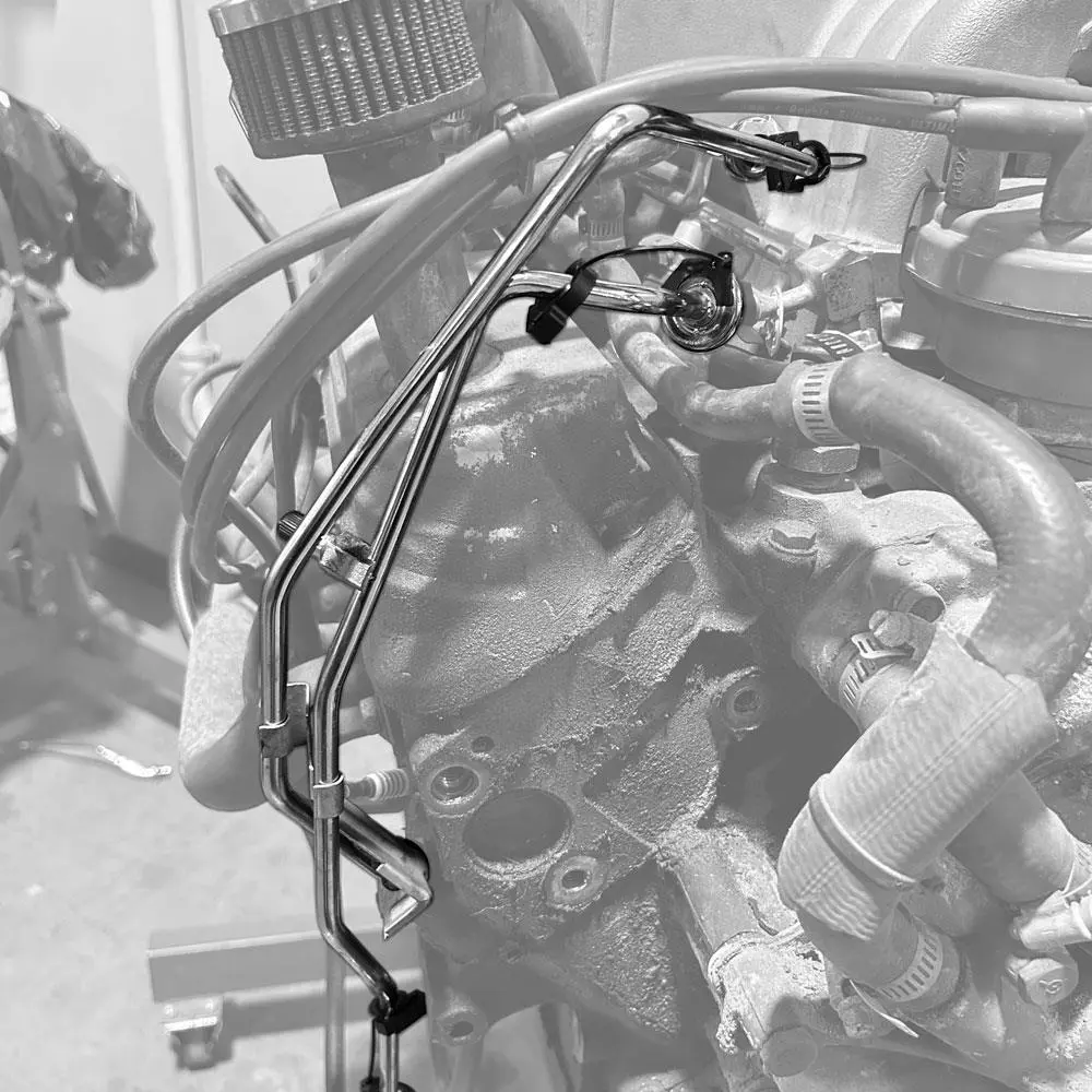

So you will need to build a crossover line which can be done with NPT to 6AN hose fittings and some hose. To adapt from the after market fuel injector rails to the stock lines I would remove the chrome hard lines from the stock fuel rails down to the lines. These are what I am talking about:
You will need these adapters to go from the stock lines to 6AN (other companies make them as well):
Really from here it depends on which regulator you are going to use and where you are going to mount it as to how you plumb the rest of it up.
