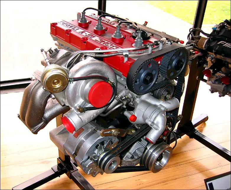

if i was living in germany.. i would swap in a Ford Sierra Cosworth engine in... Its much better then a 2.3T ....
DOHC turbo cosworth mustang......:drool:

I found a Cosworth engine but it's a 2.9l V6 24V DOHC.
Plus it's non-turbo.
I believe it's out of a ford scorpio.
Puts out something like 175hp.
How common is that cosworth turbo engine you were mentioning?
