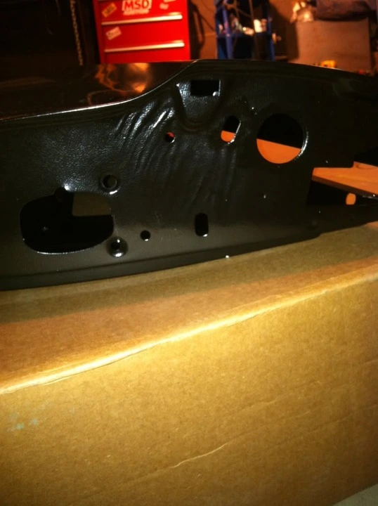

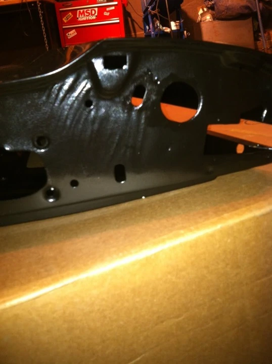

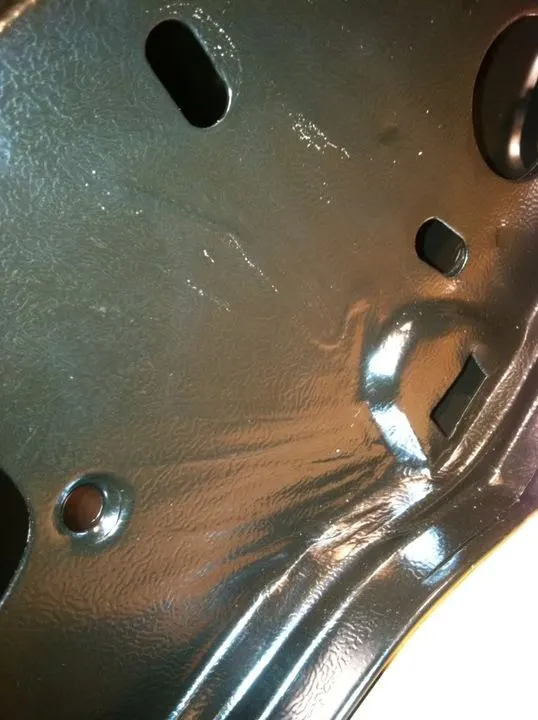

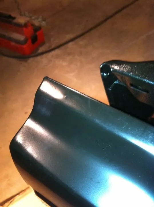

They are a little bit wavy in the door jamb area next to where the latch goes, but other then that, they look pretty good. Is it common for them to be wavy in the jambs? The skins look nice, the folds around the edges are clean, they look good other then the waves.
It's no problem, just take any of my advice at your own risk! As far as the waviness goes, well, there are bends made in those areas and it don't show, and it should be textured, so you will probably never really notice it. You will just have to see how well it lines up when you bolt it to the car. Here is a link to a vid that can help show how to line up the doors (also lots of other helpful vids on his site)

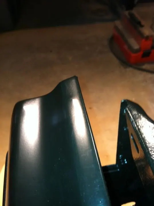

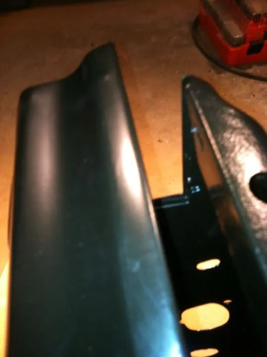

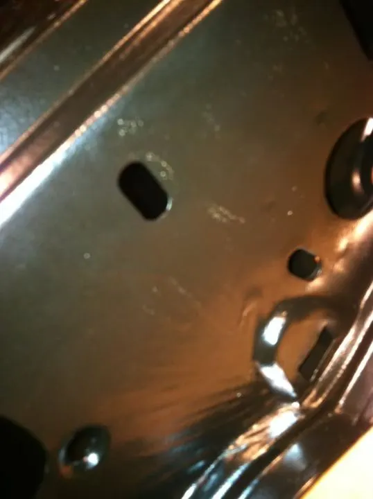

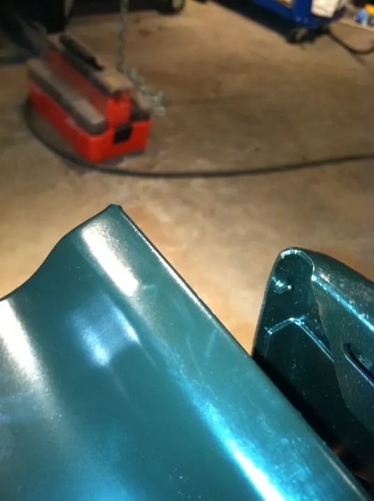

Ok, should I be miffed a little? Or glad I have new doors.
One door has the "beebee" sized bump in the chammel by the window, and both doors have the wrinkles in the door jambs, heres some pics, look forward to some input.

I`m just curious if this is normal or should i be mad, I`ve never ordered doors before.

Sounds like were in the same boat. This is all new to me too. I'm replacing my rear quarters and need the doors on first to get the proper alignment. I am relieved seeing your pictures those don't look bad compared to some of the horror stories i've heard. I will take pictures of my doors when they show up and post on here.
If theres anything ive learned in the 4 cars and 2 tractors Ive built is that you get what you pay for. I wouldnt worry about those bb sized bumps, you can take 2 ball peen hammers and get that out quick and a little priming and sanding will never know it was there. All aftermarket body panels have their issues. They are very attractive because of the low price, but after you get a body shop to straighten out all the flaws, you could have just bought the good stuff to begin with. Those jambs are very wavy....mine arent that bad, if it bothers you send them back, CJPP is usually good about returns, but if it dont...then dont worry about it. I would try to see how well they line up, thats would be the deciding factor to me whether I kept them or not. I dented my new door beating on it with the palm of my hand trying to get it lined up...but its just one of those things...a little loving with a dolly and some coats of primer and you never know it happened.
Just finishing up paint on my 65' with the original Ford factory doors (not repos) and both had the same BB, so in some ways it is factory original. :-) On my doors a hammer wasn't very useful (your trying to bend an inner structure too) so a little body filler was used to build up around it as it was a little much for just primer.
I consider that problem to be minor and I wouldn't be surprised if there are other places that also need a little TLC. Do as Robbz suggested and do a fit before condemning them as the next door may have other issues.

I wasn`t really condemning them, I`m just curious if this is normal, I think with a little TLC they`ll be fine, the waves in the door jambs don`t bother me, again I didn`t know if that was normal or not
