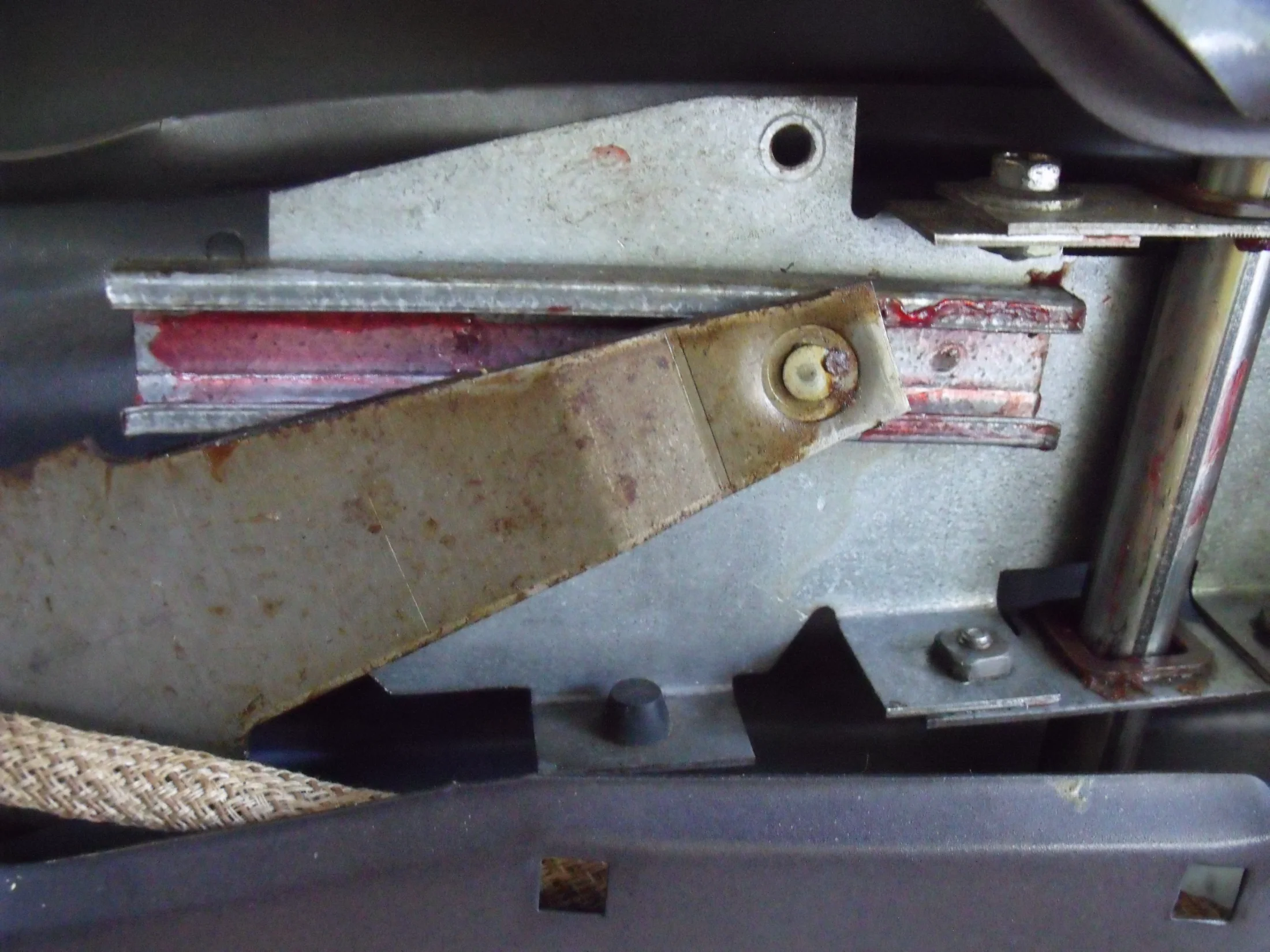

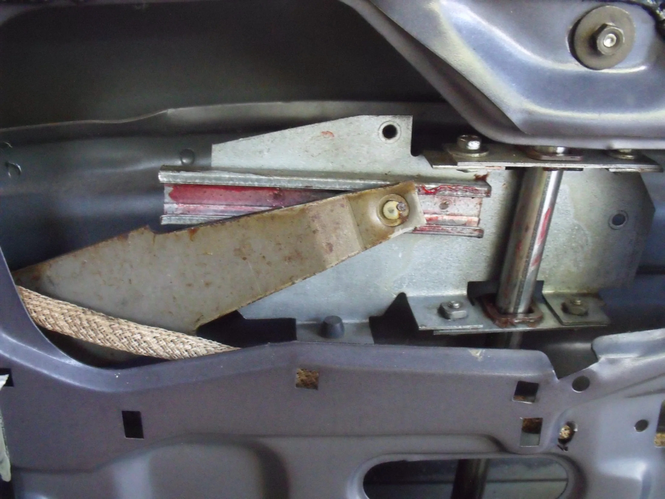

That looks like the part that is riveted to the regulator
arm and fits into the horizontal channel in the pics I have attached...
There is no glass in the door I took these pics from......
If your really really careful, I would think you could drill that out, slide it out of the channel, then slide the new one in pulling out the regulator arm to slide the " stud " part of the new part in the hole..... I would even cut down the stud just past where it comes out of the nut
The glass will fall to the bottom of the door, so you might want to stick some towels or wood in there to " set " the glass on OR have someone hold it for you while you do this....
DO NOT hit the glass with the drill bit OR let the edge of the glass hit any metal edges inside the door.... The edge on tempered glass is its weak point...

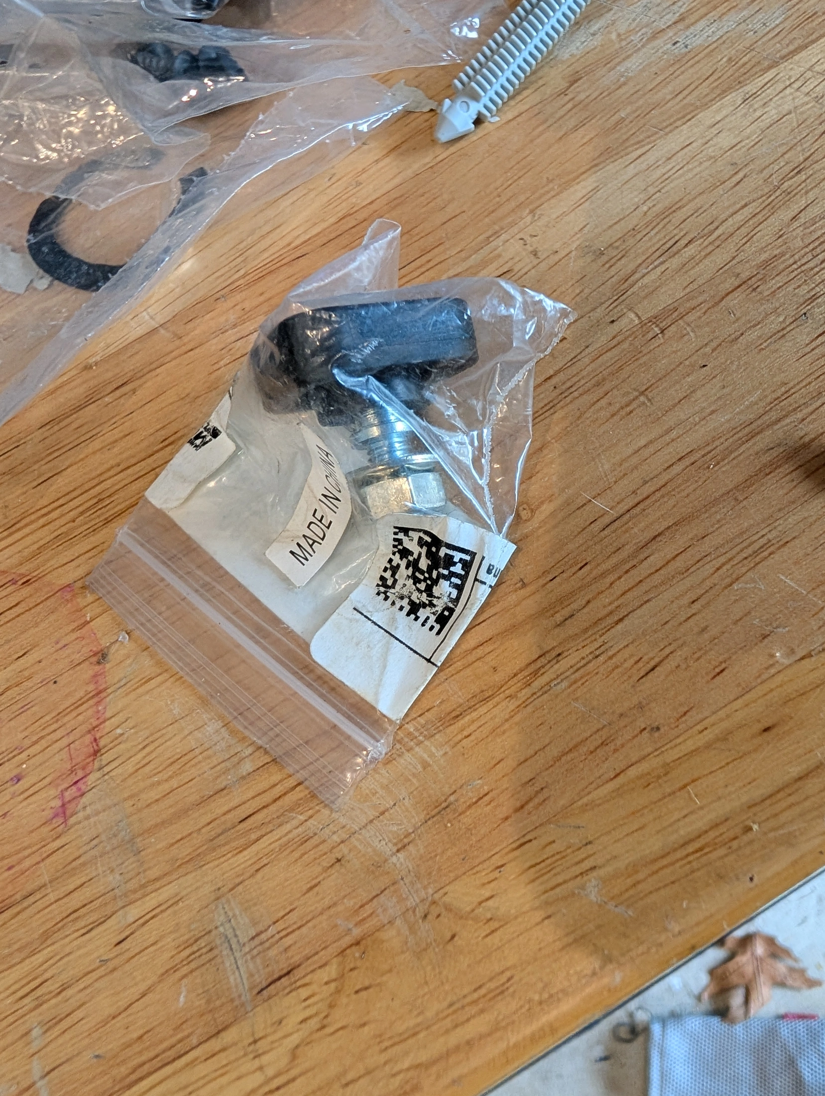

The aftermarket ones just have that threaded stud no rivet. Do you have to source a nut to attach it with or does it screw in?
I'm pretty sure mine came with the nut, may have been in a separate bag like quite a few LMR products come. I still have the other one, i'll look.
