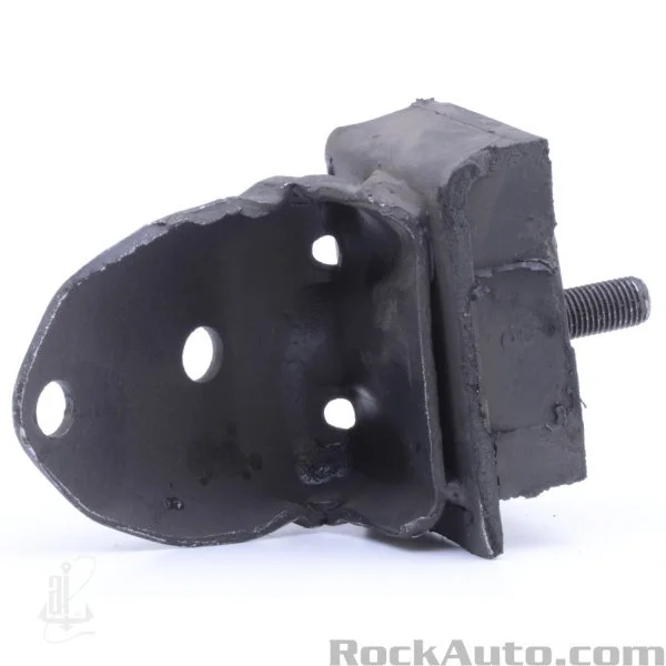

200 CI L.. It’s Single Stud.(Below) National Parts Depot (NPD) should have what you need, there’s also adjustable’s available. Hyperlink below.

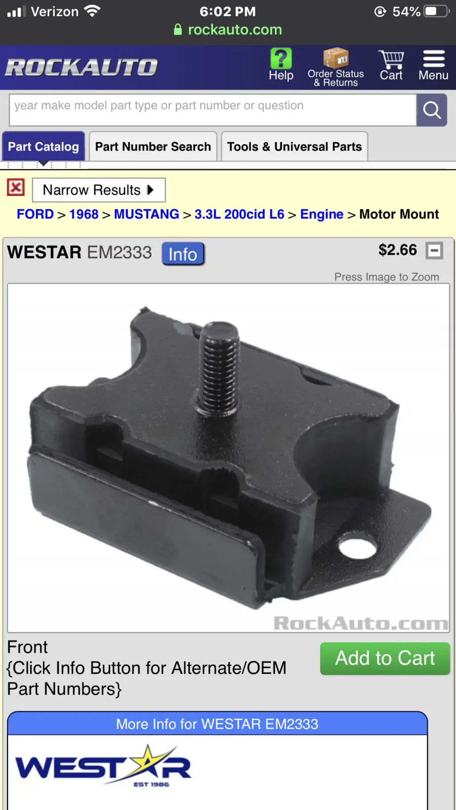

Hi,
The confusion was the year of the motor, a 67’-69’ runs the block mounting plate/isolation mount as (2) separate pieces, vs the one pc.welded together (64.5--66’). Being a motor swap into a Rambler, the (2) pc. 68’s 200 CI mounts are more mod friendly. Although similar, the mounts are not the same.
Thanks for bringing that up, posting more info allows clarity for the next guy/gal to get definitive answers.
Best!
