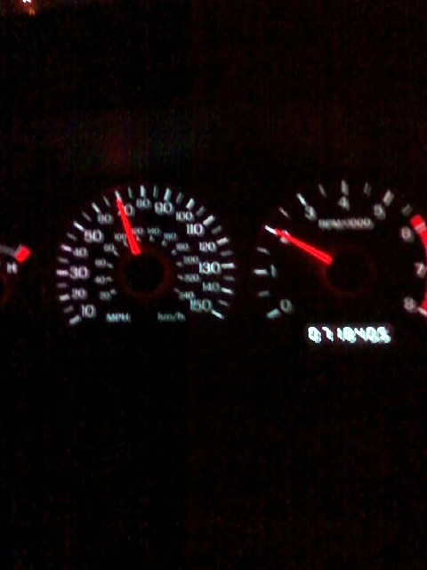

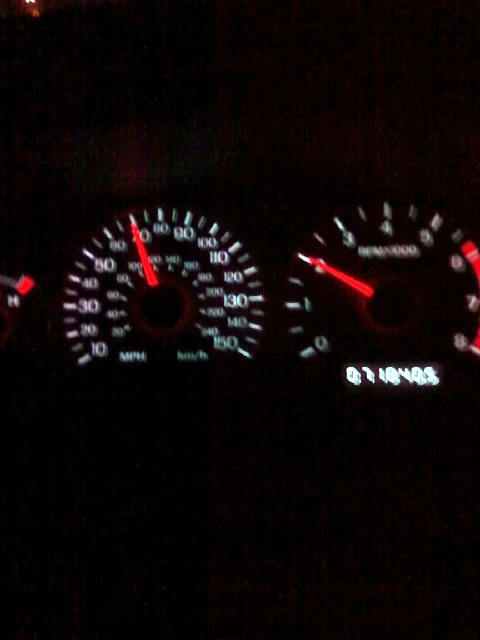

Very cool thanks! according to this data im running stock 3.27's , im right around 2000 rpm @ 70mph (running 245/45/17 tires).
I guess the verdict is better shifting on my part? lol

(Shot I took tonight):
