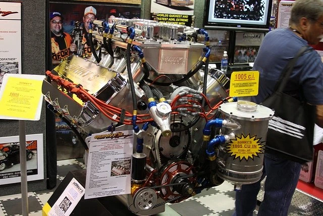

Drop a moutain motor in your car like this one lolol it's rated @ 2150 hp
