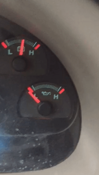

2. The oil pressure gauges keeps going up and down when driving

2 and 6 could be related. Could be your oil pump is going out. The tapping your hearing could be lack of oil flow to the lifters. They are hydrolic and need oil to keep them pumped up. Lack of oil will cause them to "collapse" and bleed hydrolic pressure off of them. A new oil pump and a good engine sludge purge will help

1. Oil pump is fine, i put Rislone Motor Treatment in the oil, still tapping, but I'll give it a chance to work through the system. Oil pressure gauge stills acts funny, maybe its just the gauge??

So the engine tapping is still there? Well it concerns me too. Is your oil pressure gauge still flaky? Could still be a bad pump or worn out lifters. A good mechanic can tell u that. Brother I would at least take it somewhere for a diagnosis. Sorry I can't be more help on it. Pearl02.
Attached some files.... i am going to the mechanic as soon as my wallet gives me the OK :(
