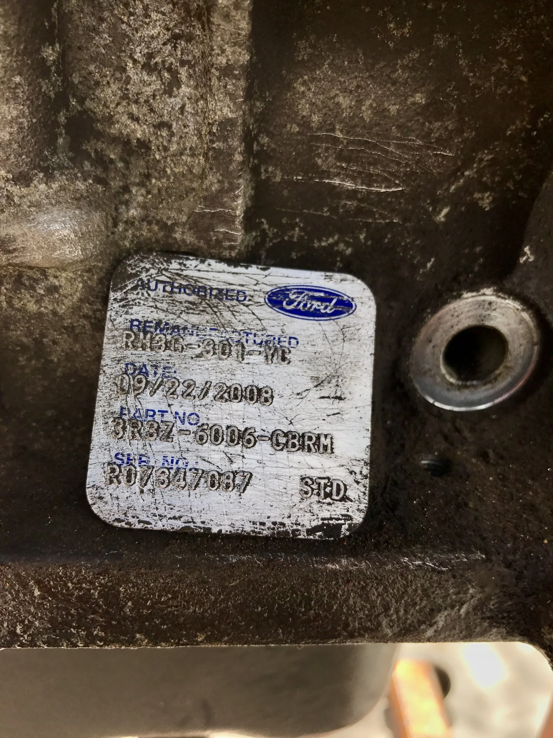

Ok so I was looking at my heads today and I recall reading somewhere the early-very end of 2003 models came with the 4 thread spark plug heads. The 4v that came out of the Mach I bought has a manufacturing date of 06 of 2003 so with that being said I should have the 4 thread heads. I was very surprised to find out I didn't and had the 9 thread spark plug heads, which I'm pretty happy about. I was aware that in mid November of 2003 is when Ford changed the thread count and actual head itself to fix the common head tick in the 03 model Mach 1s and that they marked these new revised heads with a blue spray painted mark on the driver side. I do not see this mark at all on my heads so I am confused if I have the revised heads or not because of the 9 threads. But then I found this tag strapped to the lower part of my block. It's a tag from Ford that has some serial codes and a "remanufacture" date of 2008? I was thinking maybe under warranty the guy that had the car before me got his heads replaced with the newer revised heads and that's why I have the 9 thread count? Just a thought, anyone have any more info on this? Thanks
It is possible the owner of the vehicle before you may have had the cylinder head/s replaced at one time maybe under warranty. Not all the 03-04 Mach 1 cars had the cylinder head ticking issue. To find out for sure the part number on the side of the cylinder head in your pic is indeed a Ford part number. If you go to a Ford dealership parts department with the part number they can tell you for sure if it is the revised 4V cylinder heads or not.
