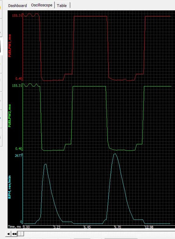

Here is one thread from trying to troubleshoot a start and stall issue. Only after downloading the software and buying the adapter did I figure it out that my tune was in fact corrupted and I needed a new tune. None of the parts I replaced needed replaced to begin with. The software and adapter burns linked above gave me everything I needed to observe, troubleshoot, identify the issue, then remedy the issue.
https://www.stangnet.com/mustang-forums/threads/99-gt-no-idle.907196/#post-9148062
The tune for my maf sensor was incorrect. This can happen after upgrading to a different maf sensor which in my case that's exactly what I did. Or by drastically changing the airflow or fuel system, which would require a new tune. Remember maf sensors are used for measuring the amount of air coming in to the intake. My tune got corrupted in my case and I didn't realize this until after replacing my IAC, TPS, and maf sensor. I went through weeks of testing each individual piece according to my ford mustang manual thinking I also had an electrical issue. If I had only downloaded the software earlier and reviewed the maf airflow to voltage and a few other graphs I would have had this problem solved much earlier without throwing money at it. Ill post some pictures of my before and after using the software to diagnose my maf sensor issue. It just needed calibrated which any tuner can do that owns the software.
Below is a picture before the tune. Notice how much distortion there was on the bank 1 and 2 fuel trims. They were super high and super low. Once I posted this on this forum @a91what was able to tell me my tune was off. All for 30 bucks I solved my problem and knew what I needed to do to fix it.
The actual forum of my problem and how I resolved the start and stall issue can be seen below.
https://stangnet.com/mustang-forums/threads/sct-advantage-iii-racer-pro-software.907433/
