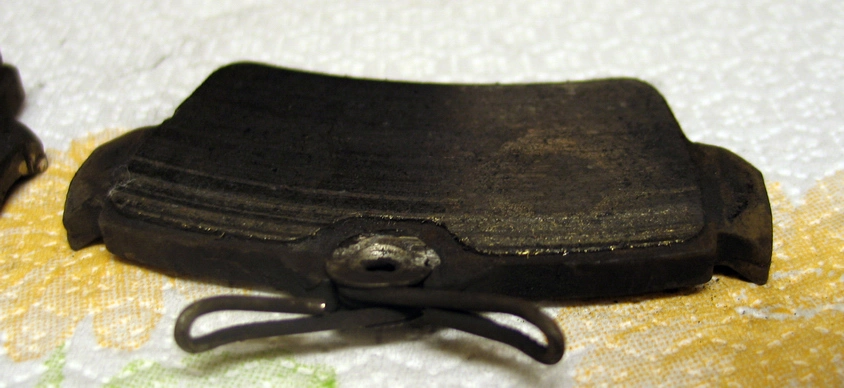

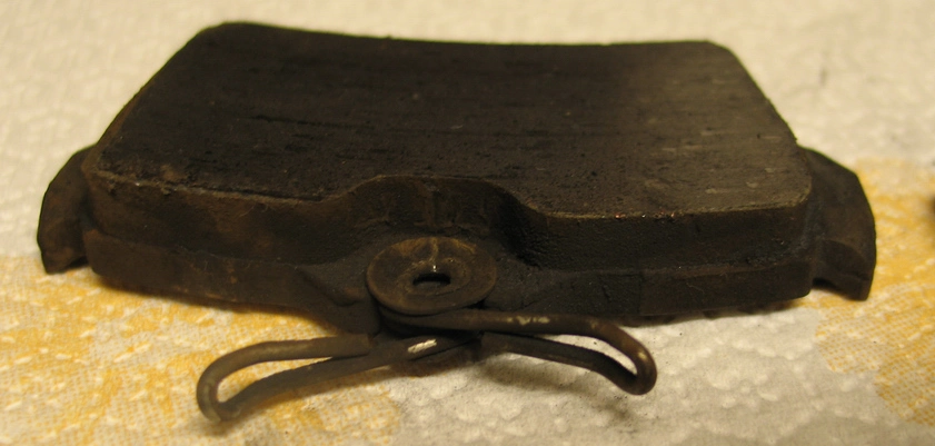

I recently started hearing some squealing from the rear brakes and figured it was time to replace the pads.. Well both the driver side pads still had plenty of meat but on the passenger side the inner pad was worn *all* the way down to nothing but the outer pad was still had plenty of meat left, Any ideas what can cause this? Do I need a new caliper?
Thanks.
Here's a couple pics I took:
Inner pad:
Outer pad:
if i had to guess, its due to the design of braking systems?
Only one brake pad gets pressure applied to the rotor, and thats the side with the pistons inside the caliper that cause this force.
In my experience the inner pad always wears more than the outer, although in your case it is quite extreme.
Braking occurs like this
| = brake pad
() = rotor
Q. So why would the inner pad wear faster?
A. Its engineered that way.
as far as wear from driver to passenger side. you should feel your car pull while braking if one of your calipers were to be malfunctional. The condition of your rotors could also have an effect on your pad wear.
Are those pads with a lifetime warranty?
as far as wear from driver to passenger side. you would feel your car pull if one of your calipers were to be malfunctional.
i agree that the inner does wear slightly faster than the outer, but its not supposed to be THAT bad. also i dont think he would really feel a pull to one side because it was a rear wheel, not a steering wheel.
i would guess you need to check the slides make sure they are greased up really well. if the slides aren't properly lubed they cant equalize the load and cause improper wear in the inner pad where the piston pushed on the pad.
like mustang50 said.... first thing to do is check that the sliders are greased up good and are moving free.
This would be my guess as well. Get yourself new dust boots for the slides. My wifes was ripped and the slide was almost seized not allowing the one side of the pad to release from contact with the rotor.
I cleaned the slides regreased them, put new dust boots on and haven't had the problem since.

funny you say that i just had the same thing last month, 3 were good 1 was flat, my pin was siezed in the caliper bracket, i got a new bracket and pins and all is good
This actually turned out to be my problem! 3 out of the 4 pins were seized so bad that we had to take both caliper brackets off (driver & passenger) and take them to a friends shop, The pins were bone dry even tho the rubber boots were still good, but he was able to get them freed up and re-greased etc.
I then cleaned up the sliders and put new pads in and everything is working fine now.
Before taking the rear tires off I noticed they wouldn't even spin freely at all even with force (yes handbrake was off & not in gear), The rear passenger brake had been stuck all this time which i'm sure was robbing some fuel mileage and power. But they spin fine now after fixing the pins.
