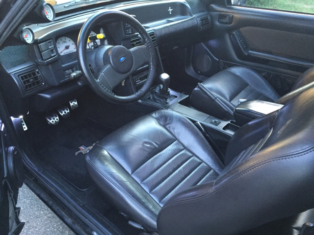

So i heard a rumor that the 2000 Mustang seats, fit right into our Foxbody Mustangs, mines is a 92. Can this be true ? Does anyone have any experience with this ? And if so, can you please share. Also i noticed in this picture it leans way back, which is ok to drive at time, but i also like to ride with the seat straight at time on long drives because it helps support your back better. Anyone know ? Thanks yo ...

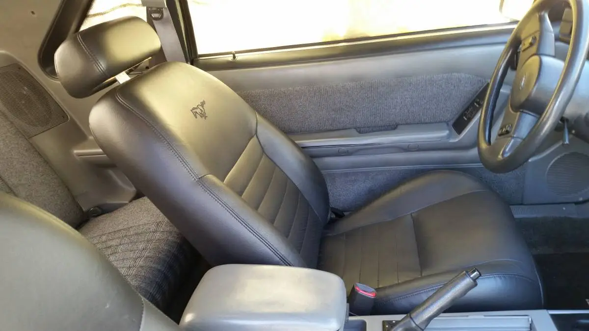

The fronts bolt right in. Then can be folded up further than in the pic to be pretty straight. I'm just tall so I tilt the seats in all my cars back. You just need to modify the power plug to make the lumbar or power tracks work. Or you can swap fox tracks on to keep them lighter
Backs need a little work. Seat backs are easy mod, but the bottom cushion requires some support to be built in.

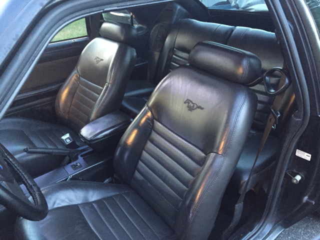

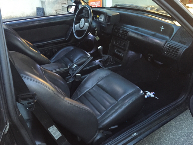

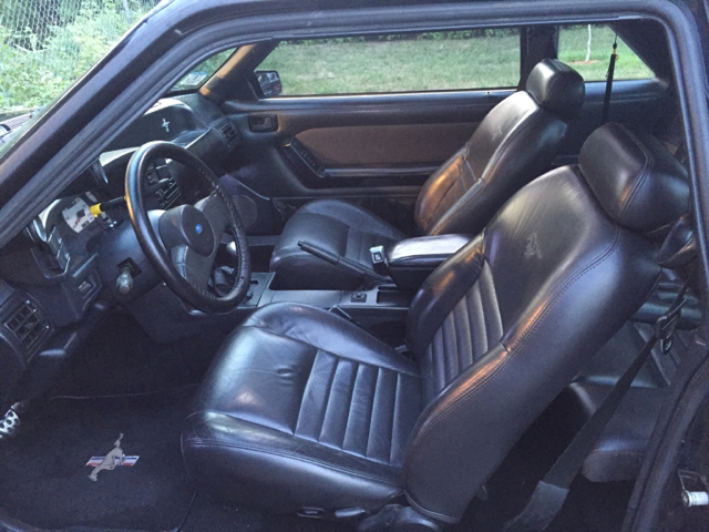

Seems like we get this question once a week. YES 94-04 front seats bolt right into any fox body. You will sit about an inch higher and need to jumper the 2 power wires on the new seat to the 1 power connector on the Fox Body plug. Rear seats require fabrication to make them fit. You sit on the 94-04 seats vs fox seats that you sit in.
Pics of 2002 fronts in my car before I sold them.
