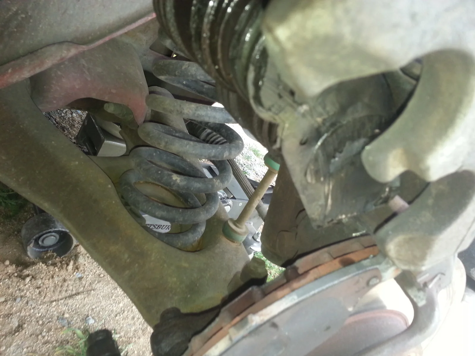

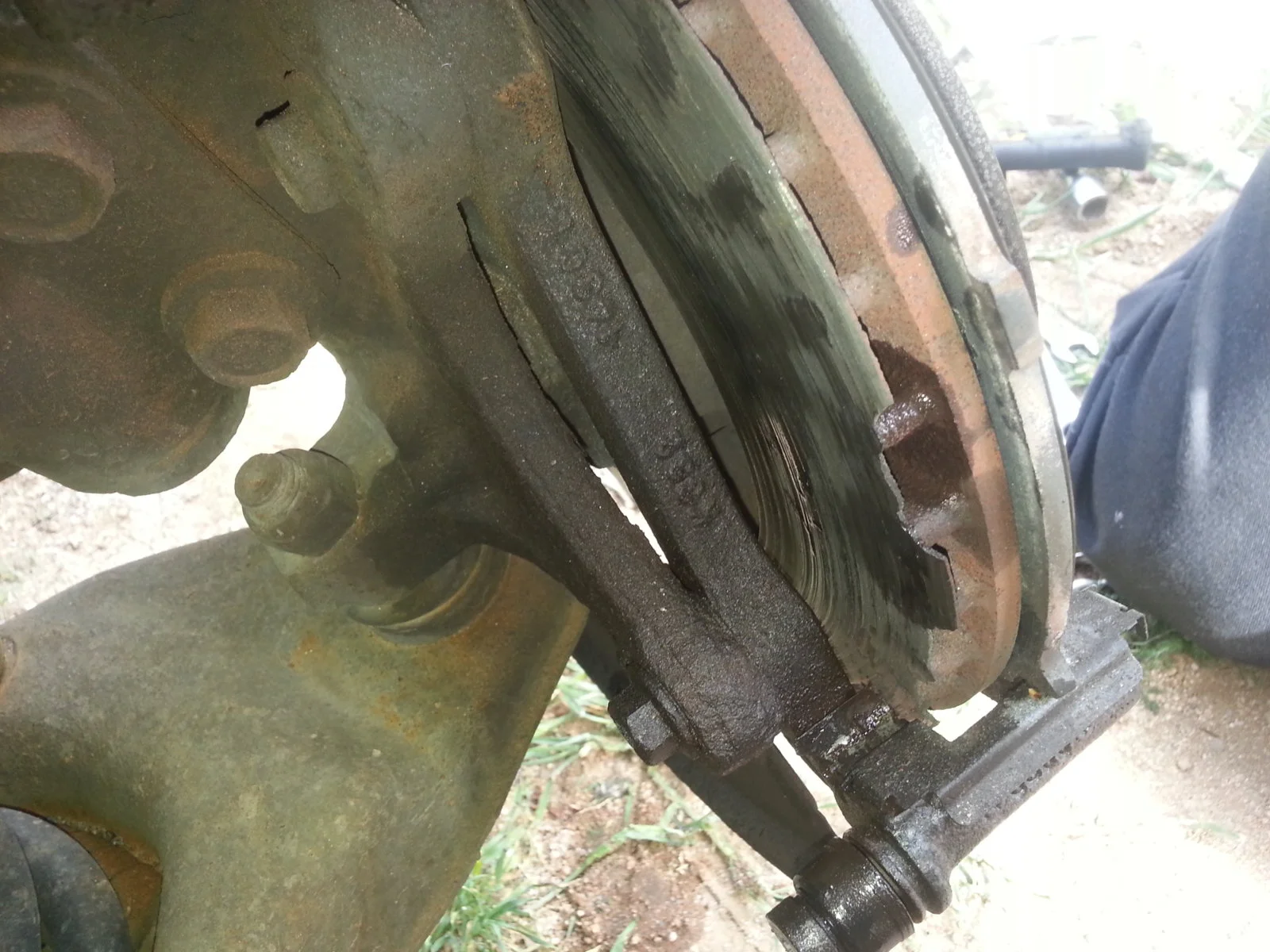

I paid 200 and it starts shakes heavy at idle and the front calipers ate through the pads and into the rotor, ha through the rotor too. Oil leaks coolant looked clean straight body.

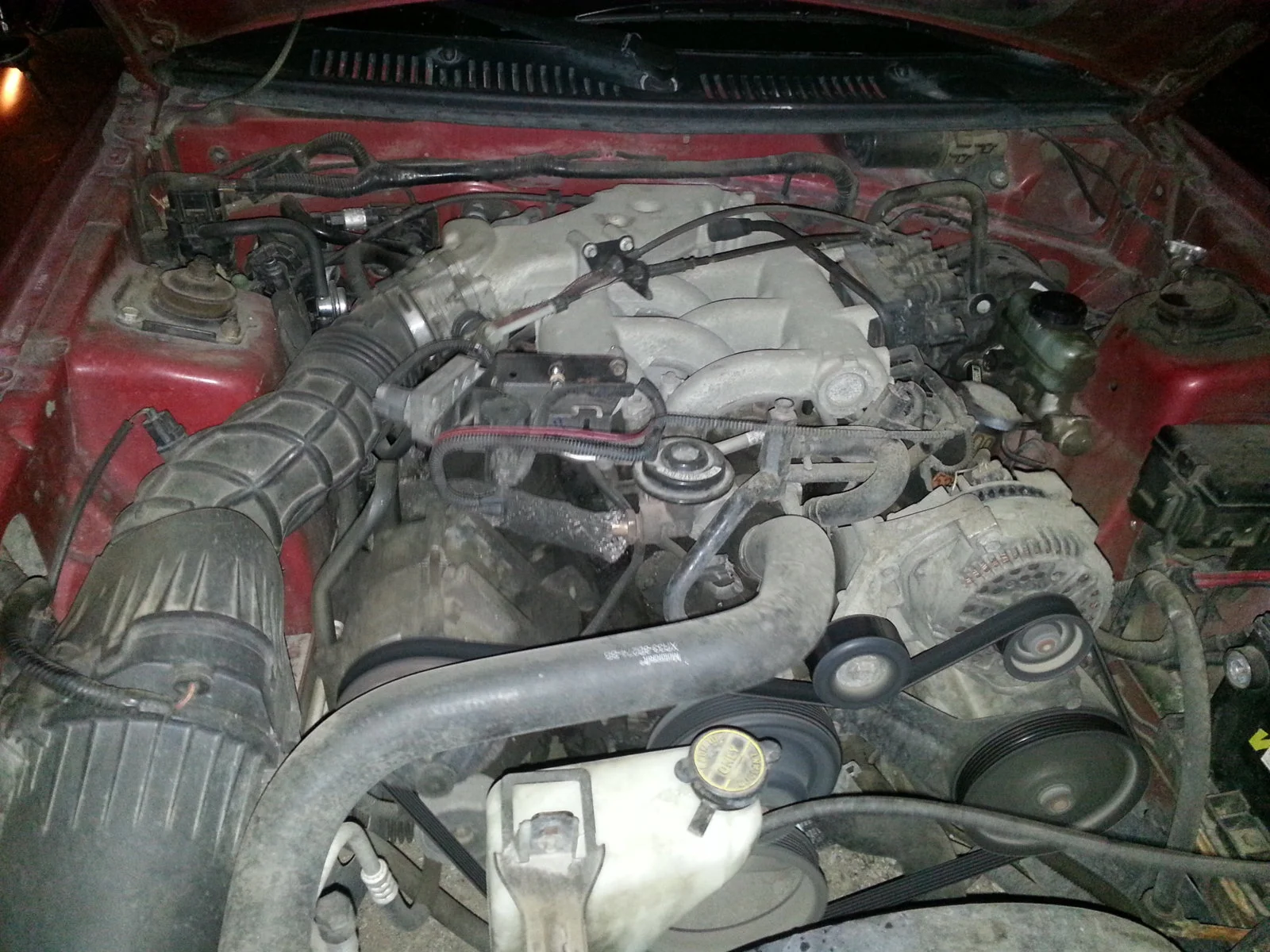

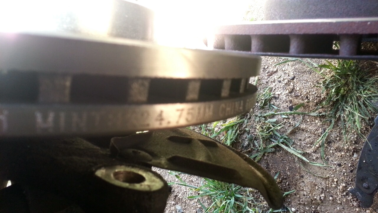

Little update used caliper installed, new rotors, and pads up front and I have pedal pressure now.
Huge cut through the 3 layers on the 1 cylinder plug wire and a couple rotted vacuum hoses.
Plugs were worn or gapped to .9.
Waiting for plugs and wires.
I pulled codes p 1409 and p0171.

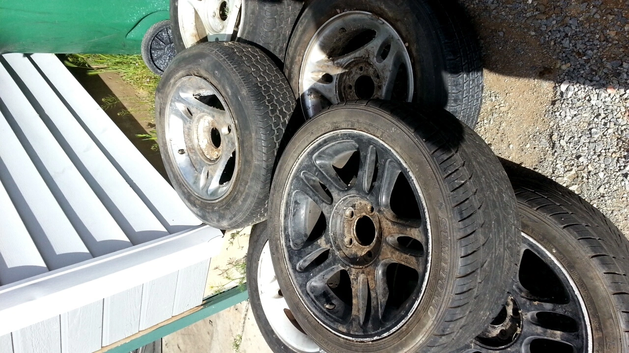

And picked up 4 base model rims and 2 gt rims with decent tires, for free!
Reactions: General karthief
Can you visually see if the harmonic balancer slipped?
Any timing marks on it? Or anyway to measure the ring gear against the counterweight or pulley?
Brand new plugs and wires still shakes at idle but is a little smoother than before
