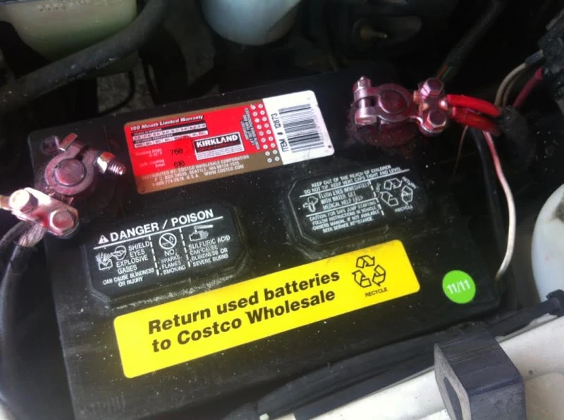

Again my battery terminal is heavily corroded, the positive terminal and there seems to be some moisture from it. Battery is from 11/11 itself. I have no expertise here; if pics help let me know.

As for the battery terminals, I just used a descent terminal from the local parts store with a clamp type connection to the existing battery cable. While it isn't the type of permanent connection I prefer, it is holding up ok so far. I just used a utility knife to clean up the copper strands before clamping it on, and a battery terminal cleaner to clean up the studs on the battery. Certainly, battery issues and low voltage can cause all kinds of problems on a modern car, so this is likely a priority.
I would definitely change out the terminals soon, especially if you're going to be doing work on the car that involves disconnecting and connecting the cables. When I bought my '04 GT used, I saw that the cables had really bad corrosion but unfortunately ignored it, since everything seemed to be running fine. One day the car just abruptly and completely died, with no symptoms or signs of anything wrong.
After much gnashing of teeth and rending of garments and an unnecessary new battery purchase, it turned out to be the corroded connectors. While refurbishing the car after buying it from the previous owner (who rarely did anything under the hood), I had to remove and replace the cables several times, and all the agitation was too much for the corroded wires.
I considered just replacing all of the cabling, but frankly I didn't want to have to deal with the hassle and expense if I could possibly avoid it.
Replacing the terminals was time-consuming but not difficult.

After removing the cables from the battery (negative then positive), I cut the ends back past the corroded part and stripped off about an inch of insulation. I slipped on the heat-shrink tubing, then soldered the cable to the terminal. Then pulled the tubing up over the exposed wire and used the heat gun to shrink it snugly. Then some grease on the terminals and posts, and reconnect the cables (positive then negative).

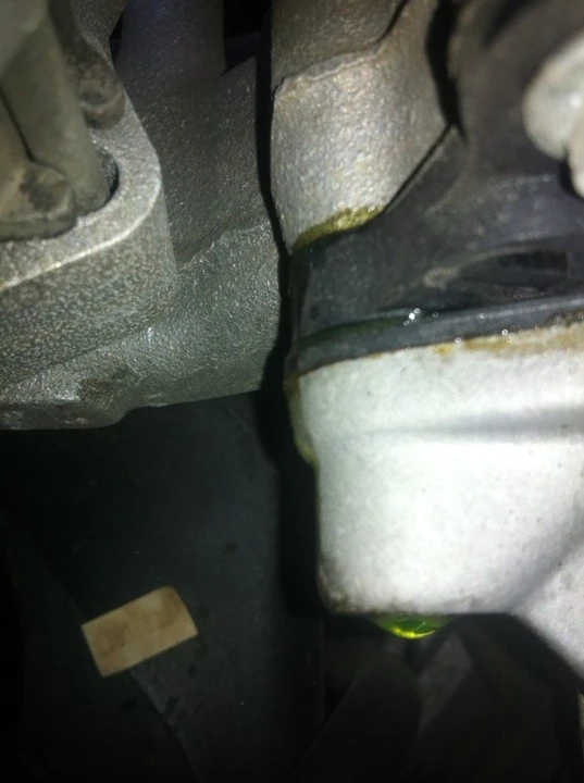

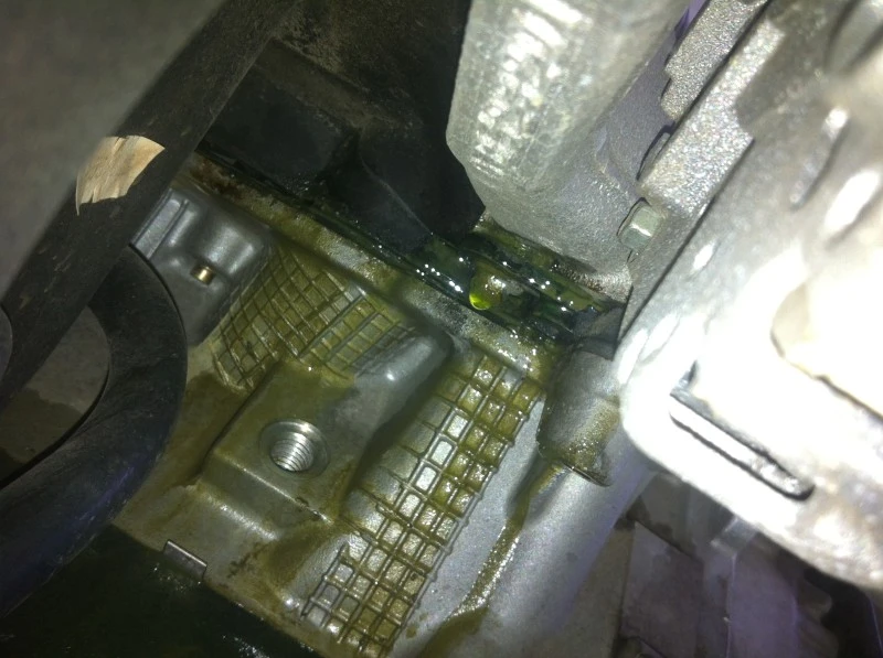

I still have a plastic manifold, it's bubbling and leaking out the front. They say they replace a lot of these here cause mustangs are common in my area....I have googled some threads and people says it's pretty easy just some important details involved. But if I get all I need I can save hundreds and do other parts too....they wanna charge close to $800 here but I really don't listen to shop managers unless it's a performance shop this is a reliable mountain view good for basic services.
Quick Update from today's Battery Terminal repair.......is that professional full replacement or a clamp semi temporary in your guys opinion.

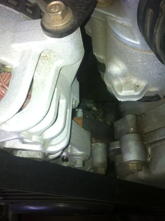

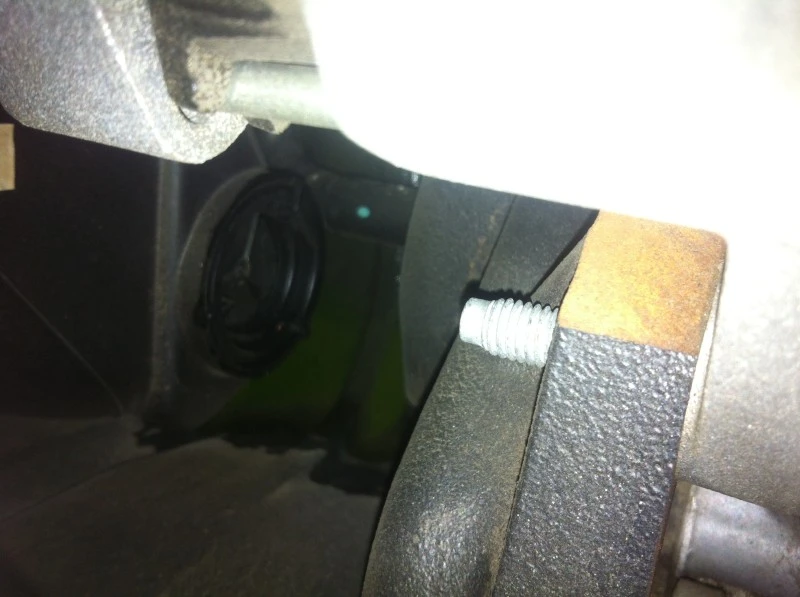

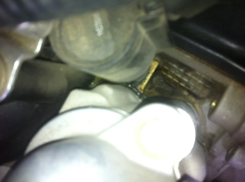

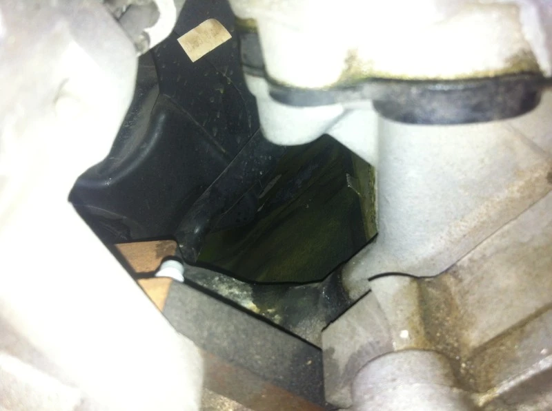

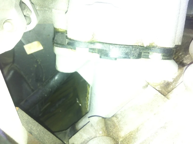

So it is & its still ruined as far as I know, which isn't too much unfortunately but learning. Pictures are not the best but once you remove the alternator bracket straight down behind it is where the intake is gapped & coolant is bubbling out of....

Here are more pictures of the leak; is it bad for coolant to sit there for a few days I checked on it and now the thermostat appears to just be dripping..... shoved my phone in there for some pics behind the alternator.
Just sitting there, the coolant won't cause any problem. Driving the car on the other hand could cause a myriad of issues, such as overheating or the risk of the leak getting much bigger and spraying something electrical.
