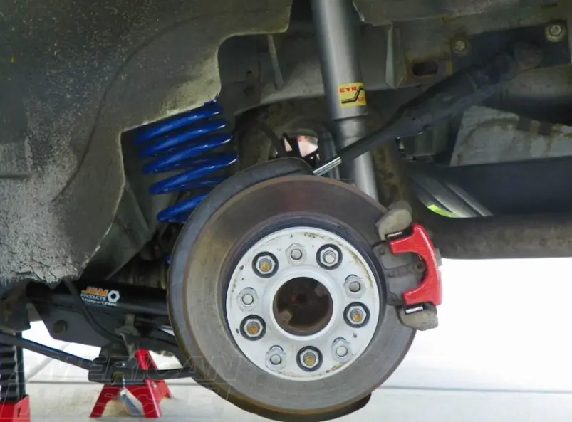

In standard form, Mustangs used a standard shock and separate spring in the rear. The spring sits on the control arm and fits into a pocket on the body.
Pics would help ID what you have
