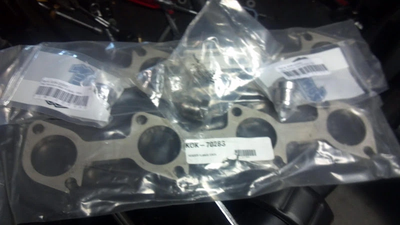

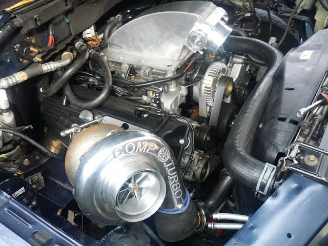

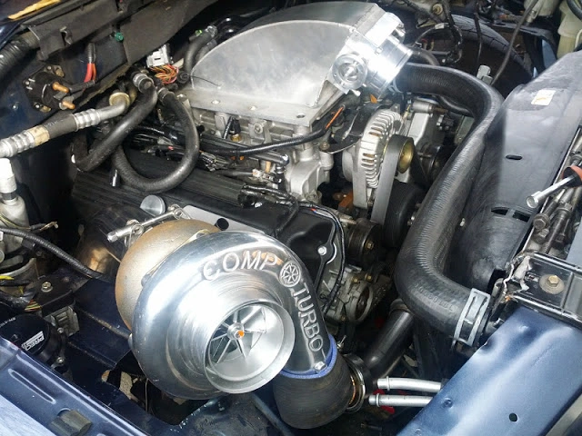

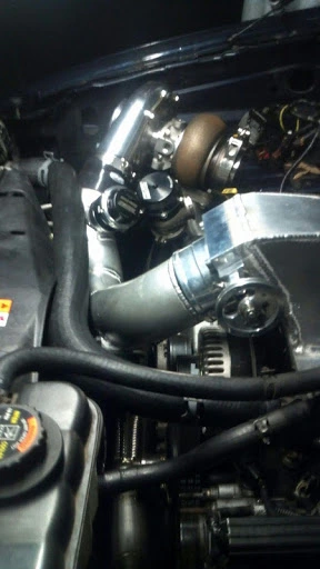

I know, I know its not a mustang, However still one badass ford. My brother and I are working on building my next door neighbor's 2002 True Blue Lightning. Mods listed below:
- Built Engine, fully stud heads and mains built by PCM
- Bored .020 over
- TrickFlow 44cc heads
- Crane Stage 2 S/C cams
- CompCam Stage 3 springs

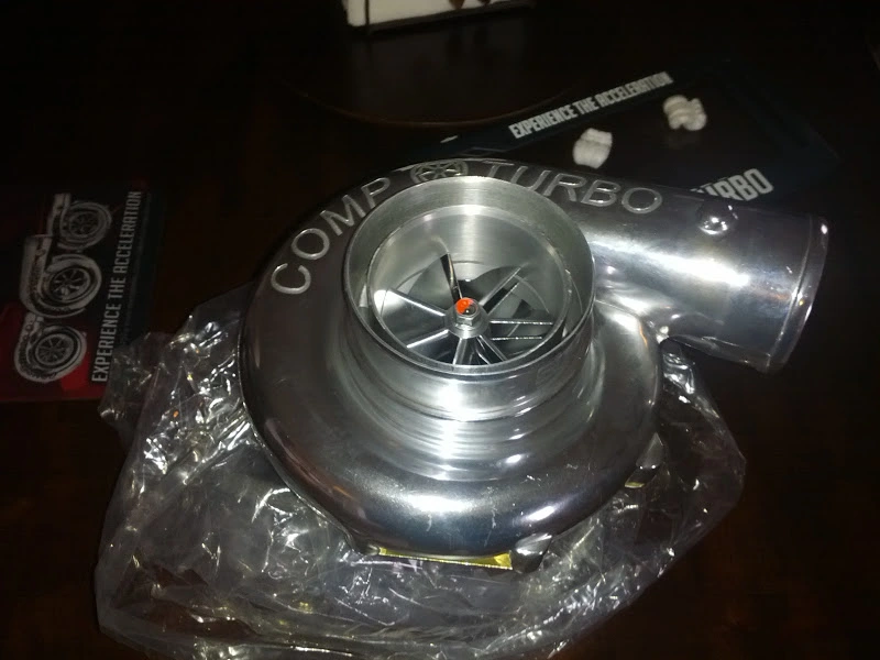

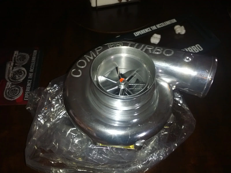

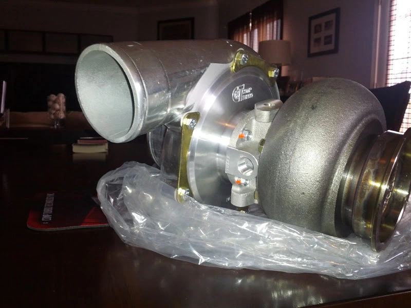

- 76 CompTurbo CT4 Triple ball bearing turbo billet wheel water/oil cooled

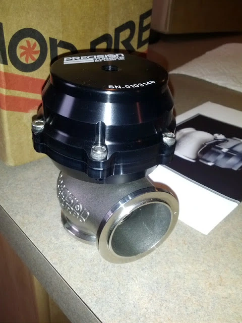

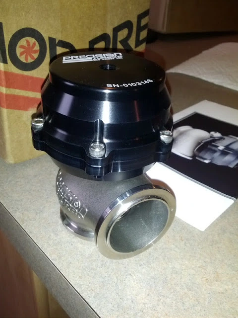

- 46mm Precision Turbo waste gate
- 50mm Turbo Smart BOV
- ProM racing 4" maf cal to 80lb injectors
- Custom Made 90mm TB

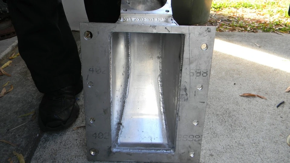

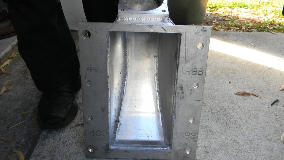

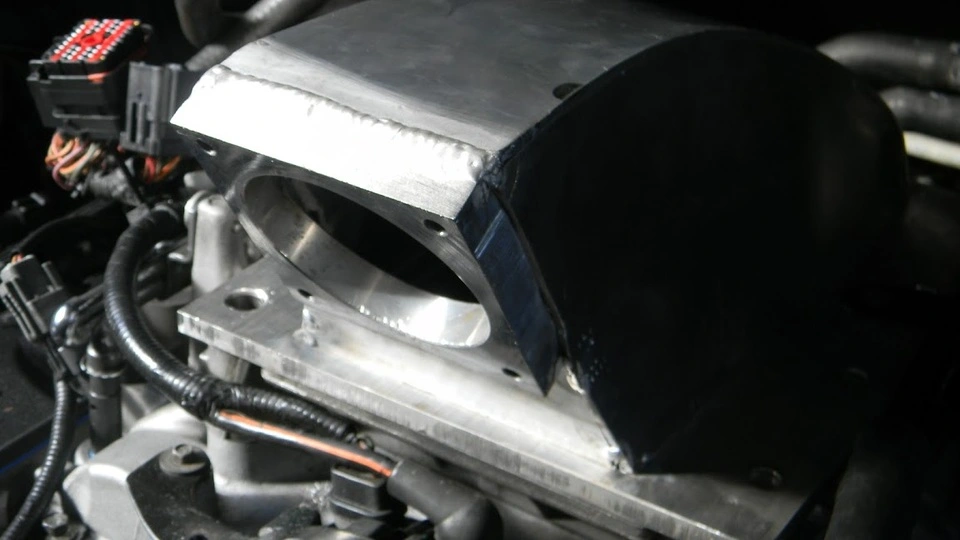

- Custom Made upper plenum by Eric Bishop aka my brother
- Custom Made stainless steal headers, up and down pipes once again Eric Bishop
- Fully built trans and rear end built by PCM
there will be a :poo: ton of pics, so watch out 56kers, if you are still out there!

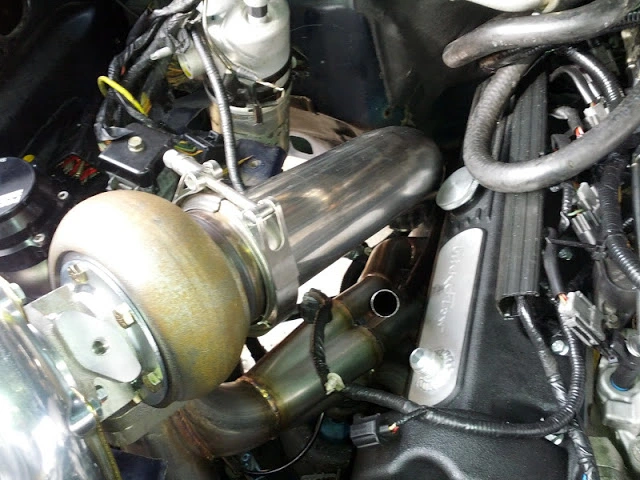

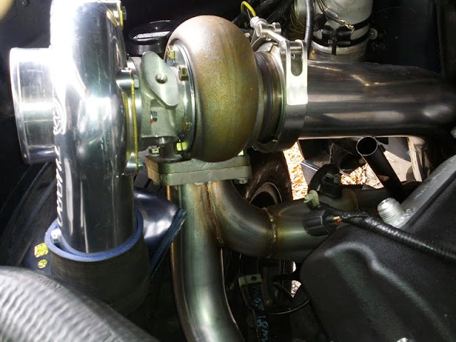

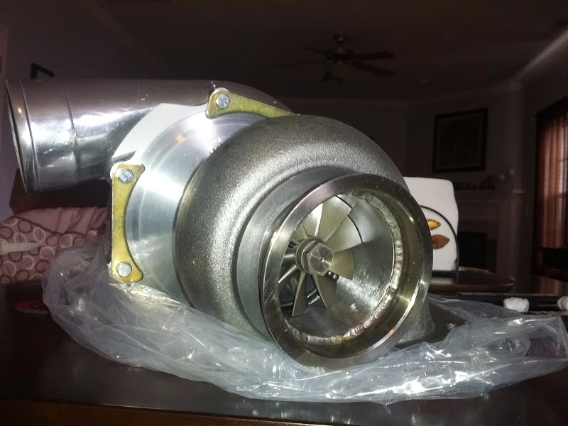

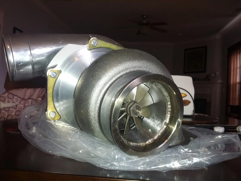

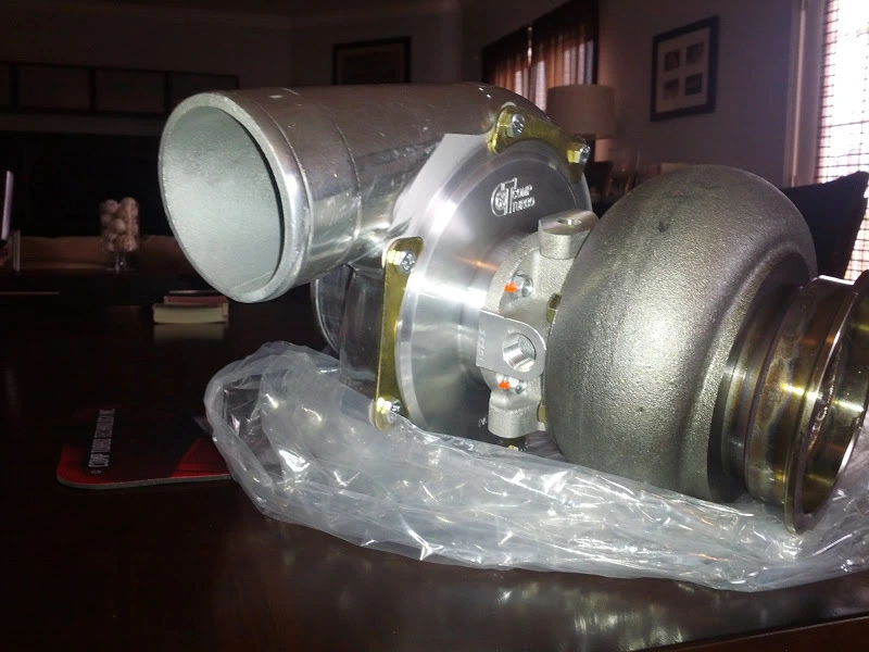

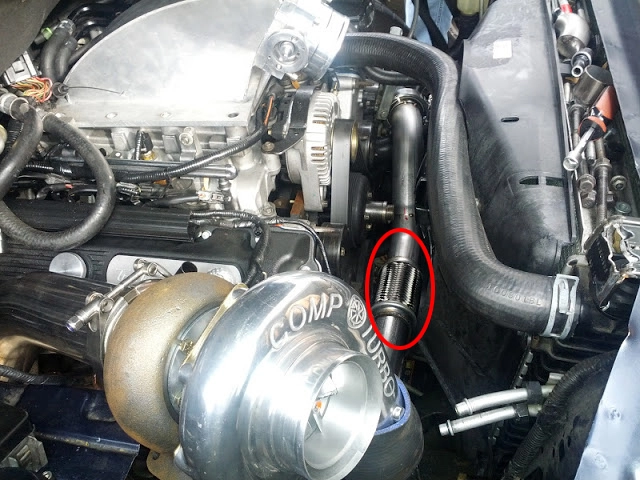

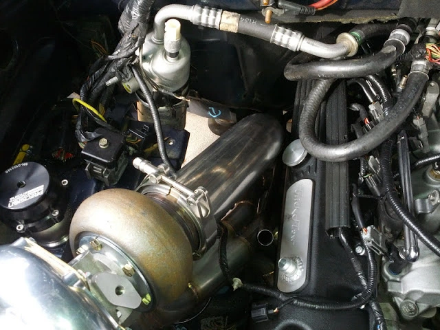

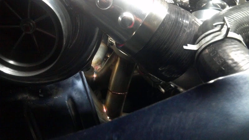

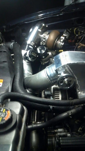

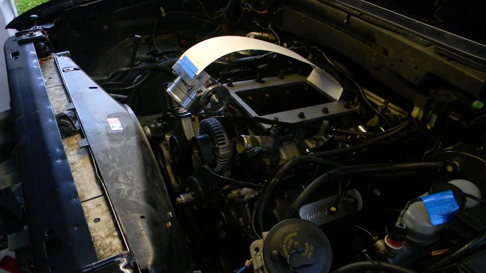

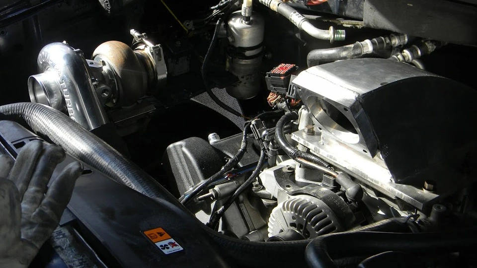

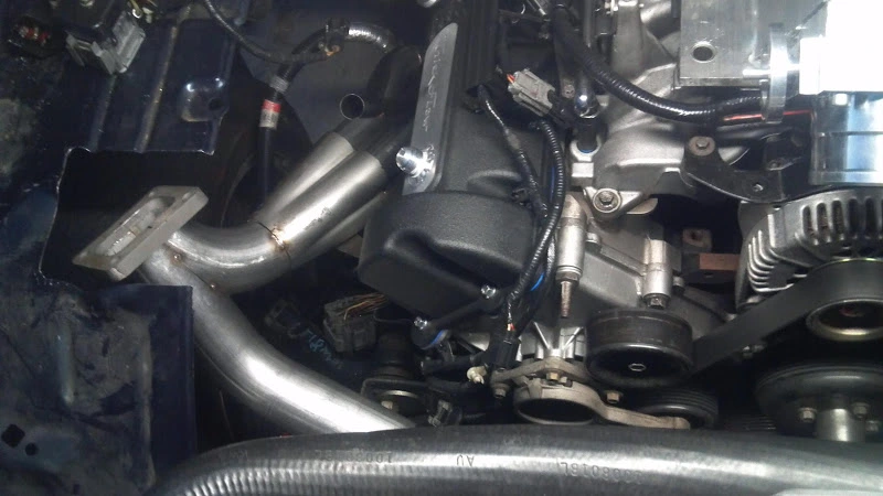

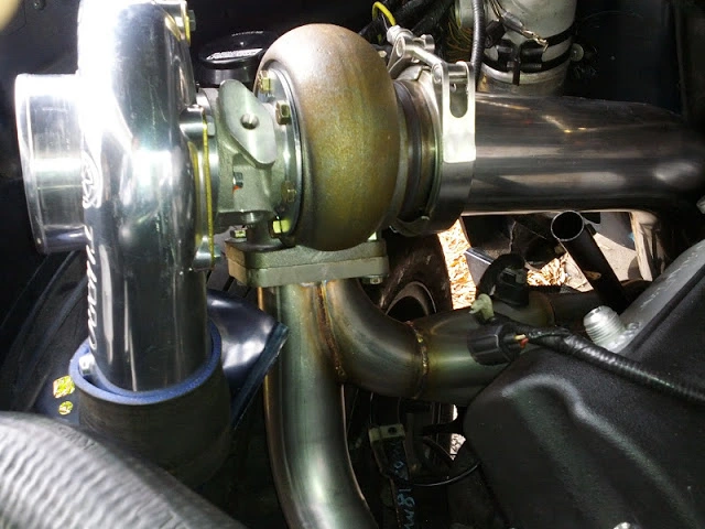

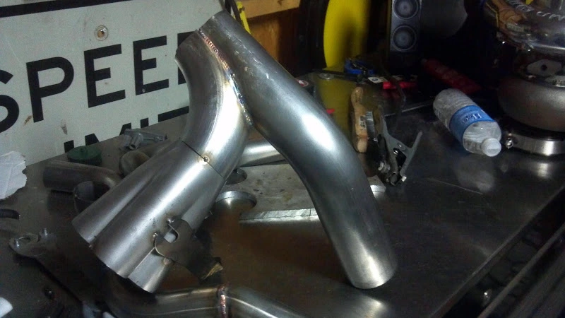

And the start of the build!

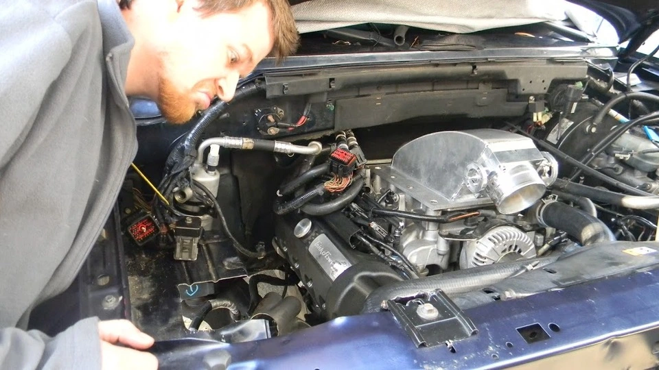

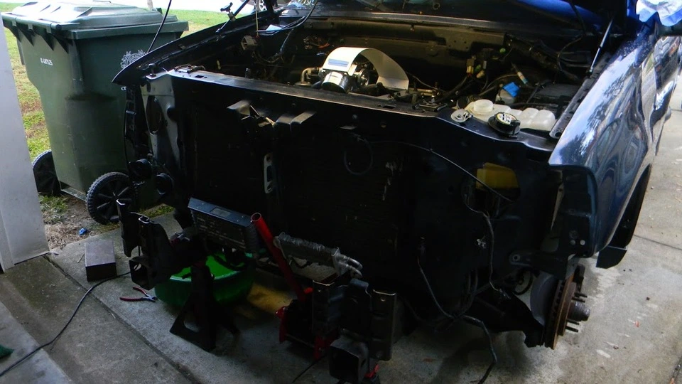

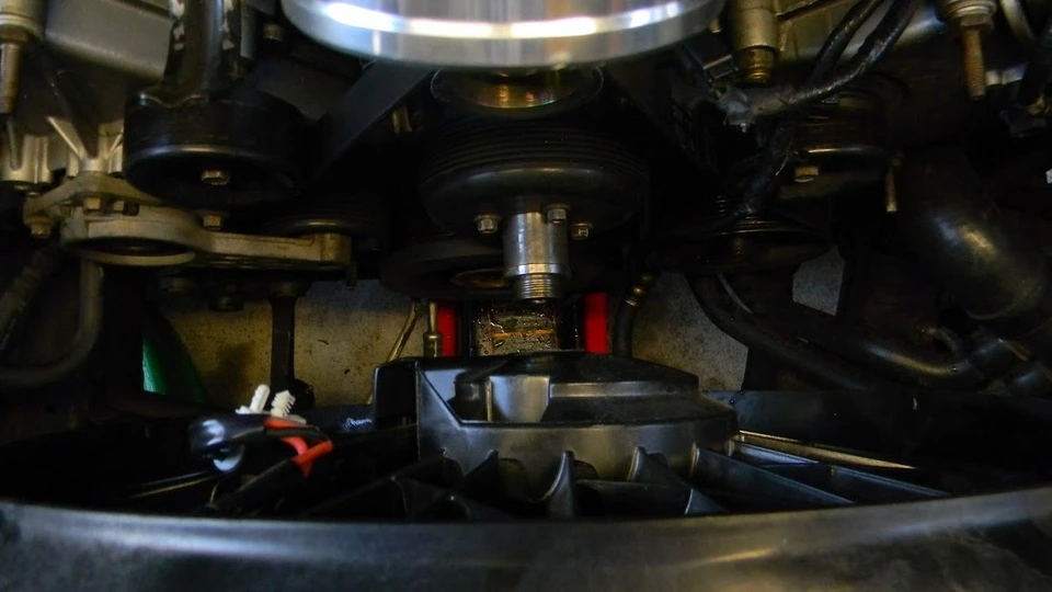

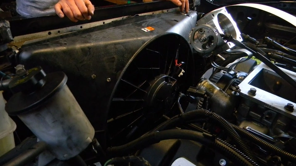

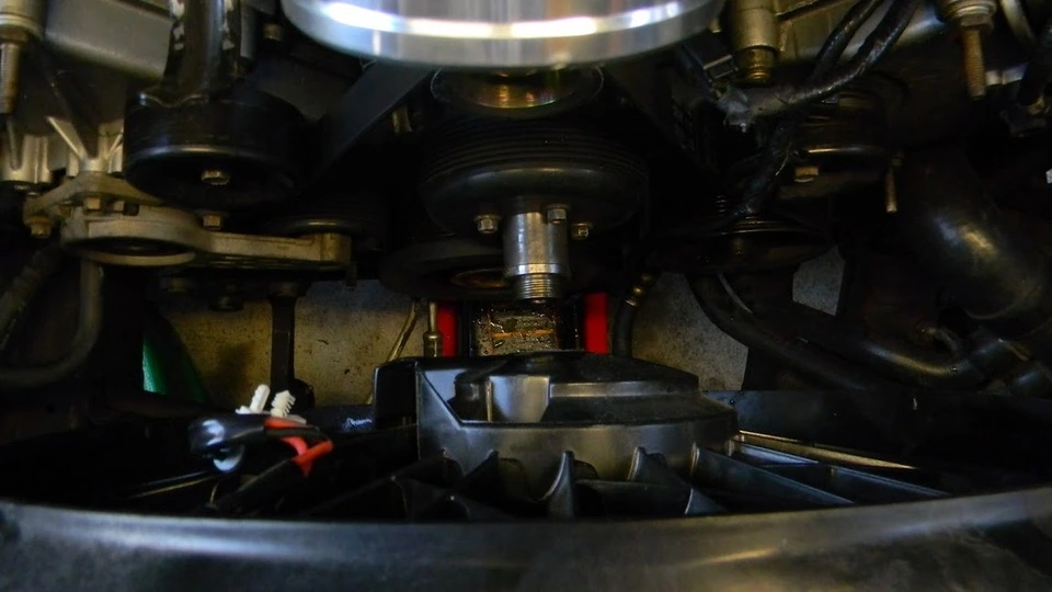

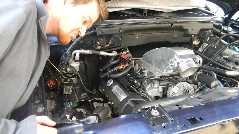

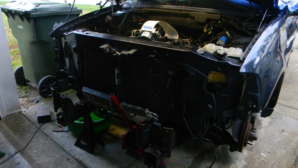

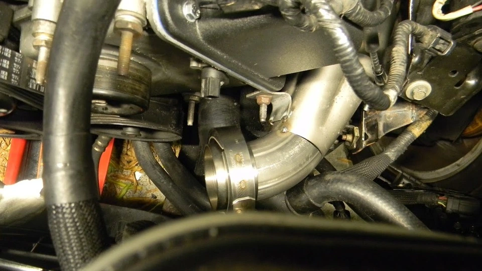

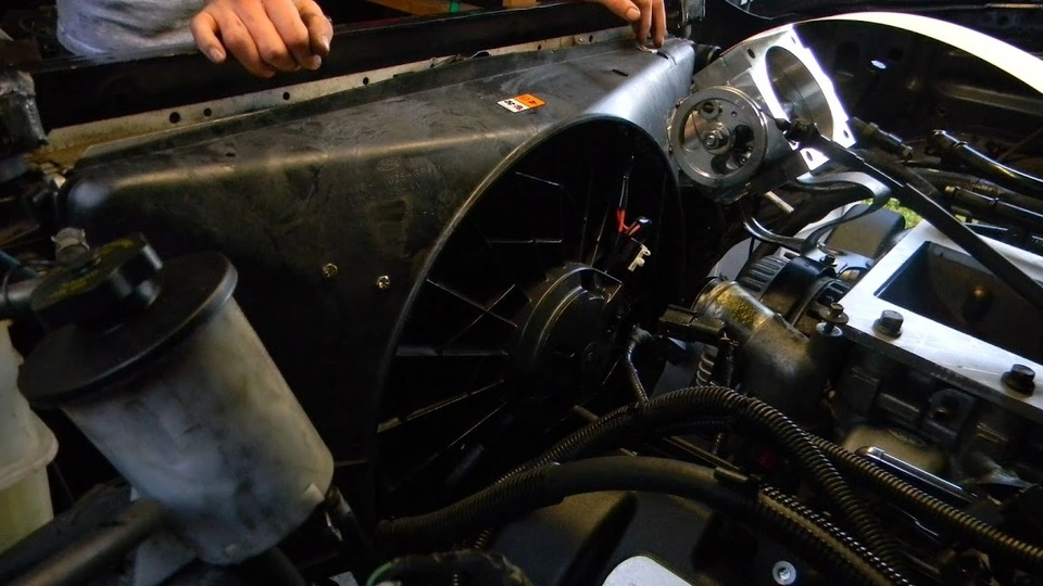

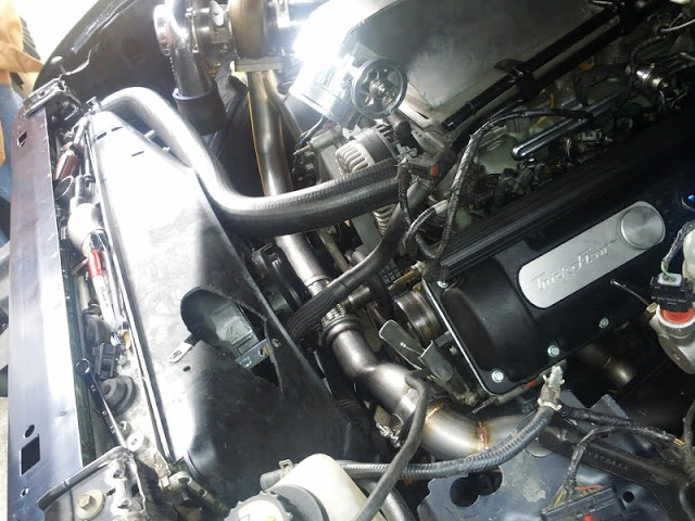

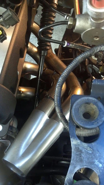

Electric fan conversion as well! Need to make room!

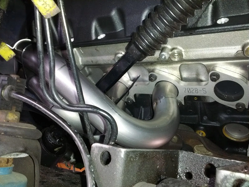

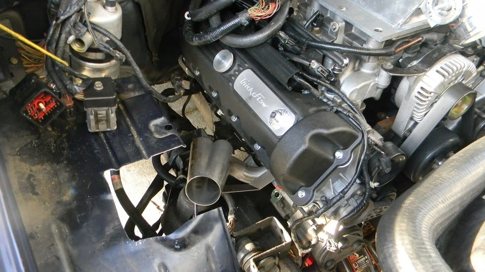

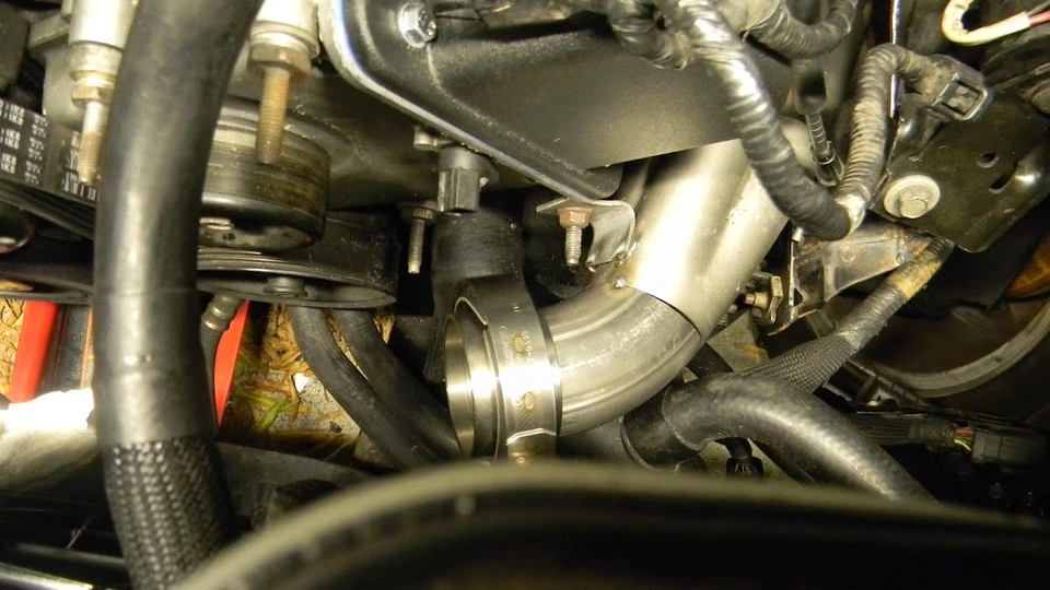

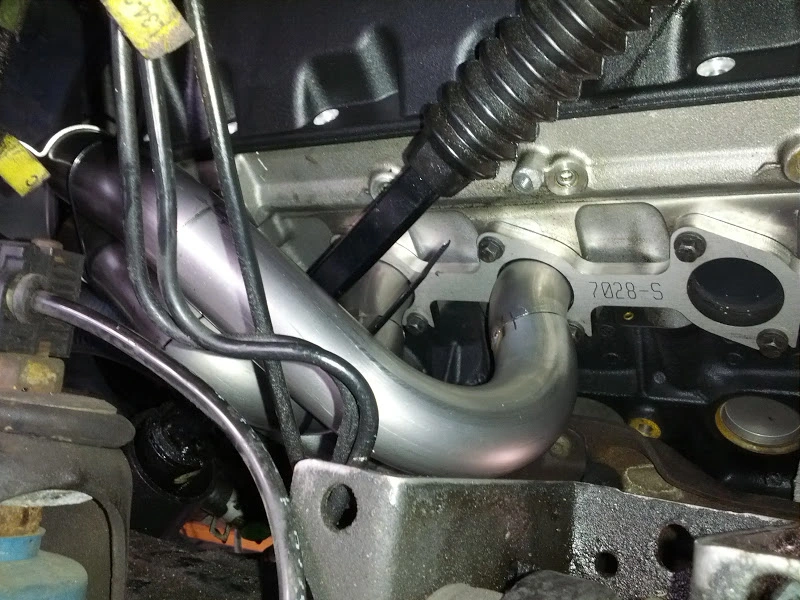

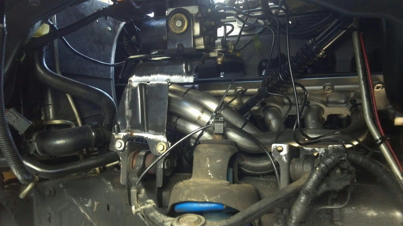

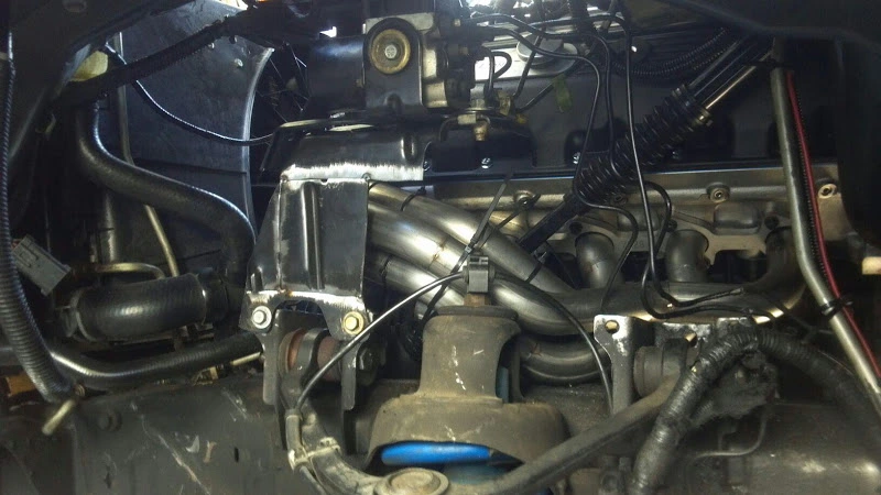

Working on the headers, moved the abs module and the power steering tank over to make room.
cut the old bracket up and bam, new mounting point.

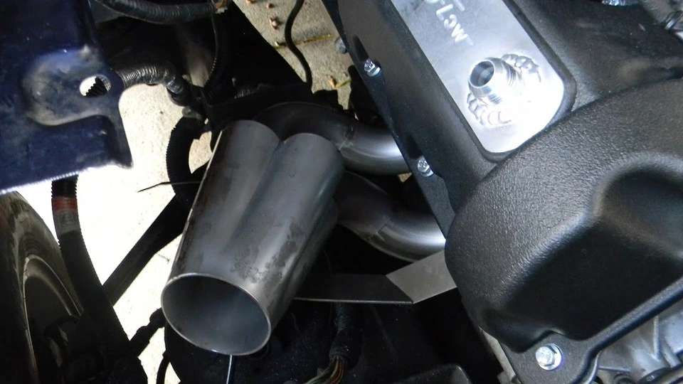

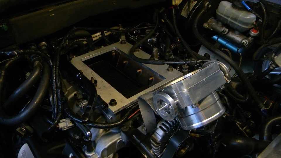

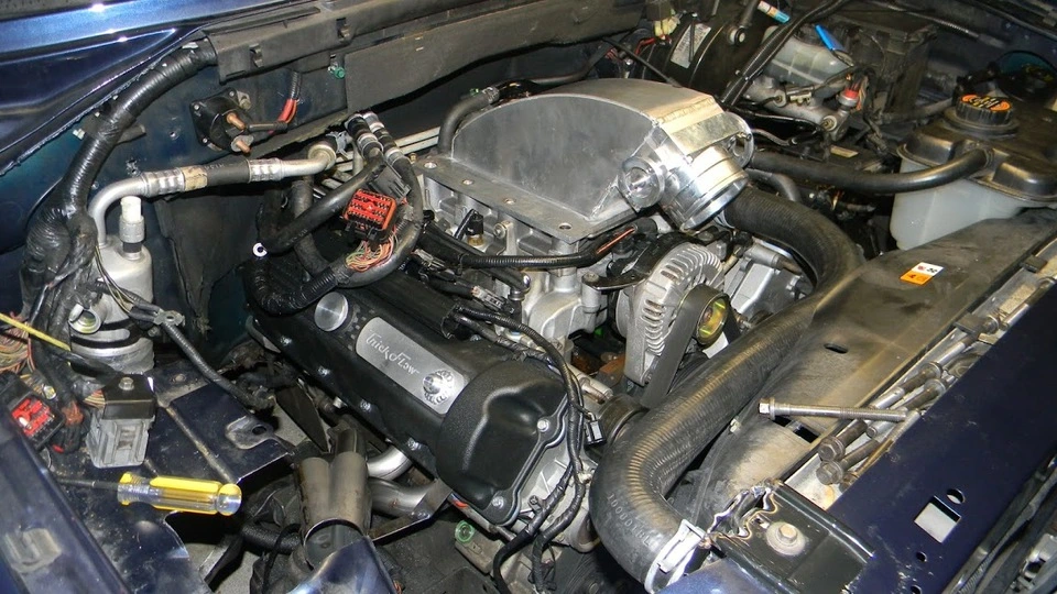

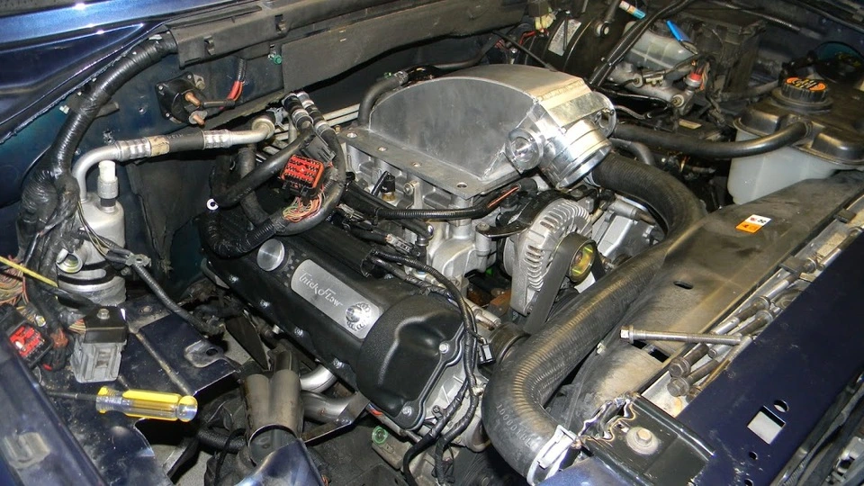

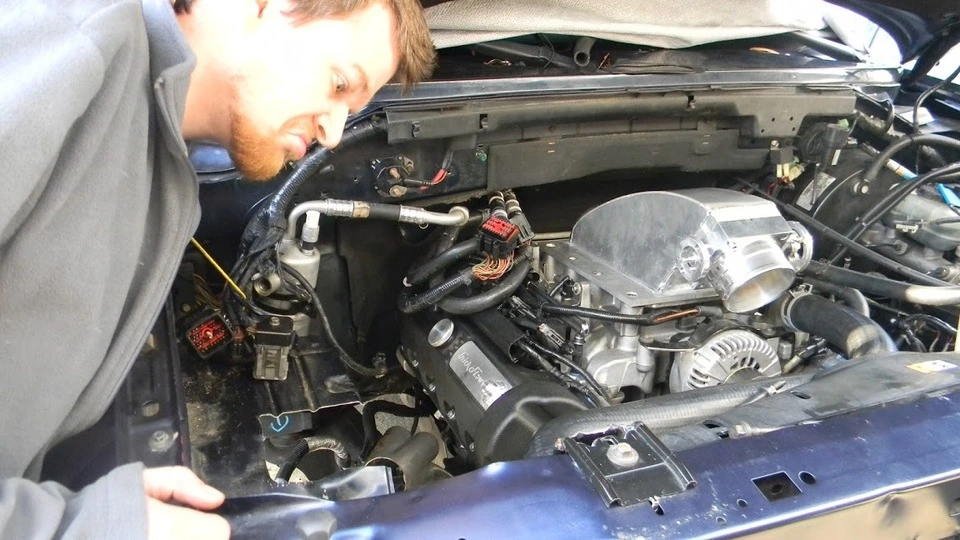

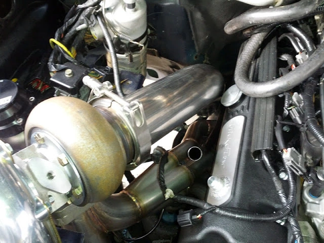

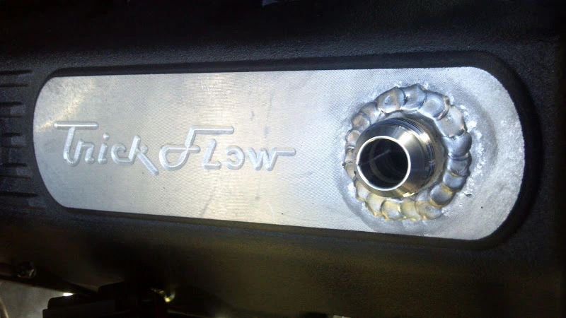

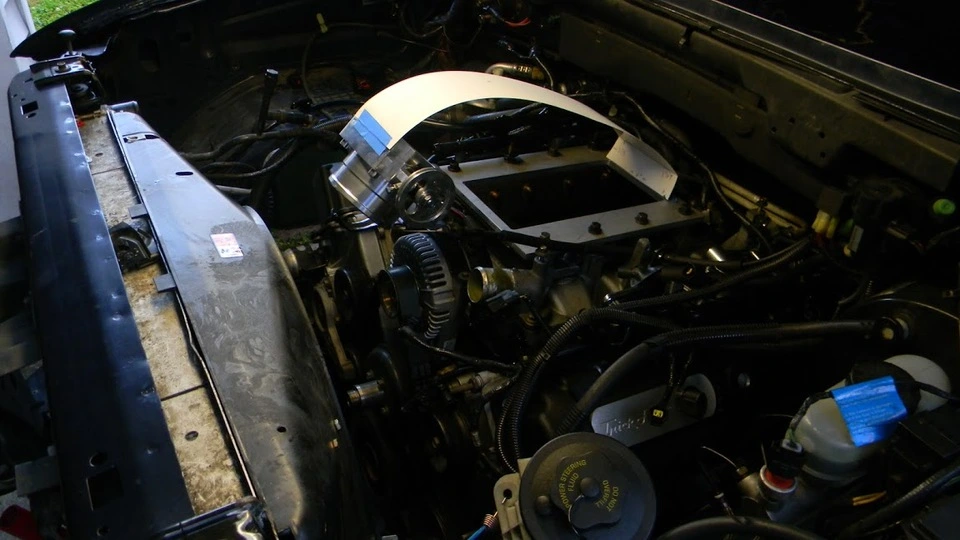

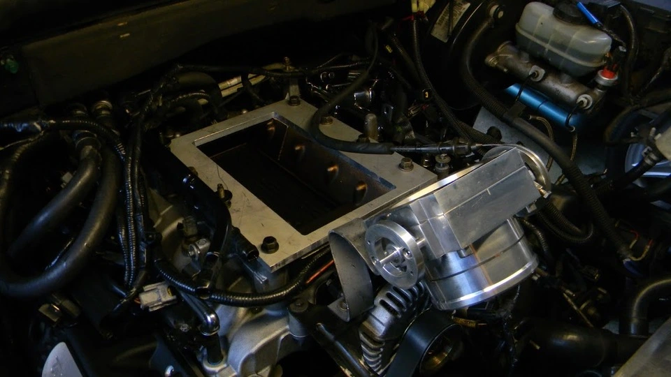

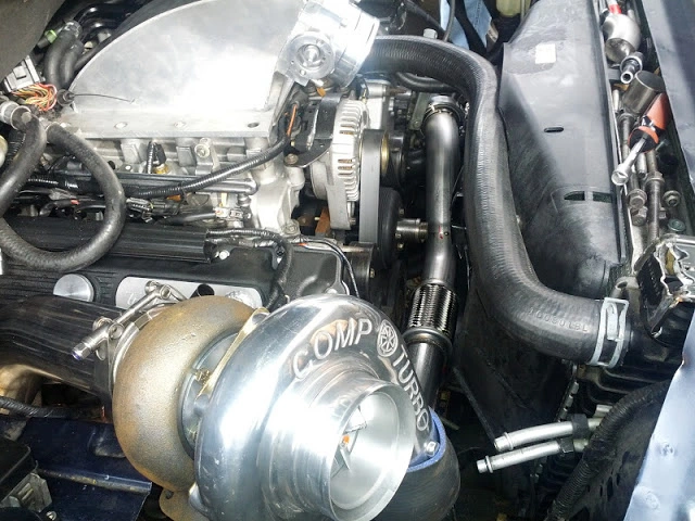

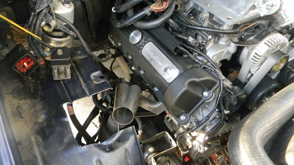

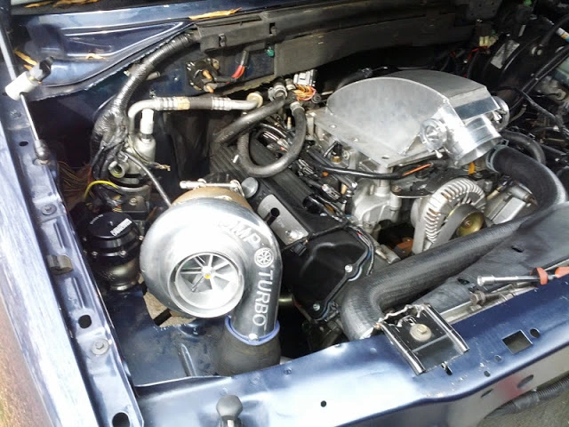

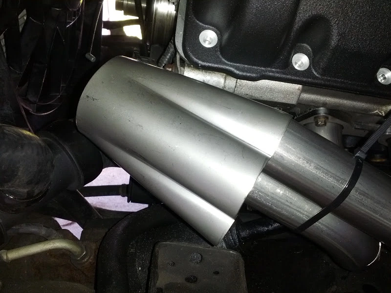

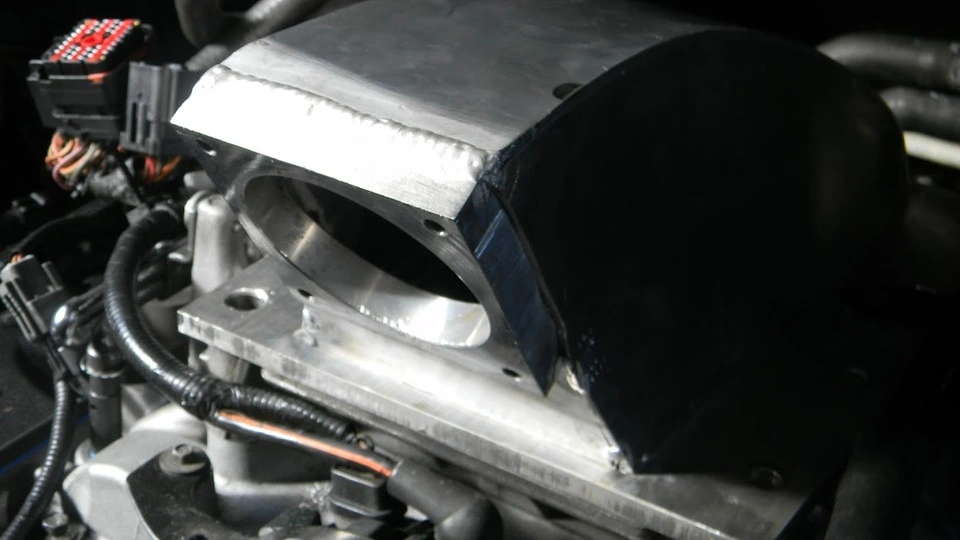

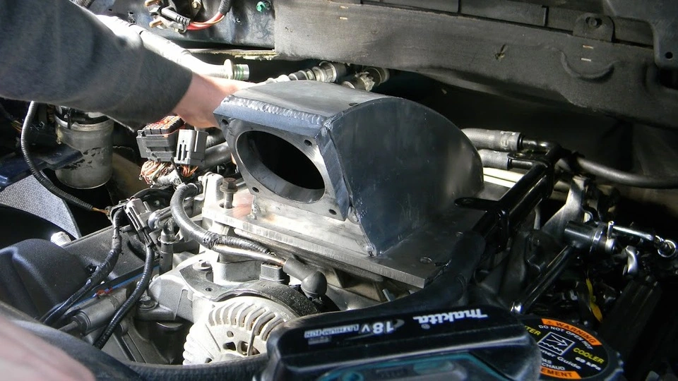

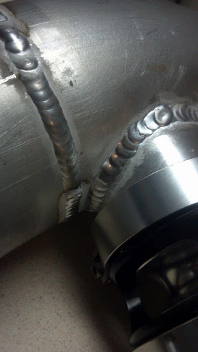

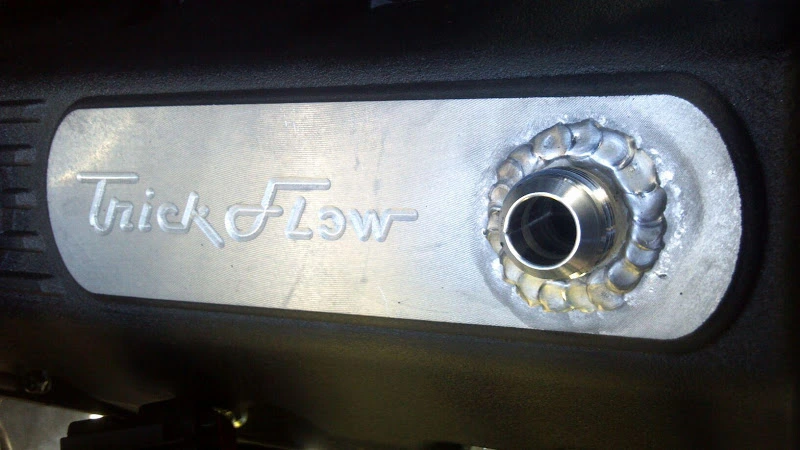

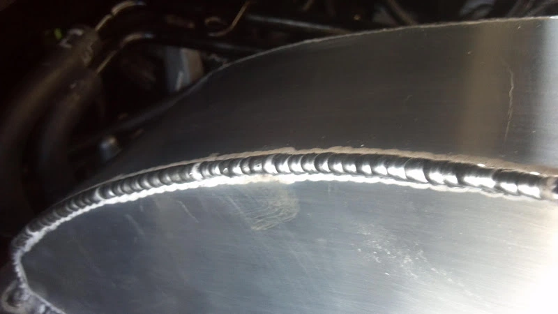

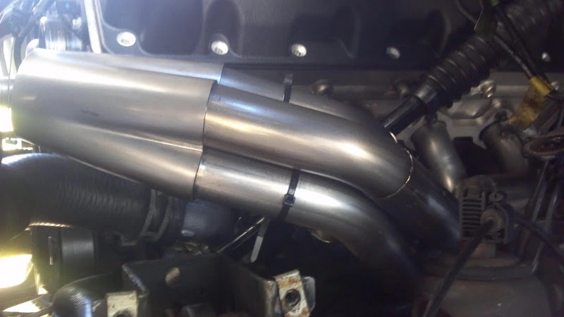

Trickflow valve covers added some AN connectors for the overflow tank.

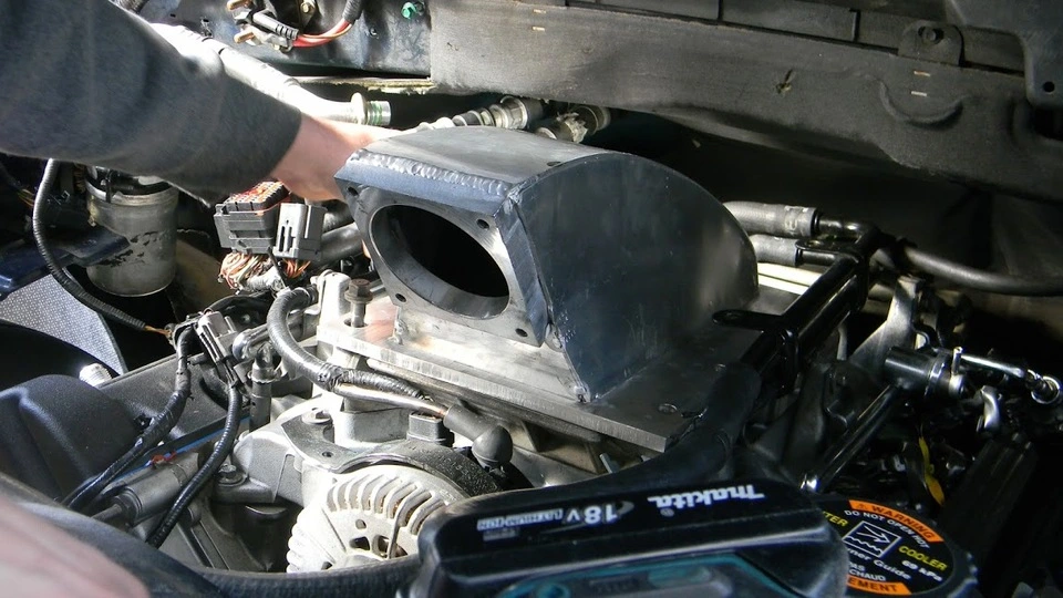

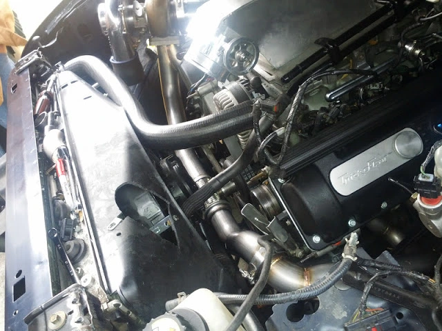

and BAM! intake almost done!

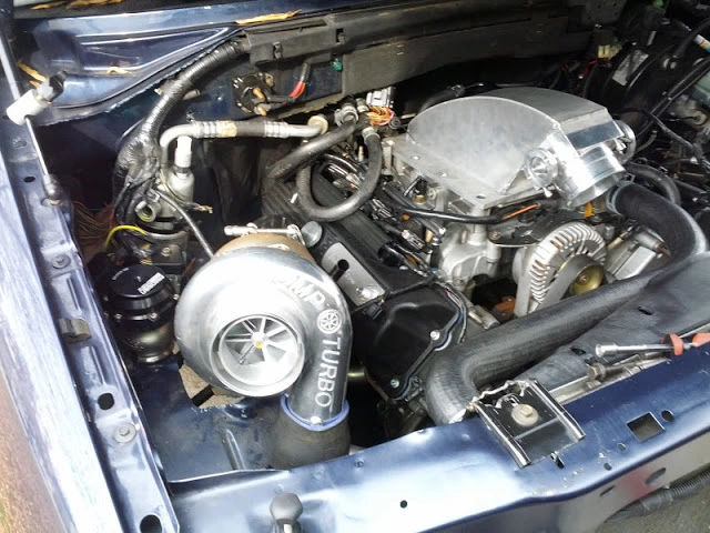

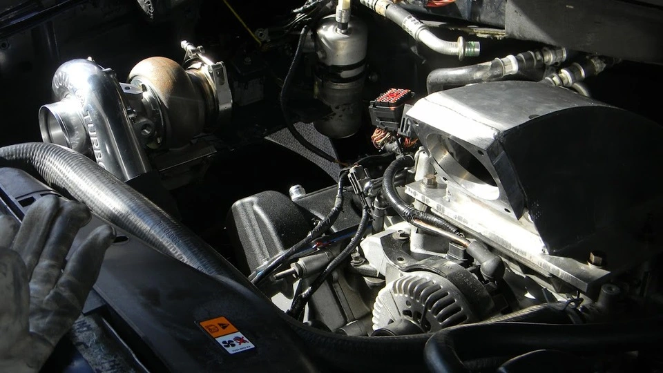

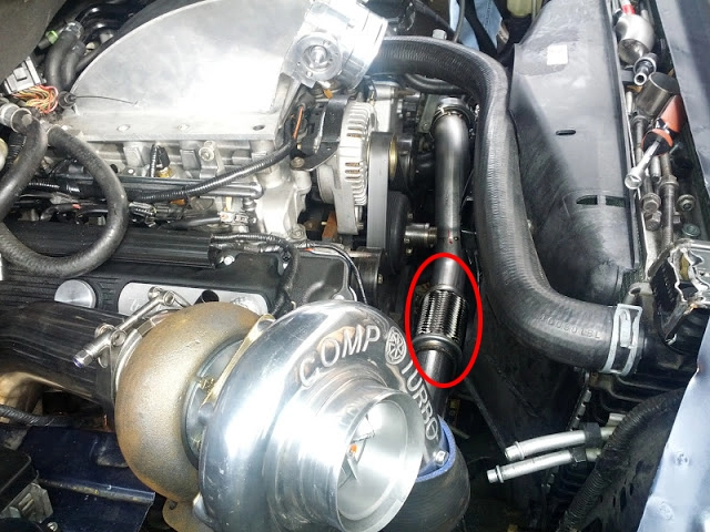

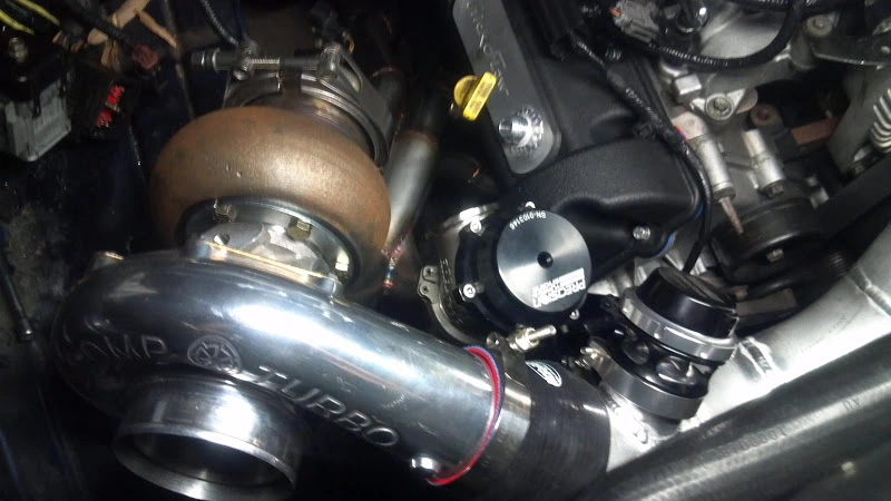

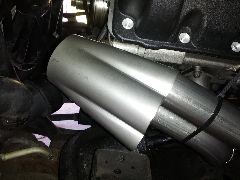

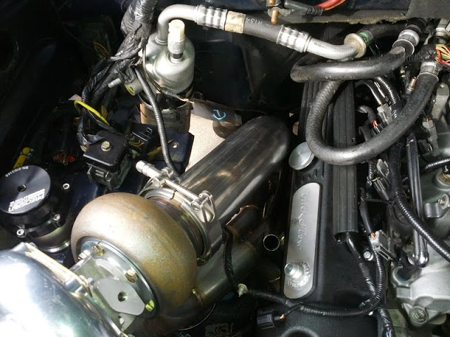

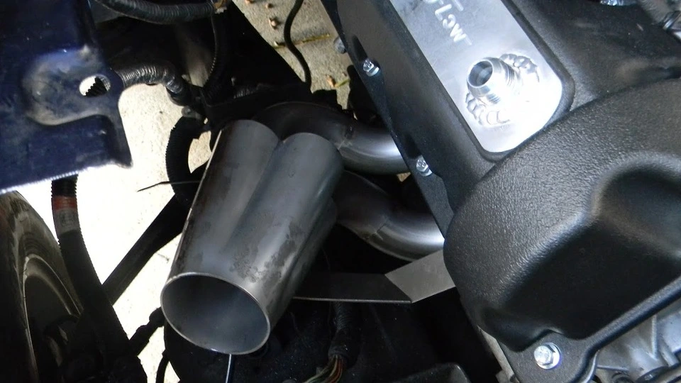

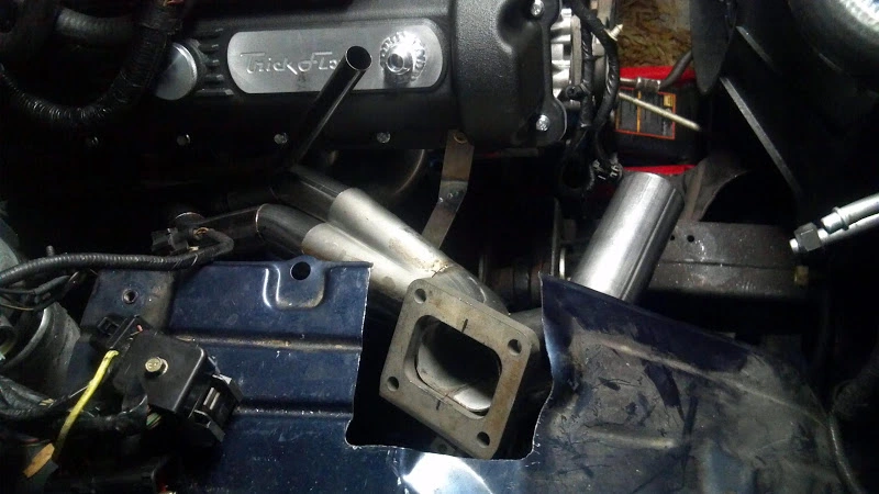

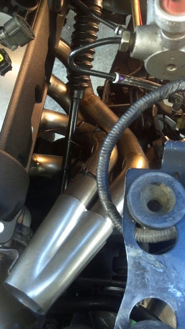

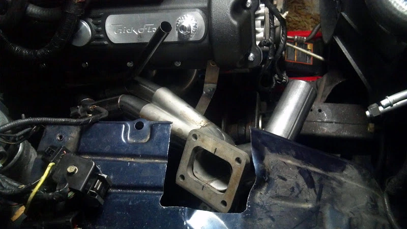

Thats where the turbo will be placed, also moved the AC dryer over to make room for the downpipe. Need to make custom AC lines after downpipe is finished.

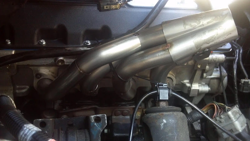

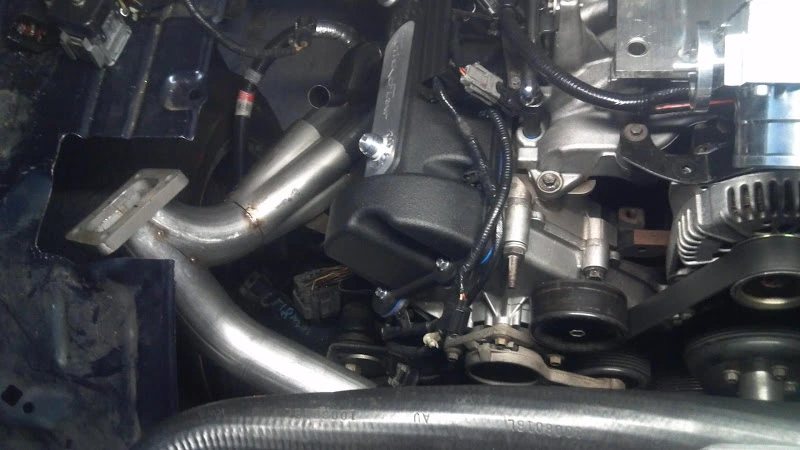

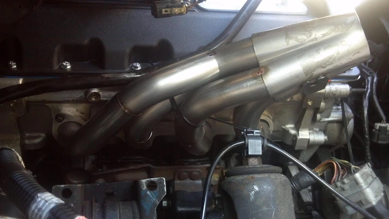

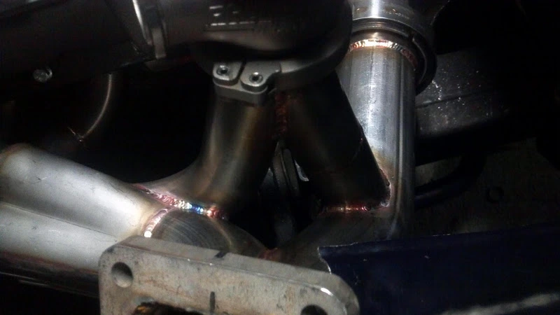

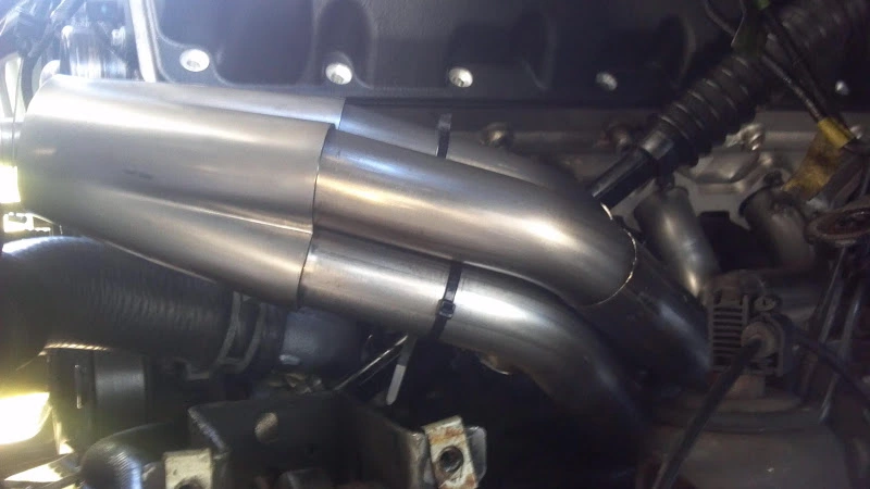

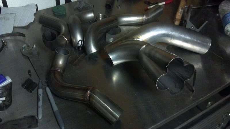

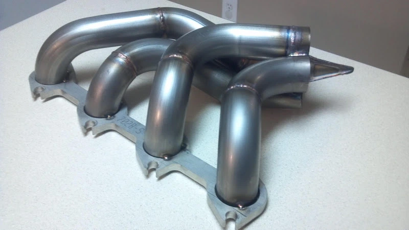

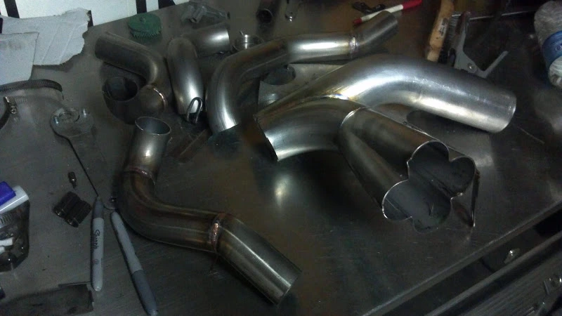

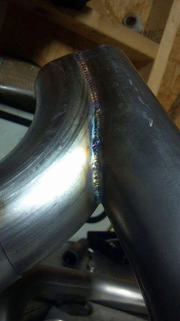

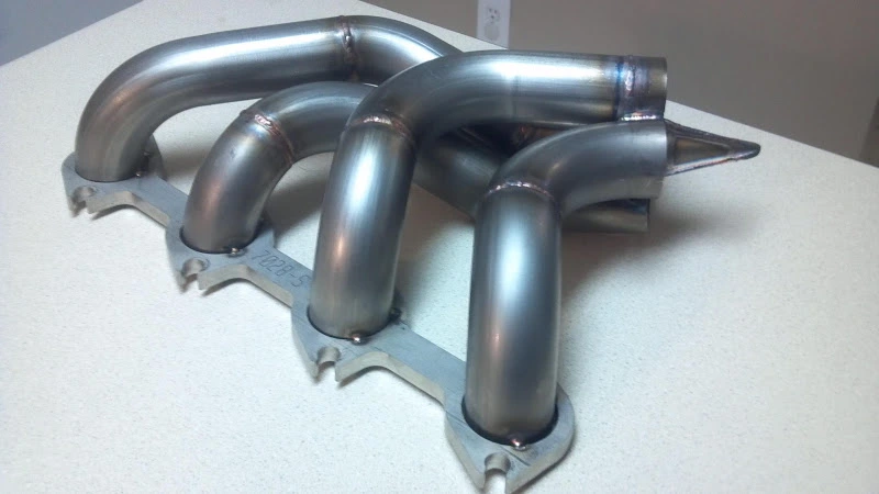

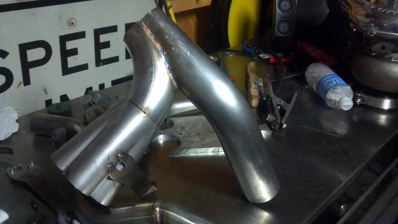

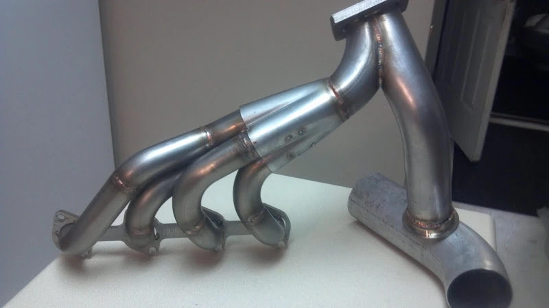

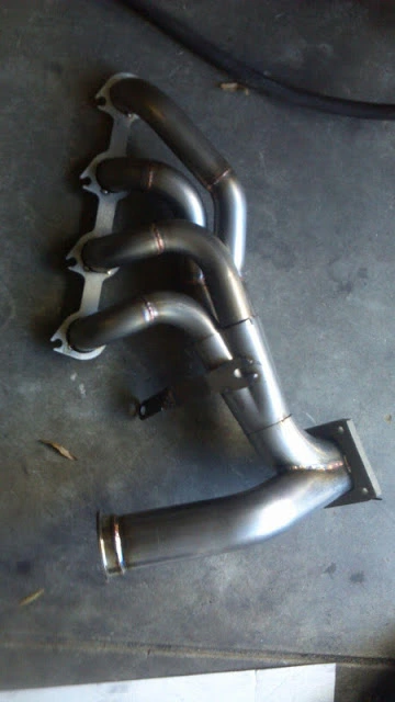

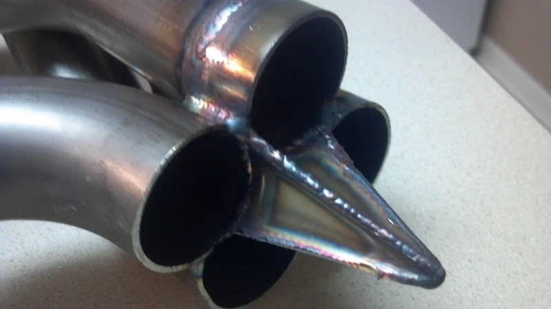

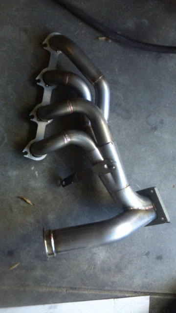

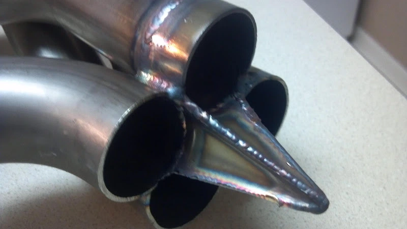

Passenger side header started!
Me cutting the header pipes. (doing some work lol)
Crossover connector
BEAST MODE 800RWHP 93 PUMP GAS LSX EATER... COMING SOON!

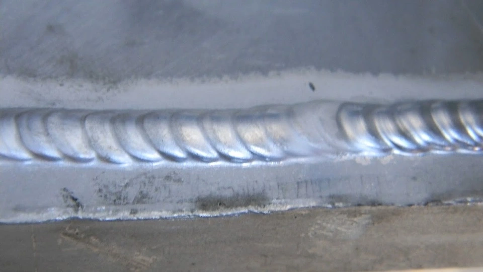

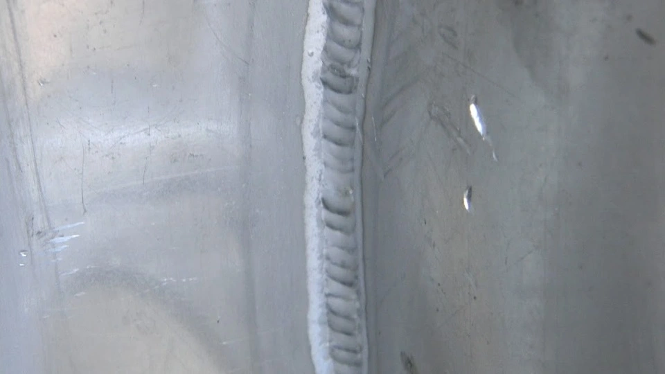

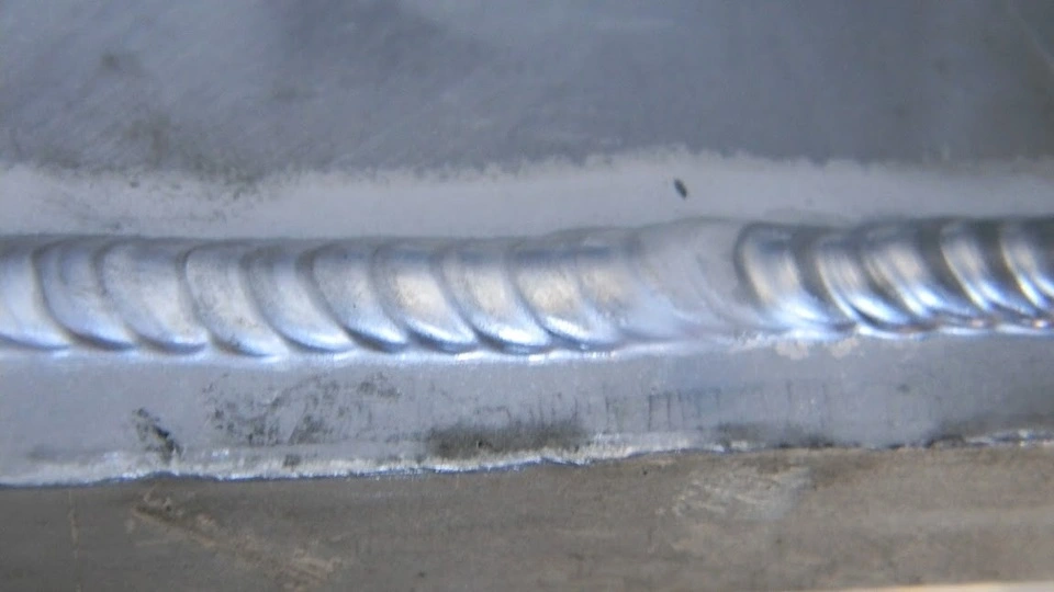

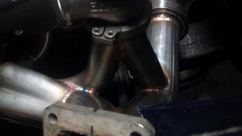

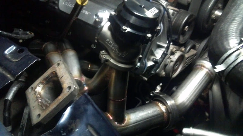

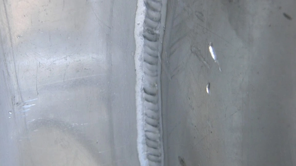

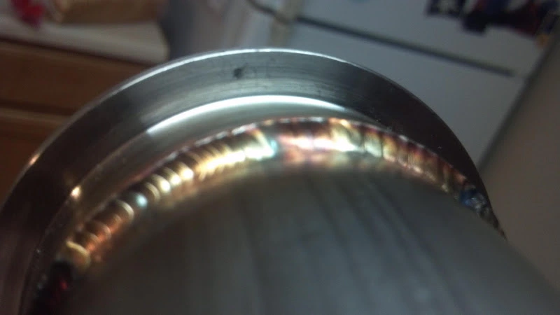

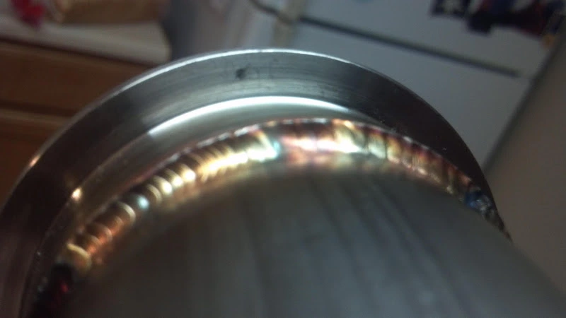

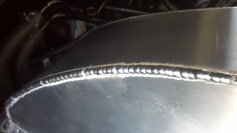

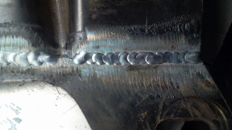

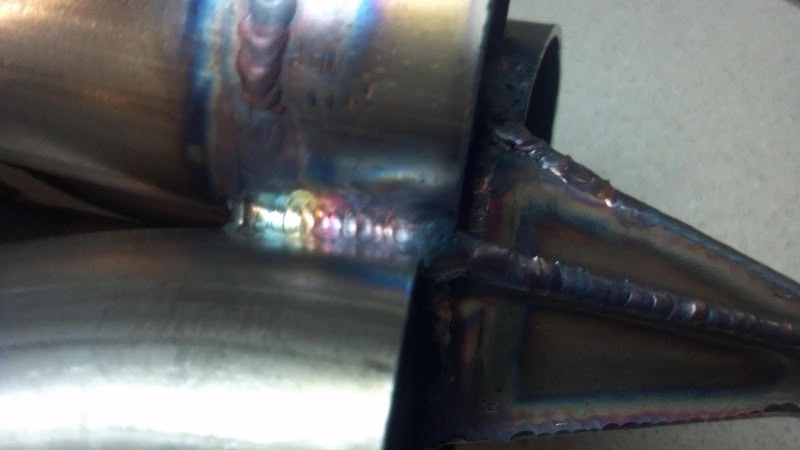

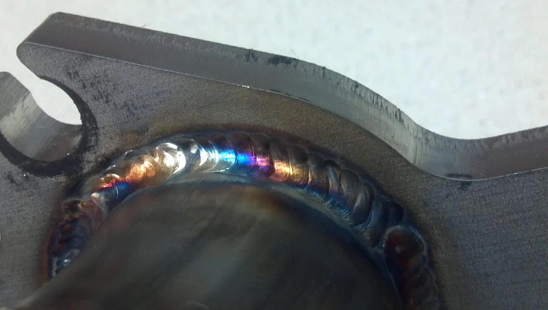

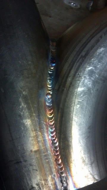

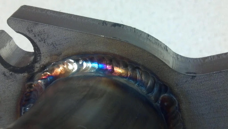

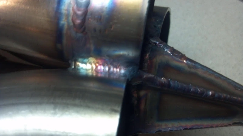

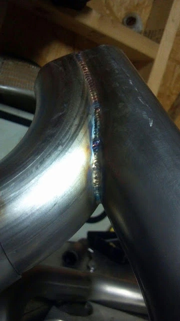

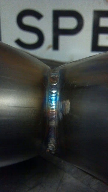

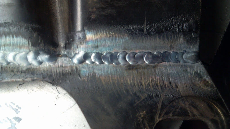

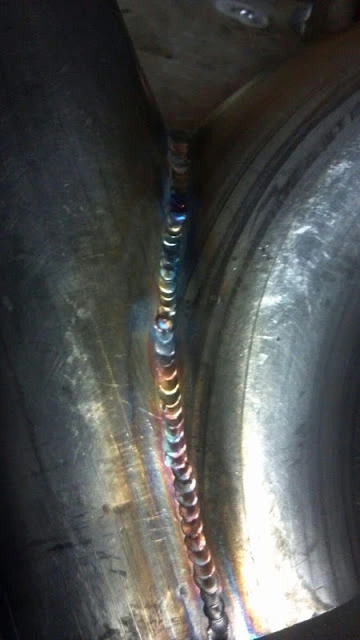

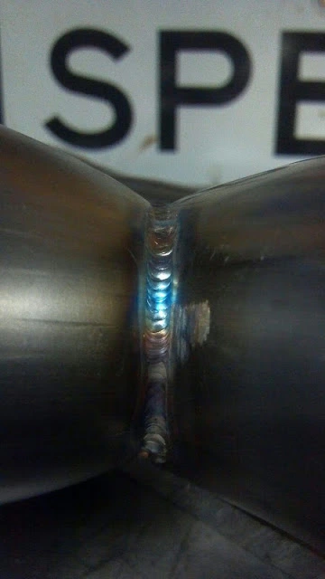

And started to do some of the finishing welds, my brother is killing it!

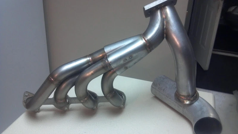

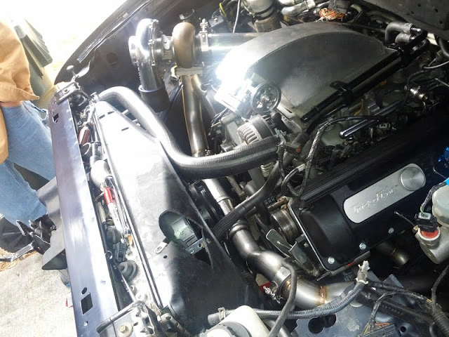

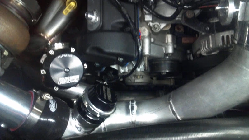

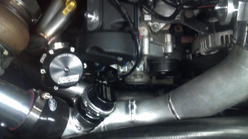

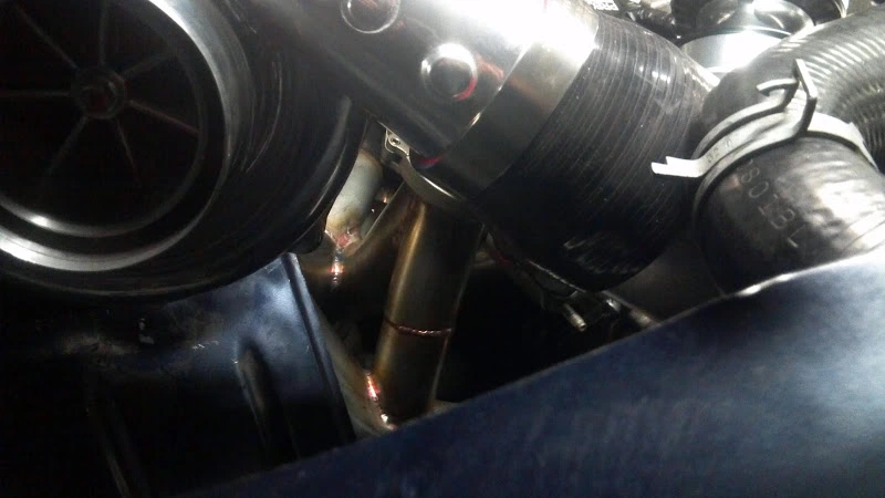

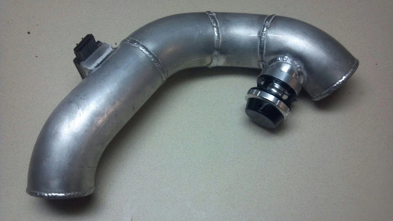

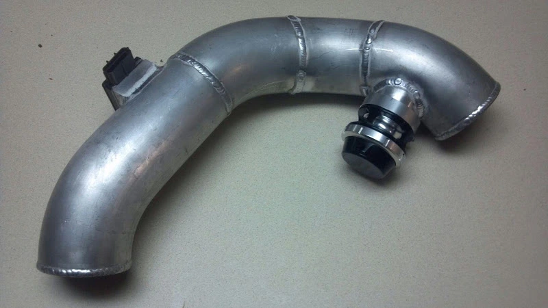

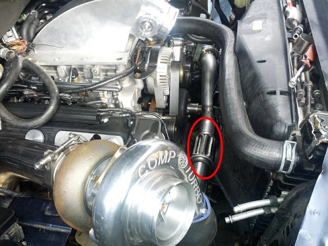

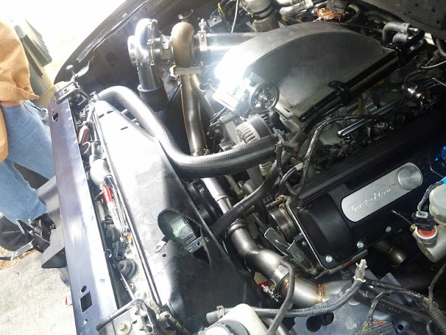

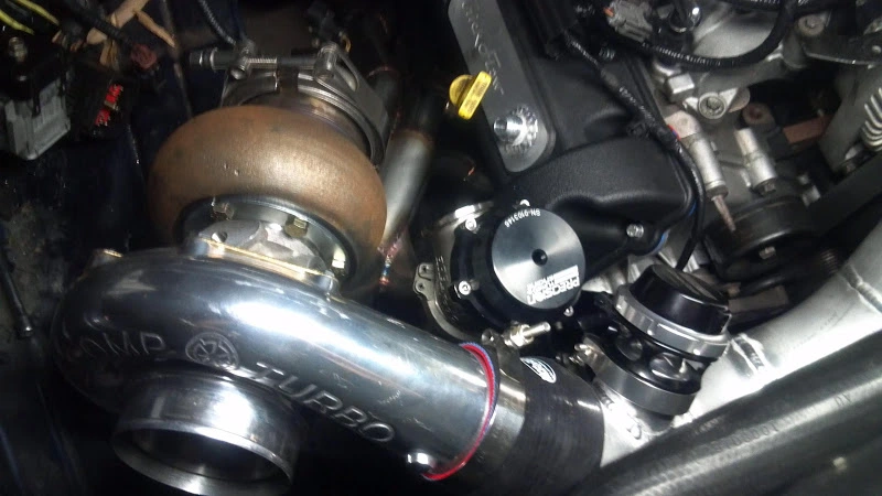

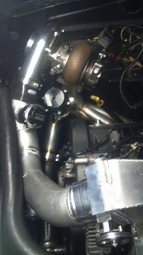

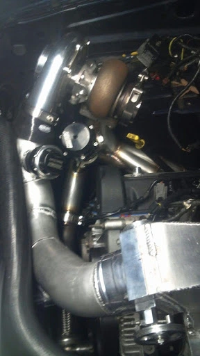

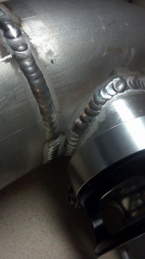

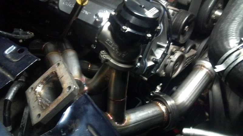

Intake tube, blow off, maf and wastegate installed
