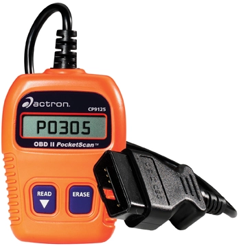

OBD2 will not turn off the light on it's own. Only way I know of to reset the light, is to use an OBD2 reader, hook it up, read the code, and then issue a reset of the system from that.
I've reset mine plenty of times using this one:
Actron CP9125 Pocketscanner

I agree with Neko though, get a code reader and see for yourself what the issue is.
Good luck with your problem, but I bet it will be an easy fix.
Yeah, get a code reader (or go to AutoZone) and get the code for yourself. I wouldn't go back to Firestone, especially if they're not diagnosing the problem correctly. If they're just throwing new O2 sensors on when the light could very well be something else unrelated, I wouldn't trust them with anything more than putting on tires.

A PCM reset can be easily done by disconnecting the battery. However this won't help you pass a smog test as the readiness tests will NOT be complete. Best to find out what the full DTC is and work through a real repair. There are 1,000's of DTC codes and they each have a story to tell.
