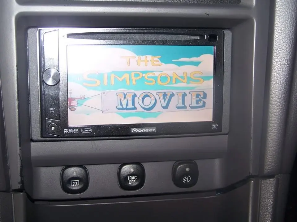

heres what i replaced mine with. $340 on sale at best buy
heh ya, that's my worry is it happening again. i've read too many threads with people having this happen to them, and in some cases more than once in different vehicles. while i'd like to replace it with a stock one it looks like i'm gonna just have to get an aftermarket one.
