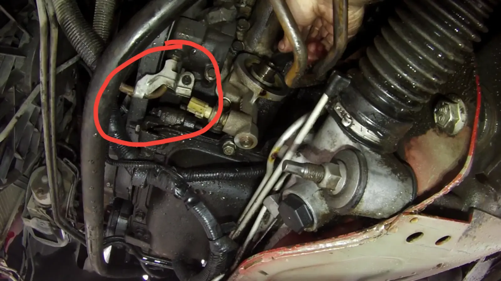

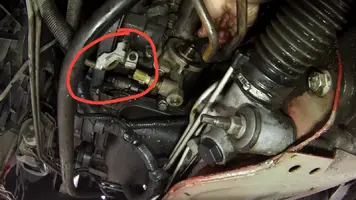

Hey guys. I have a 2003 GT with 4.6L with hydroboost. I need some help finding this bracket. It is the "L" shaped metal support bracket that supports the pressure line that runs from the bottom of the pump to the top of the hydroboost unit. It helps prevent excess movement in this line when the engine "flexes" back and forth during acceleration and deceleration so that the internal o-ring doesn't wear out so fast. When the engine was rebuilt, this bracket was lost an not installed, so within 1000 miles, I had a massive power steering fluid leak. I've replaced the hose/line, but I can't find this bracket anywhere online or even at the salvage yards around here. Does anyone know where to find miscellaneous brackets like this or maybe some one has a couple laying around? Thanks!
