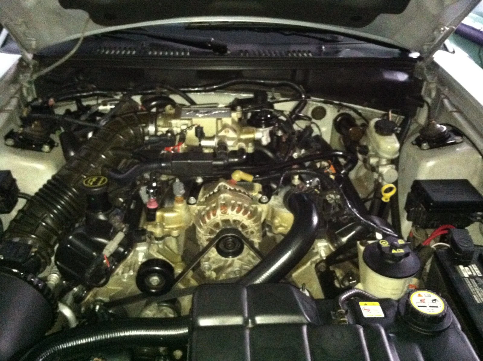

Not sure what you mean by fuse F2.34, etc. all the engine bay fuses have power ignition on or off. Am I missing something? These are the high current fuses 1 - 29.
It seems that replacing my original battery has created this problem. The car is 100% original with zero modifications.
