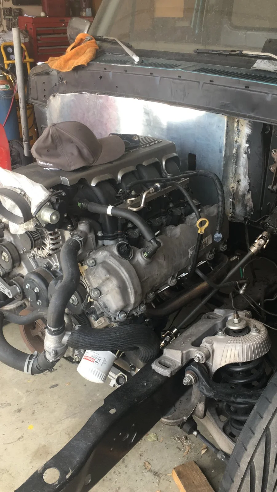

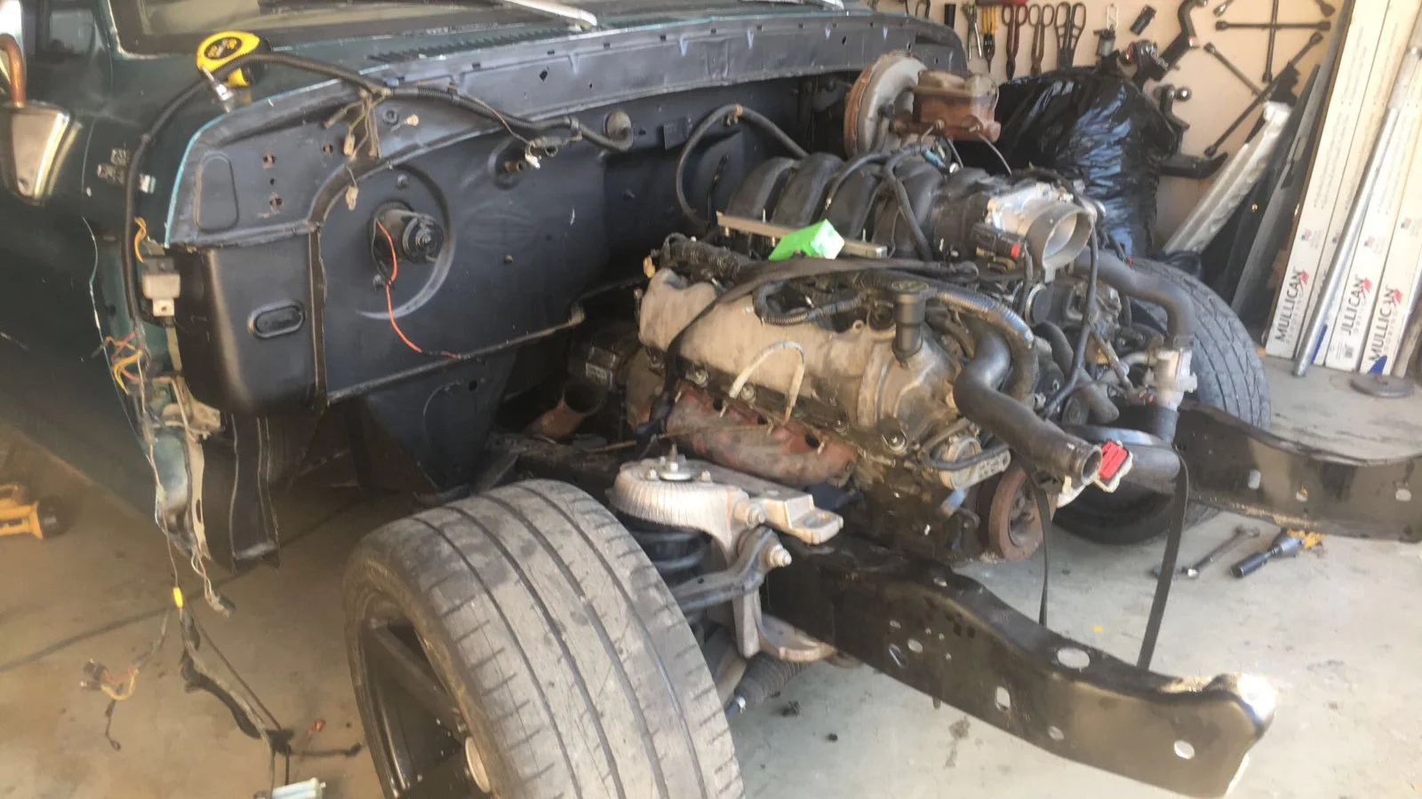

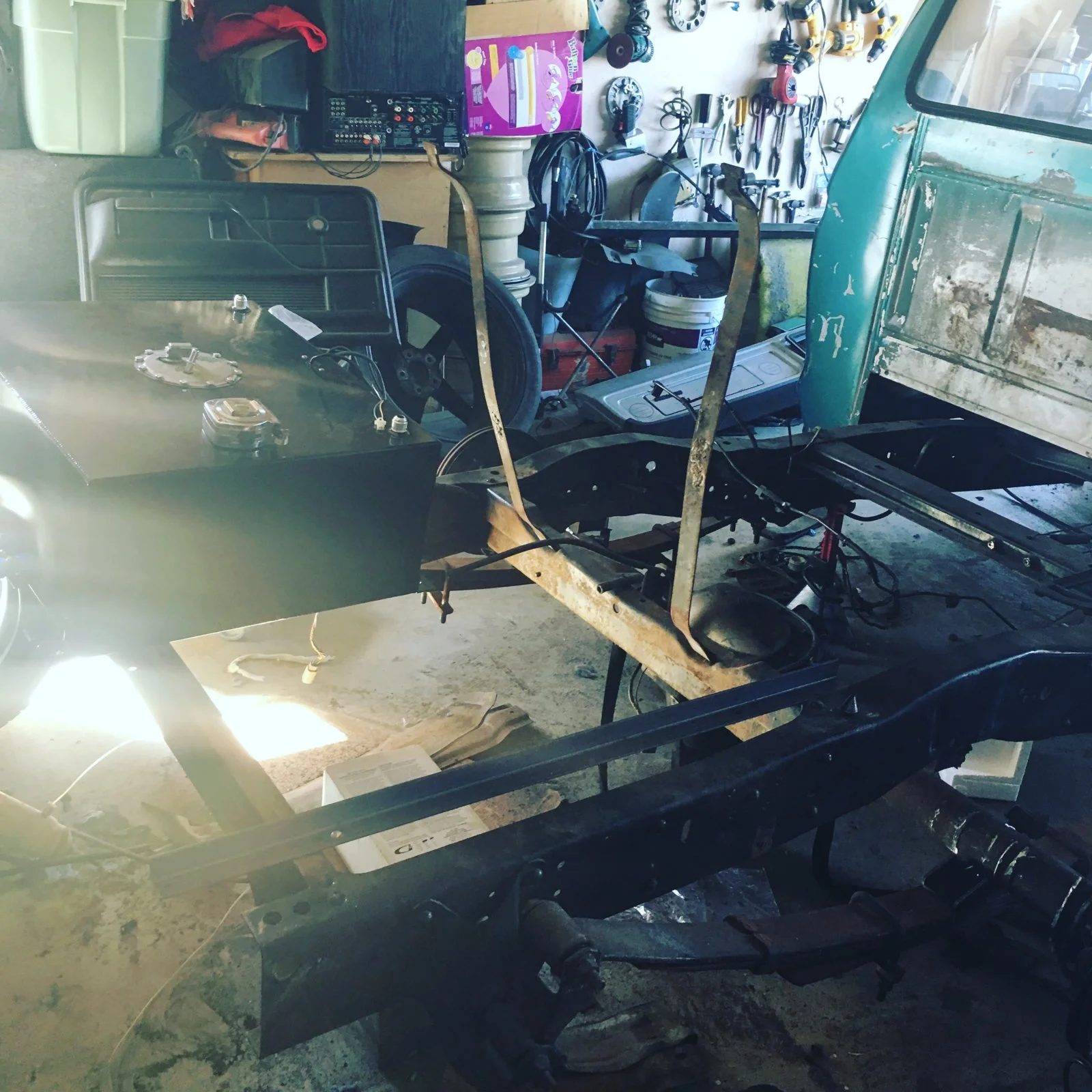

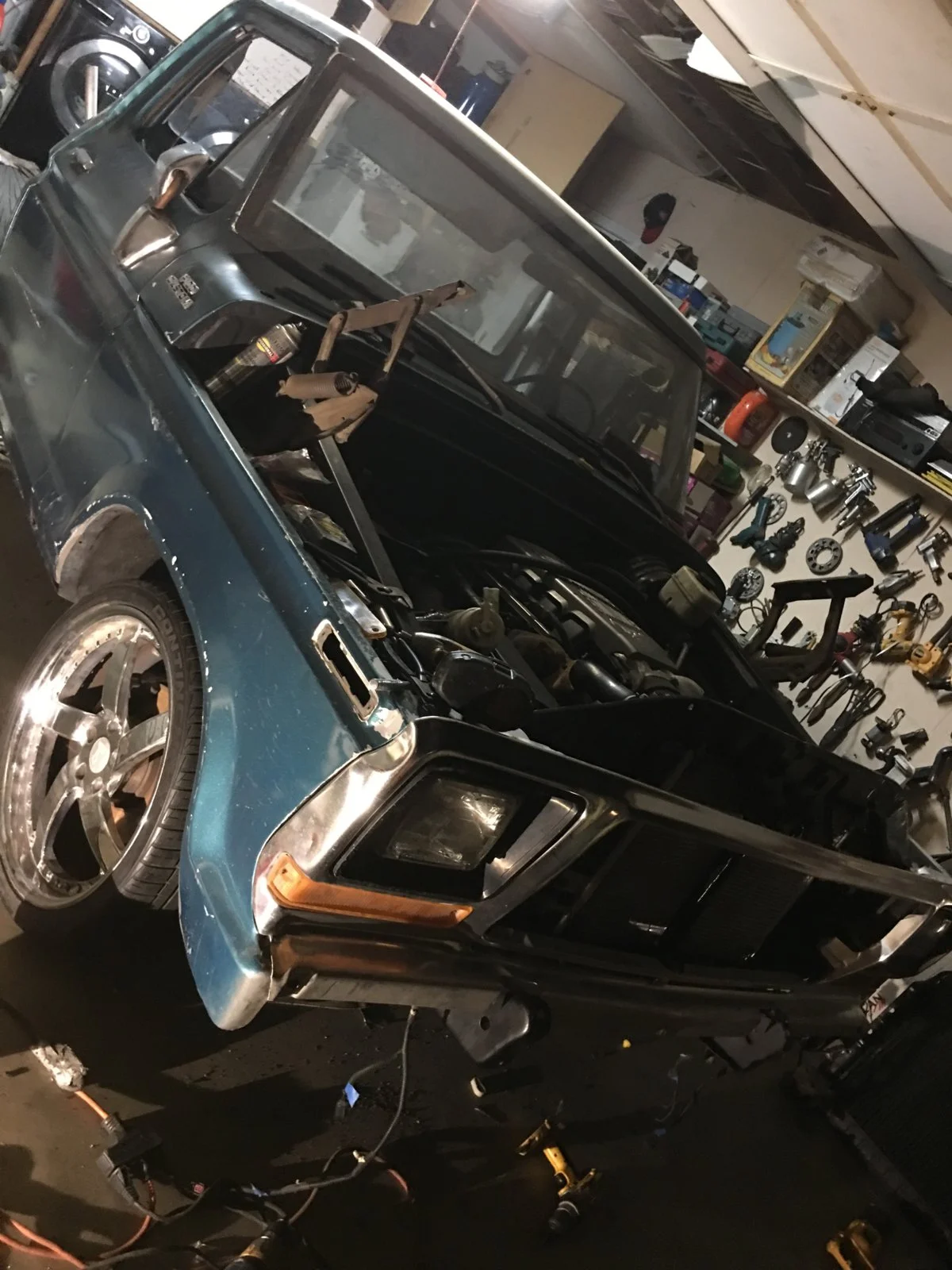

ill add some pictures so you guys can get an idea of the project
