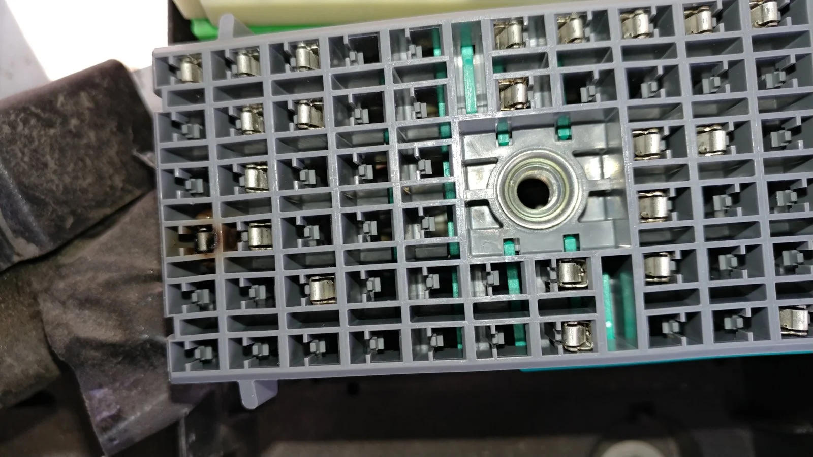

The high speed fan mode should kick in at 228*F so it seems that it's working as it should. However the low speed fan mode should kick in at 216*F and that isn't happening. If the low speed fan relay is OK, the BEC to which it attaches may be burnt out.

The BEC is the fuse box, correct? How do I check it? It's not the top part of it, because that looked fine.
If the BEC is fine, should I just get a new fan? I was reading that some other S197 owners had an electrical issue to where that had to bypass and hardwire straight to the fan.

Here is the problem (I hope). Ford claims they are discontinued and cannot get them. Any idea where I can get the fuse block?

So the blown fuse terminal was certainly the issue. I cleaned it up and tried to raise the terminal tab as most as possible. So far, so good. I feel like it could disconnect at any moment again. Any advice on a permanent repair for this? I tried to buy the block itself, but I need to buy the whole fuse box. The ones offered on eBay are unclear as to whether or not the blocks are included with the fuse box. The fuse block itself is almost impossible to find.
